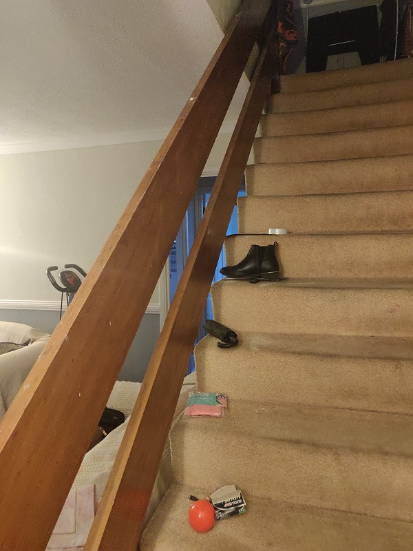

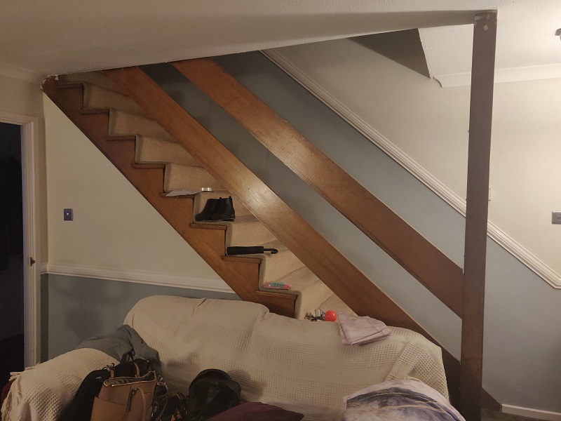

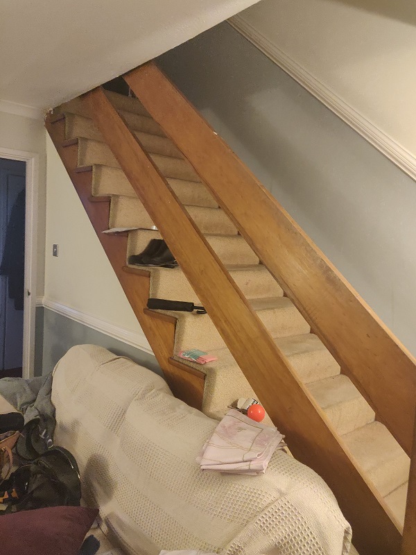

We are going to paint the stairs and Bannister white. The key is that it looks very clean, modern, fresh as we are hoping to sell at some point in the next few months.
I saw somewhere on here a while back someone mention specific paint for this type of job but can't find the name of it now.
Can you recommend how to approach this job, exactly how you would prepare and paint it and also which paint products to use?
(Ignore the mess and clutter!)

It basically needs sanding down and then painting with a good wood paint. Did you have a finish in mind, gloss or satin for example?
I have just done my skirting with Leyland Trade Acrylic Primer Undercoat Paint White (Toolstation) and then Johnstones Aqua Satin Brilliant White (Johnstones Paint Centre) over the top. Looks very white and clean.
Personally I would stay away from gloss as it is oil based and will yellow over time.
Any major damage you're trying to hide? None visible in the pics...a good clean & polish would get my vote. Replacing the carpet would be a much easier refresher, along with repainting the walls.
If you do go white paint, you'll end up having to repaint all the other woodwork to match
Hey, I looked it up and probably satin which seems to fulfil our plan of making it light and clean
No major damage. Some tiny holes where a screw or nail has been.
Not sure what you mean by other wood? You mean the dado rail and skirting? These are already white and should match enough shouldn't they?
Our plan is to paint all the brown wood white, the end of the staircase that you can see, the bannister and the vertical wooden support at the bottom
If the existing white paint has been on for a few years you'll notice the difference....
