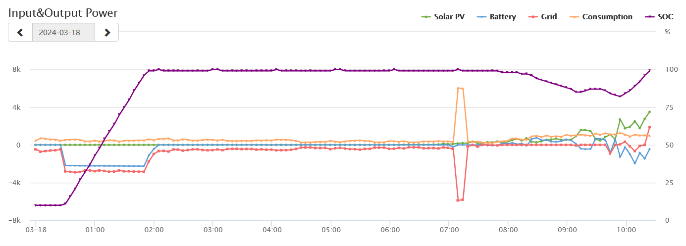

Today one needs to have a battery with solar to be able to use feed in, and the battery means you can use the solar for an extended time, mine allows me at the moment to go until around 9 pm before I am using power from grid. By also having an EV users tariff (I don't have an EV) it means from midnight to 8 am I have a reduced cost tariff, 31.31p day rate, 8.95p night rate, 59.14p standing charge and I clearly have to have a smart meter, so solar software is set to charge battery from grid from 0:30 to 7:30 so I start the day with a full battery, this time of year there is a dip 1710757677799.png in the morning where the battery state of charge (SOC) drops, but this means I can run tumble drier, washing machine etc. early enough to ensure cycle completed before the point when sun is likely to reduce, so extending the time before the battery runs out.

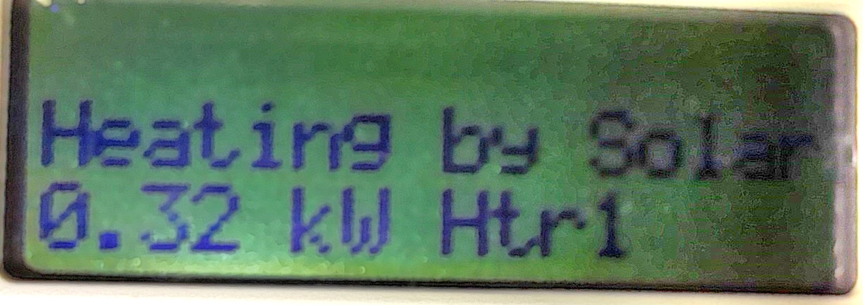

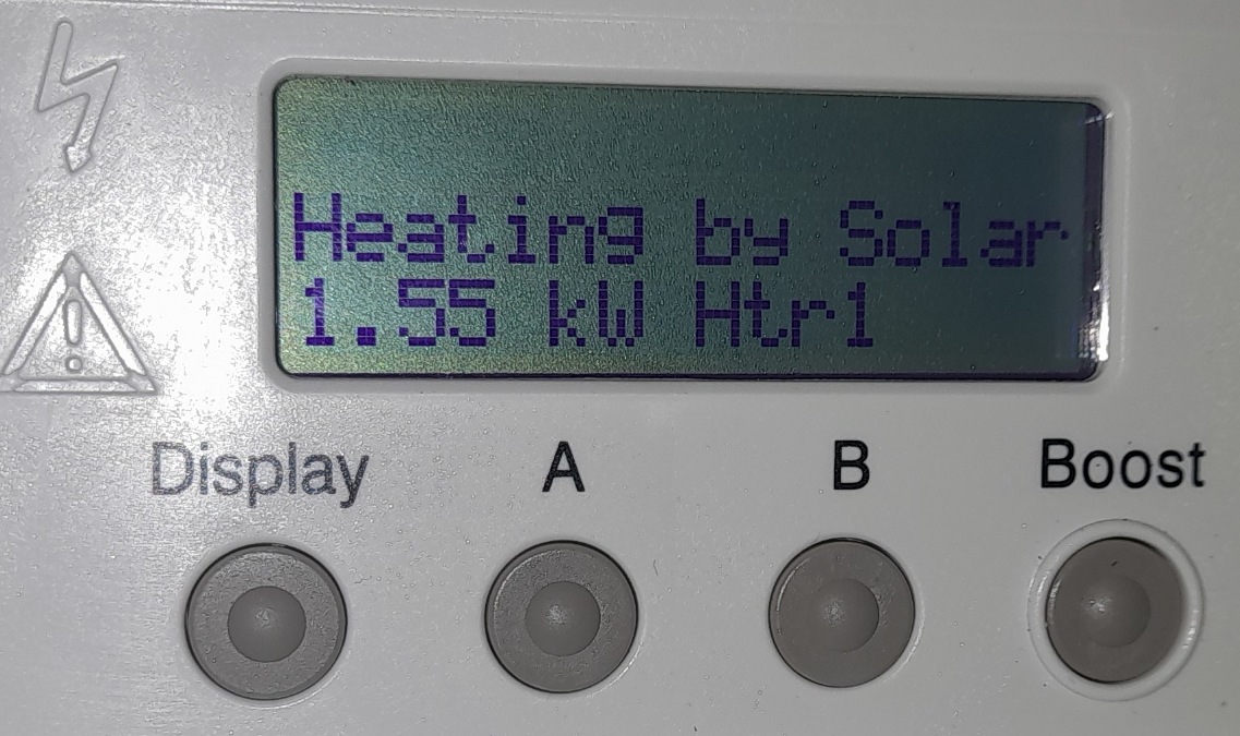

With this in mind, it is likely a simple time switch would be enough to use immersion at a point in the day when likely there is solar and battery available. The point with the iboost+ is it does not use zero or 3 kW but can use just what is surplus. So here 1710759270239.png it is showing just 1.55 kW being used, and here Friday 15-09-2023 10-50 Morning can hear iboost photo of_tonemapped.jpg just 320 watt, where as the timer is simply on/off. The unit before needing batteries was essential, but does depend on battery fitted.

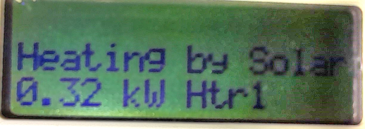

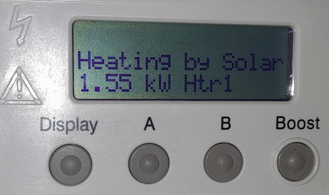

With this in mind, it is likely a simple time switch would be enough to use immersion at a point in the day when likely there is solar and battery available. The point with the iboost+ is it does not use zero or 3 kW but can use just what is surplus. So here View attachment 337054 it is showing just 1.55 kW being used, and here View attachment 337055 just 320 watt, where as the timer is simply on/off. The unit before needing batteries was essential, but does depend on battery fitted.
