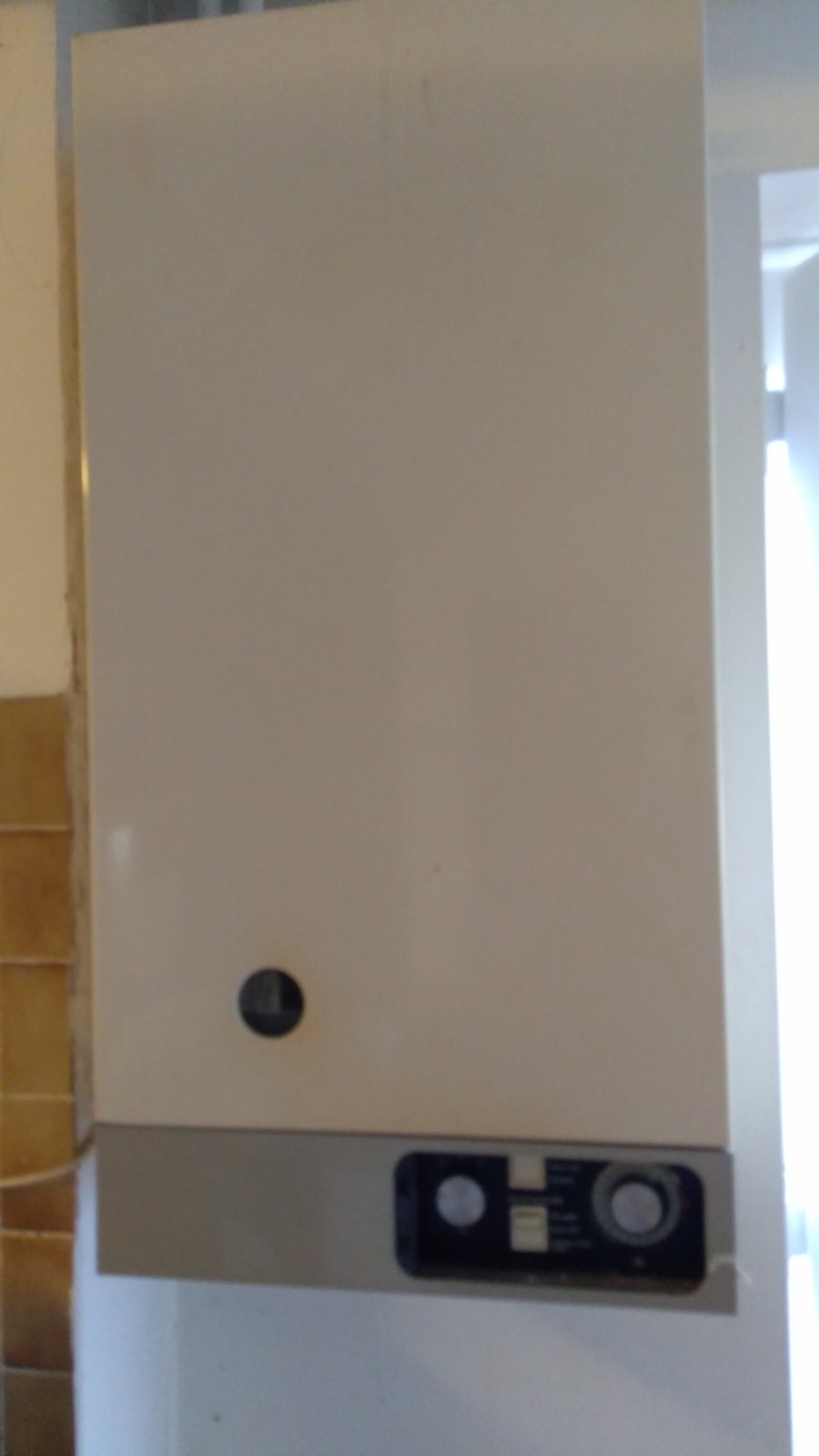

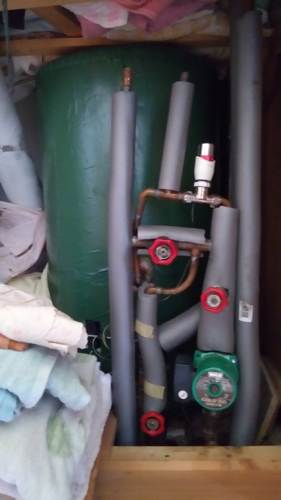

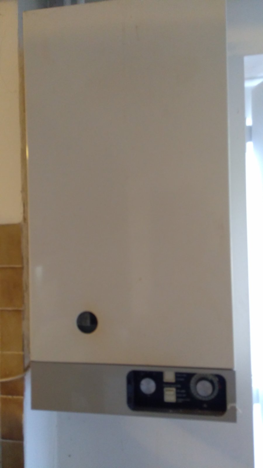

Could anyone tell me what type of system I have? Pics attached
The boiler downstairs which looks very old, has two incoming pipes going into it from the top and one pipe underneath the boiler
Upstairs their is a cylinder tank
Looking to replace the boiler if i do will i also need to replace the cylinder?
Do i stick with the current system I have? Or is there a better system available?
4 bedroom house, approx 15 radiators, 1 bath and 1 separate shower

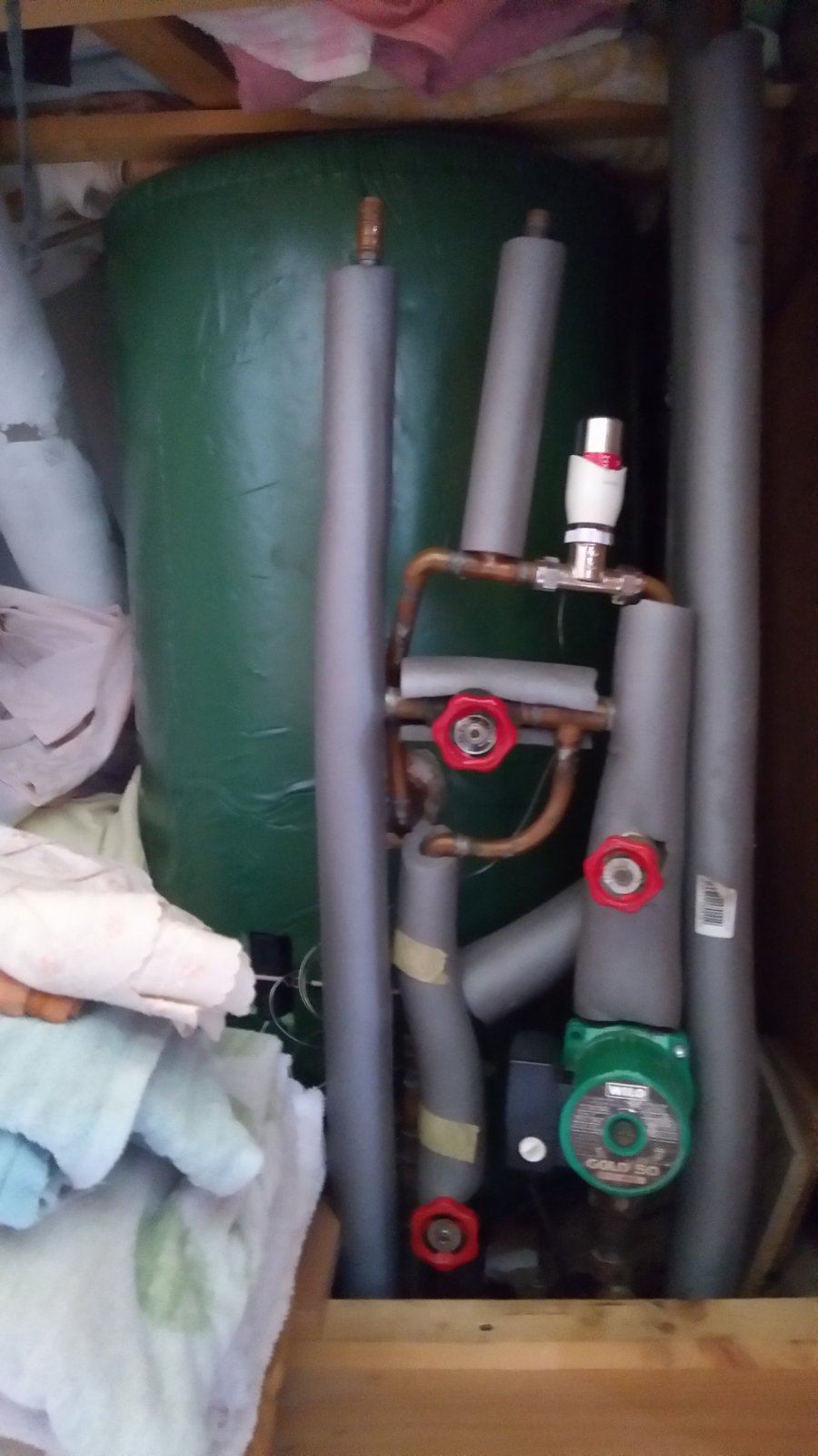

you have a fully pumped system but not Y plan or S plan, you have a botched mechanical thermostat for the HW, bit of a mess really get some quotes to replace, you need a new boiler a new Cylinder and upgraded controls, you could possibly get away with just replacing the lot with a decent combi but that can only be decided on site

Where is the mechanical thermostat located?
What's can you see wrong with the cylinder?
I'm familiar with combi's,will it take a lot of rework to convert to a combi?

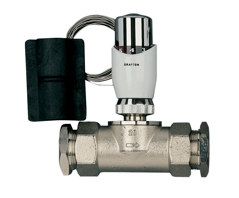

The valve in your second pic that looks like a Thermostatic radiator valve , you do get TRVs like this for towel radiators, you also get mechanical stats for HW cylinders that have a seperate probe that is attached to the HW cylinder to close the valve, sometimes called a RAVI stat, never seen one like the one you have that is suitable for a HW cyl control but that doesnt mean that you dont get them, would be very surprised though if you did
Yep it is a trv, is this an old type of cylinder?

They do 2 and 3 port mate.
https://www.directheatingsupplies.co.uk/drayton-tap-thermostat-3-way-with-so-sensor-15mm-07-45-016
Does that mean what's been fitted to the cylinder is ok?

Doesn’t comply with anything nowadays and wastes a lot of fuel.

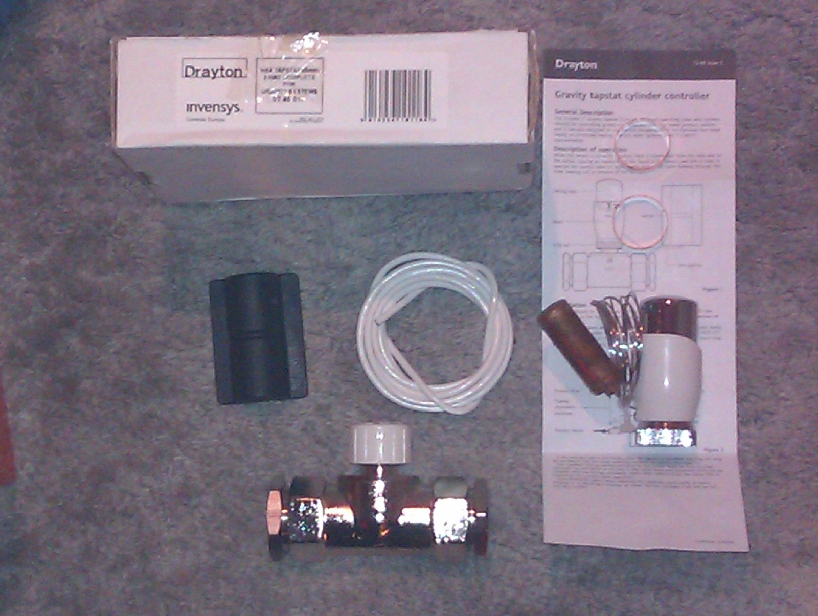

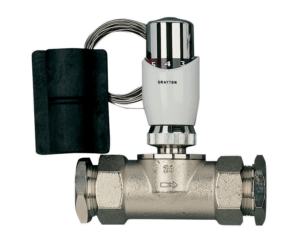

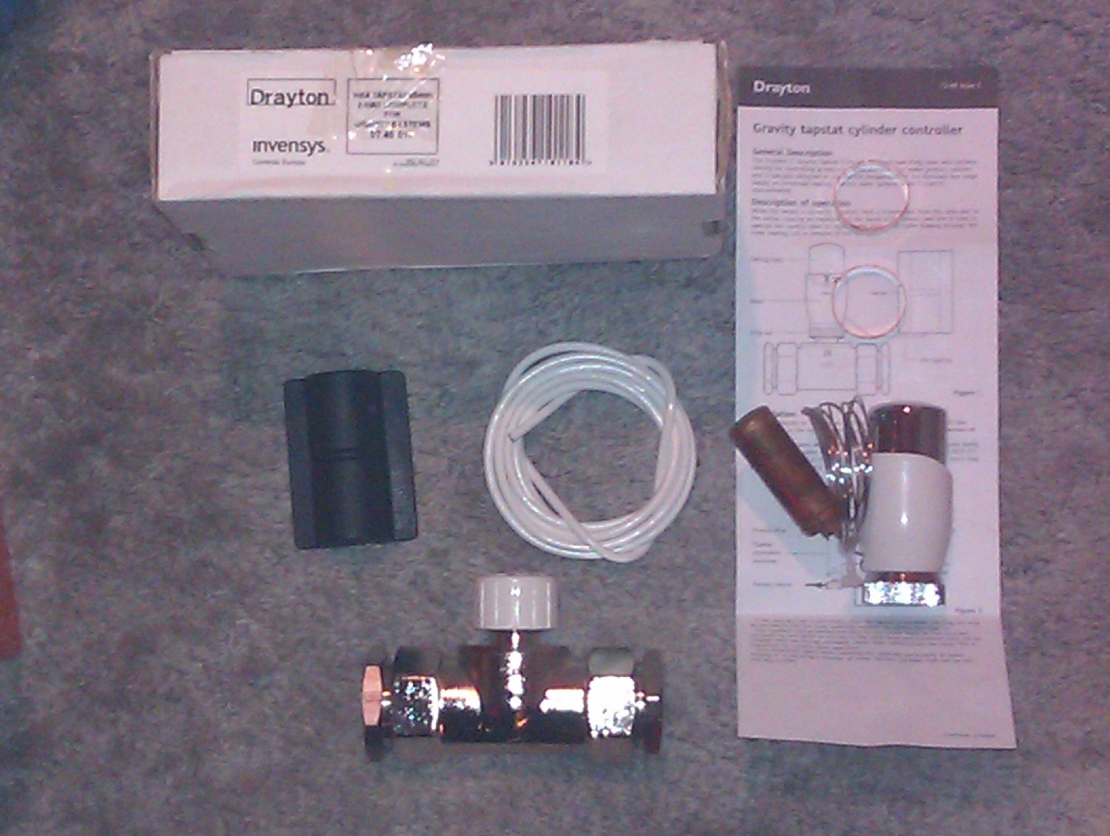

it appears to have a what looks like a thin wire coming from it and going to the cylinder. This is the sender. If so, it's a cylinder stat. A Drayton Tapstat. When it gets the cylinder is hot enough it closes the valve and prevents the boiler heating the cylinder more.
I used to have one on a Gravity feed cylinder, better than nothing but not very suitable in your circumstances, you will be wasting gas especially in summer. I sold my spare one for about £80 on ebay, so there are still people who use them. You could have your existing cylinder re-piped and a thermostat and motorised valve fitted to it with new wiring.
View attachment 166811 View attachment 166812
So should i upgrade the cylinder as you suggested or would it be better to rip the lot out and get a combi fitted instead?
I am not a gasman.
Doing the cylinder properly would cut your gas bills at once, and would be cheaper than buying a new boiler. By upgrading the controls you should be able to make you house more comfortable as well as saving energy. Perhaps you don't have a room stat and some of your radiators come on whenever you want to heat the cylinder. That should also be fixed. Perhaps you don't have a timer.
If it is not convenient to buy a new boiler straight away I would get the cylinder done while you get the money together or make up your mind.
Sooner or later your boiler will break down and not be worth repairing, and you can't delay any longer. But I see your cylinder has an immersion heater you can use for hot water if the boiler is out of action so it will not be a catastrophe.
