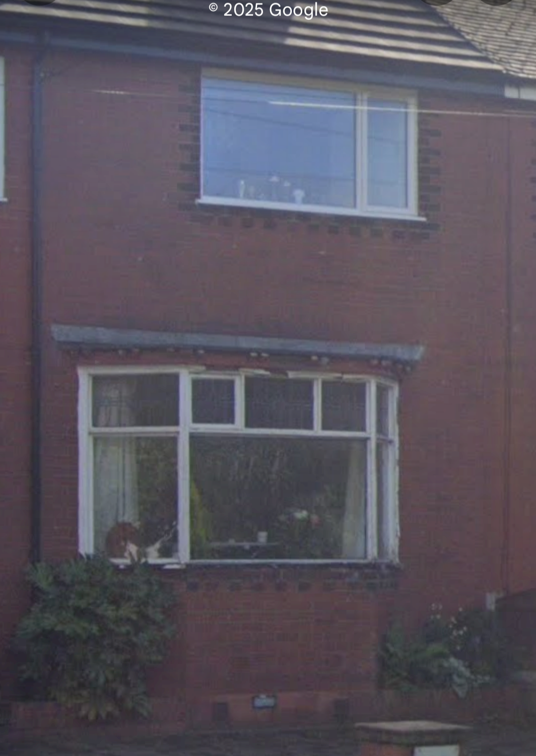

I'd be very reluctant to fit used, but I've fitted loads of miss-measured/new unused windows and doors. Most have still had the stickers on the units for BCO to take little interest in, although as above I hope he will be checking the bi-folds for safety glass.
Best one I got was a brand new, fully glazed miss-measured (they forgot the structural bay poles), 3 sided bay which will replace this rotten old timber one - 99p on eBay.
