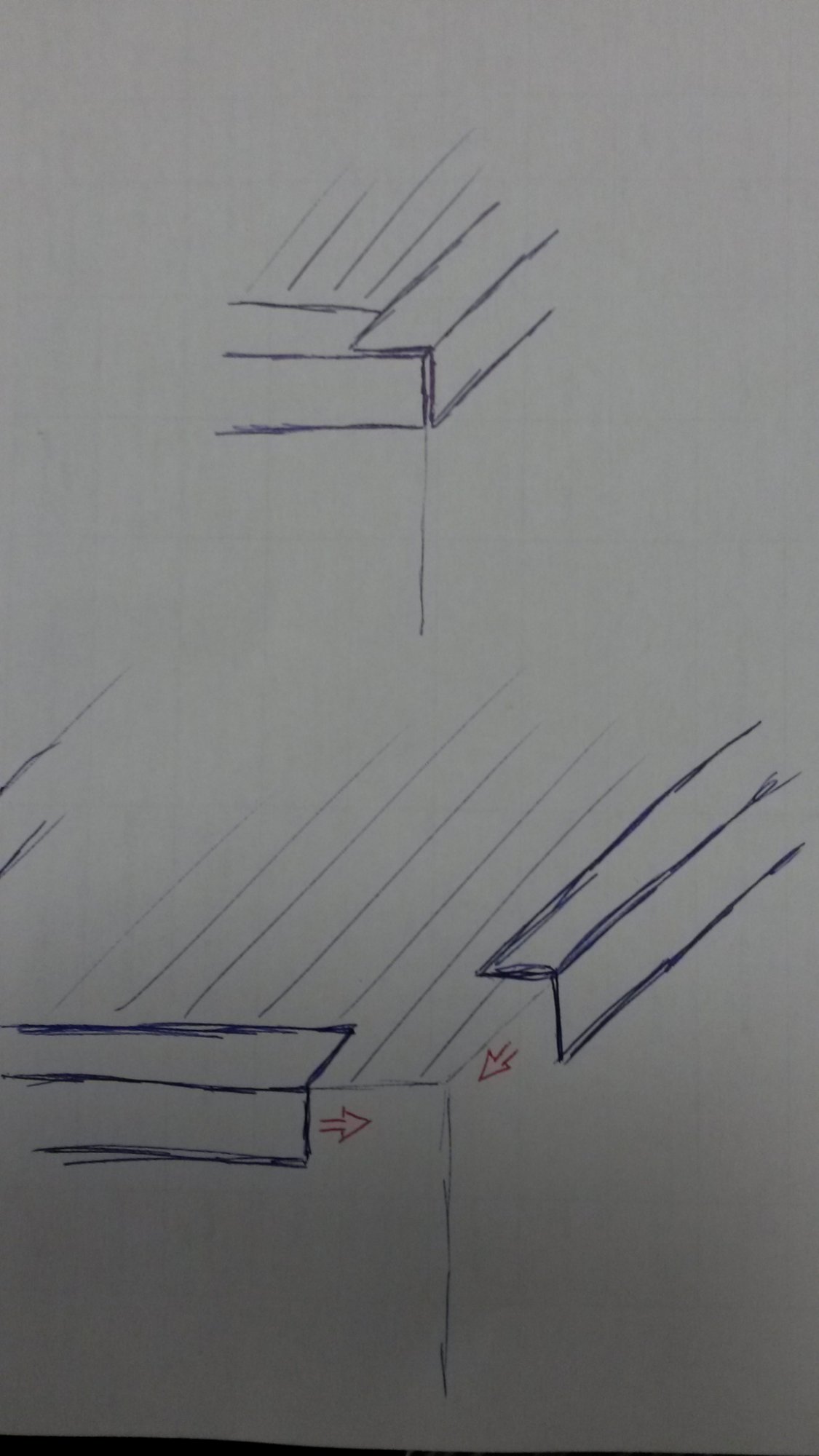

what to use at barge board corners
Unfortunately I haven't yet installed them so can't take any pics. I've drawn the below image to hopefully explain what I mean. Where the 2 overlap, there will be that slit down the wall where there is no protection and water could get in. I could silicon them but I thought that this would be a common thing and there would be some type of solution already.
Also, I'm not actually sure on which should overlap (sides or ridge). Is there a preferred method?
Thanks for any help.
so this is a flat roof? and those pieces of timber you have drawn arrows on are fascias?
not sure what those angle-iron shaped pieces of trim are but can you get a 'corner piece' ?
Isn't a "corner piece" just a short length of the regular stuff in your link/sketch but trimmed down to size? It's got a corner already!
