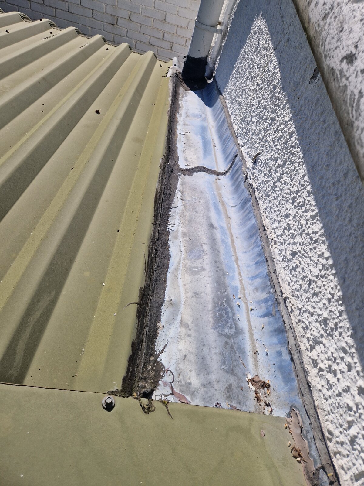

What to use on the silver bit to prevent leaks

Probably rip it out and redo it.
What's the dark line top right of the picture? Looks like a break in the render?
I would rip it all out and redo...then, if done right, you can forget about it for a very long time!
The issue with any job like yours is that the flashing can be 99% ok and one little mistake can mean water ingress. And that could be anywhere along the run and not necessarily where it enters the building. I've also seen instances where the whole flashing thing has been correctly installed, but bypassed by say a poorly sealed window or poor rendering etc above.
