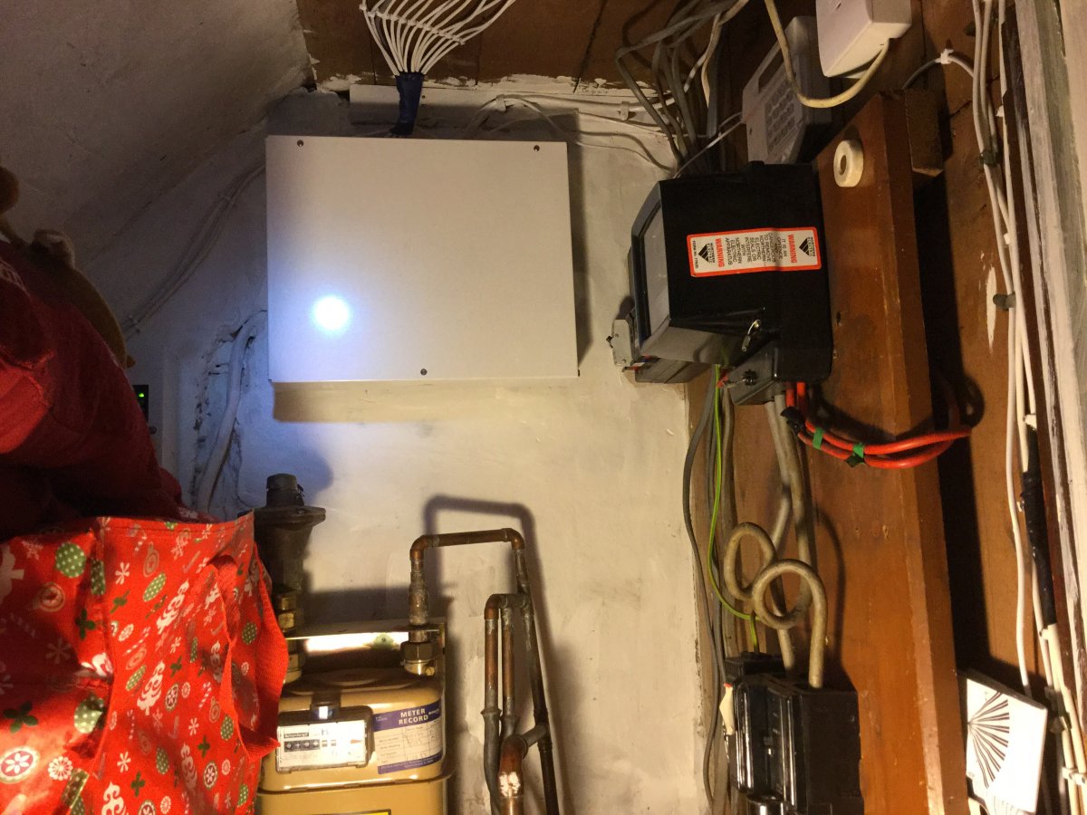

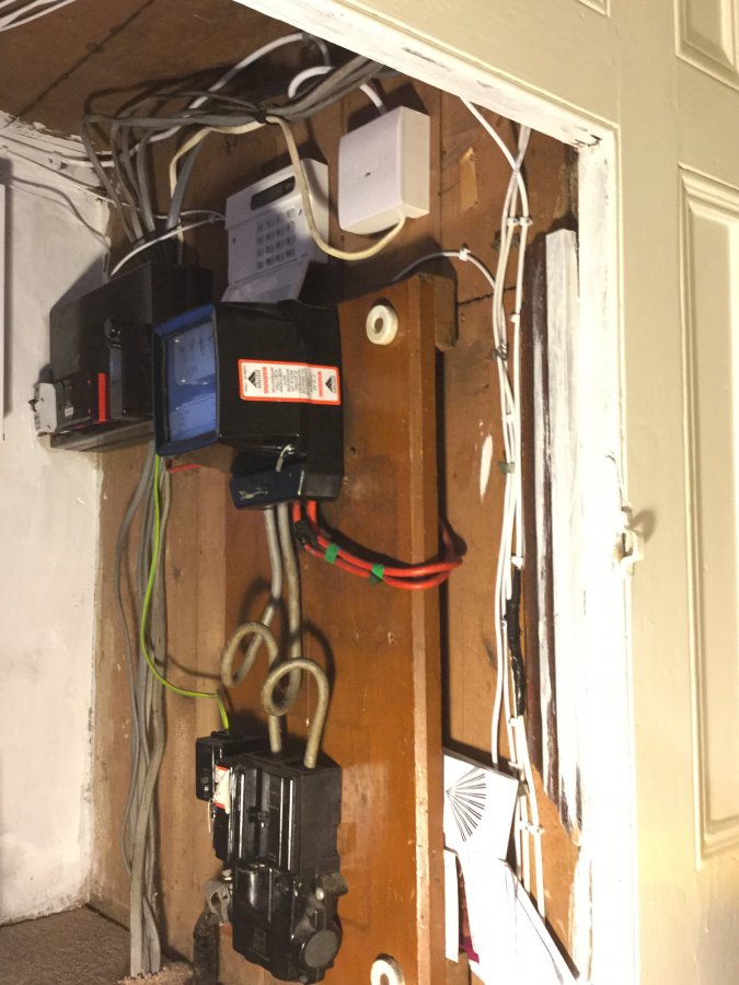

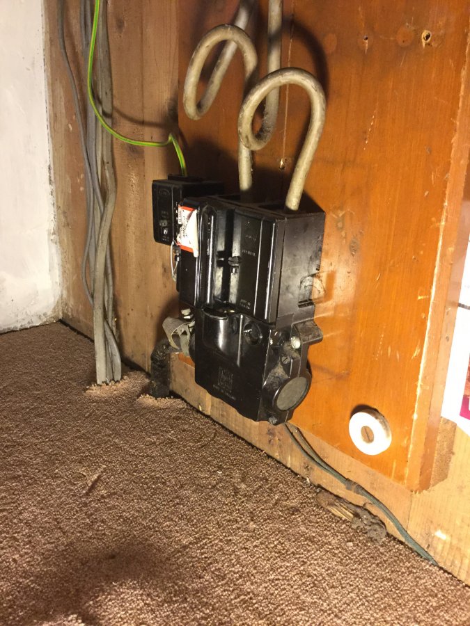

Hi guys,
I've moved into a new house and I was wondering what type of supply I have such as tt, tns ago if anyone could tell me I would really appreciate it
The picture are not conclusive, it looks like you have an earth clamp on the incoming supply cable, then connected to an earth conductor that enters the joint box where the other earth conductor looks to exit?
If so I would say TN-S.

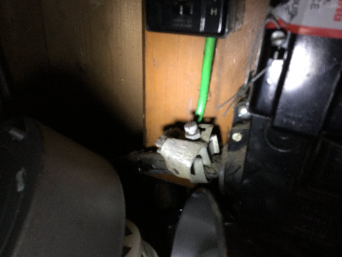

I just was curious and there is an earth wire coming out of the second little box that looks to be connected to the clamp
Ah - that couldn't be seen before.
Nor could the air gap between the connector block and the cutout which means that it's not derived from the supply neutral.
For your own peace of mind you should ask the DNO to come and check that the clamp is OK, and that you are supposed to have it, and a TN-S supply.

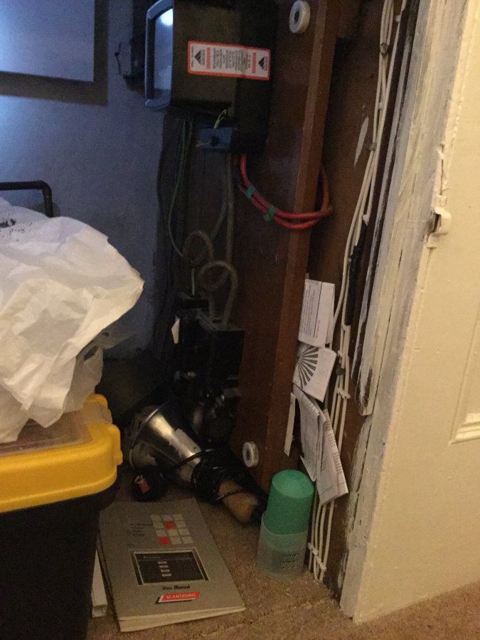

Old cable pre 1970's with a plastic 60A cut-out so it has possibly been changed at some point
Also does anyone know approximately how old the installation looks?
Difficult to say in regards of the supply arrangement, looks mid to late 60s, how old is the property?
The installation on the consumers side has the old wylex box, so again likely be dipping into the 60s. With regards to the circuits from that point, I would expect there was been some type of alteration since the original install, so would be hard to say without having a full visual of it.
