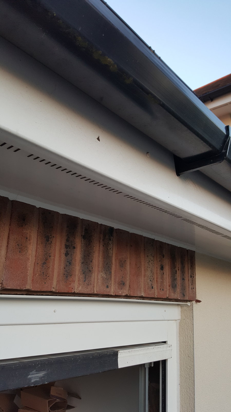

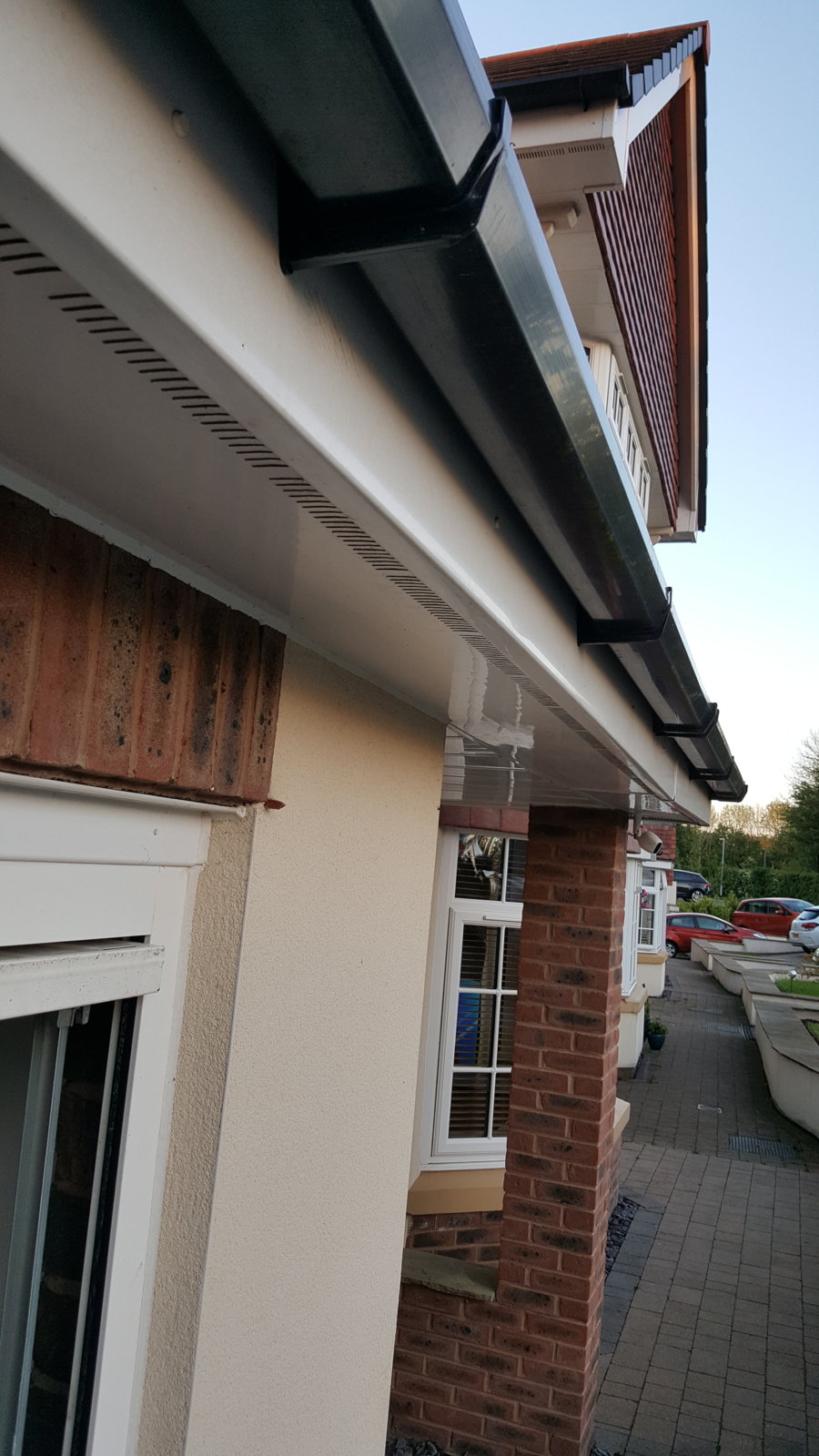

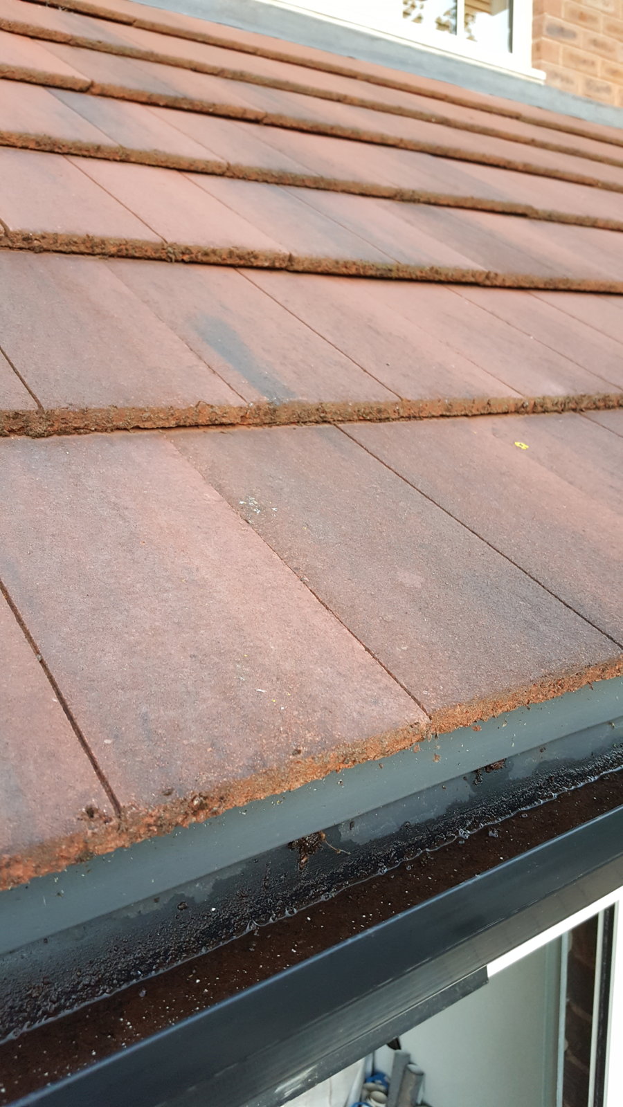

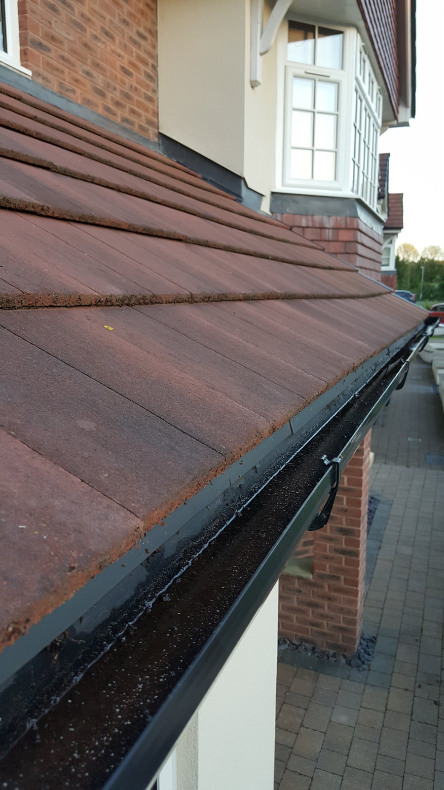

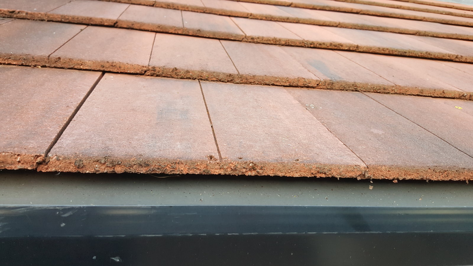

Hi all. First post.
I am looking to run cable in the upvc above my garage door. The only way i can get in is by lifting tiles on the roof above.
I've had a quick look and i can't really budge them. I am assuming as is usually the case. The first/bottom row is nailed then every third row will be nailed.
I had a go and shoving the 2nd row up with the butt of my hammer but they didn't really move.
I can get under and try to lift them, but obviously it's heavy going as they are all linked and they all want to move together.
Thanks!

Looks like doubles ( two tiles in one)on my roofs every tile is nailed ,easier to just stick a white cable conduit below for cables.
Maybe Marley Ashmore or Redland Duo Plain tiles (there are a couple of others but listed the most common)
All should be nailed and clipped depending on location.
First course may well be clipped at the bottom edge.

You could cut you holes for the lights then you have access to fish cables without lifting any tiles .
if the tiles are clipped then a pry bar wont help. it will just break the channels off.
best bet is to fish the able as suggested
That looks like a new build to me and I would be surprised if all of those tiles are clipped at that low level.
Just been up there with my shiny new pry bar. The first row each tile has 1 nail in and the 2nd row has no nails. Juat hanging off the batton. Very snug and heavy to lift but i think i should be ok.
I don't need to lift loads. Just certain ones
