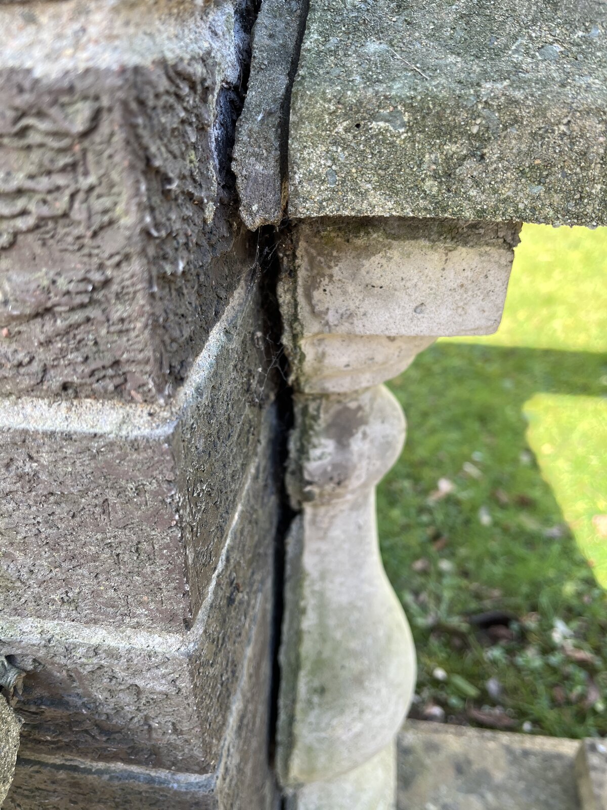

What will I fill this with?
4 Aug 2019
174
6
HI, I want to gun something into that gap and also strength the the wee balustrade up against the pillar.
Any ideas?
Thanks.
This resin will do a good job of fixing it and squirt plenty in but don't fill it as you can then point it up once it has set with a bit of mortar to match closer to the brickwork....
But note whichever one is moving (the wall presumably) may carry on moving ...
Dare we ask have you investigated why it's moving/is it safe?
Hi Thanks, I took out a bush that got a bit too big this morning and just noticed it. I haven't look to close at it yet, It might be the wee pillar has move a bit, after about 30 yrs
UPDATE
I had a good look at the wee pillar, I sighted them and there still inline, so looks like the motor has maybe dried up and come away.
I'll get that Rawlplug Resin tomorrow and tidy it up.
Thanks everyone.
Thank you, thats great, thanks for the tip. :)
That resin worked a treat, it's a great job, thank you.
