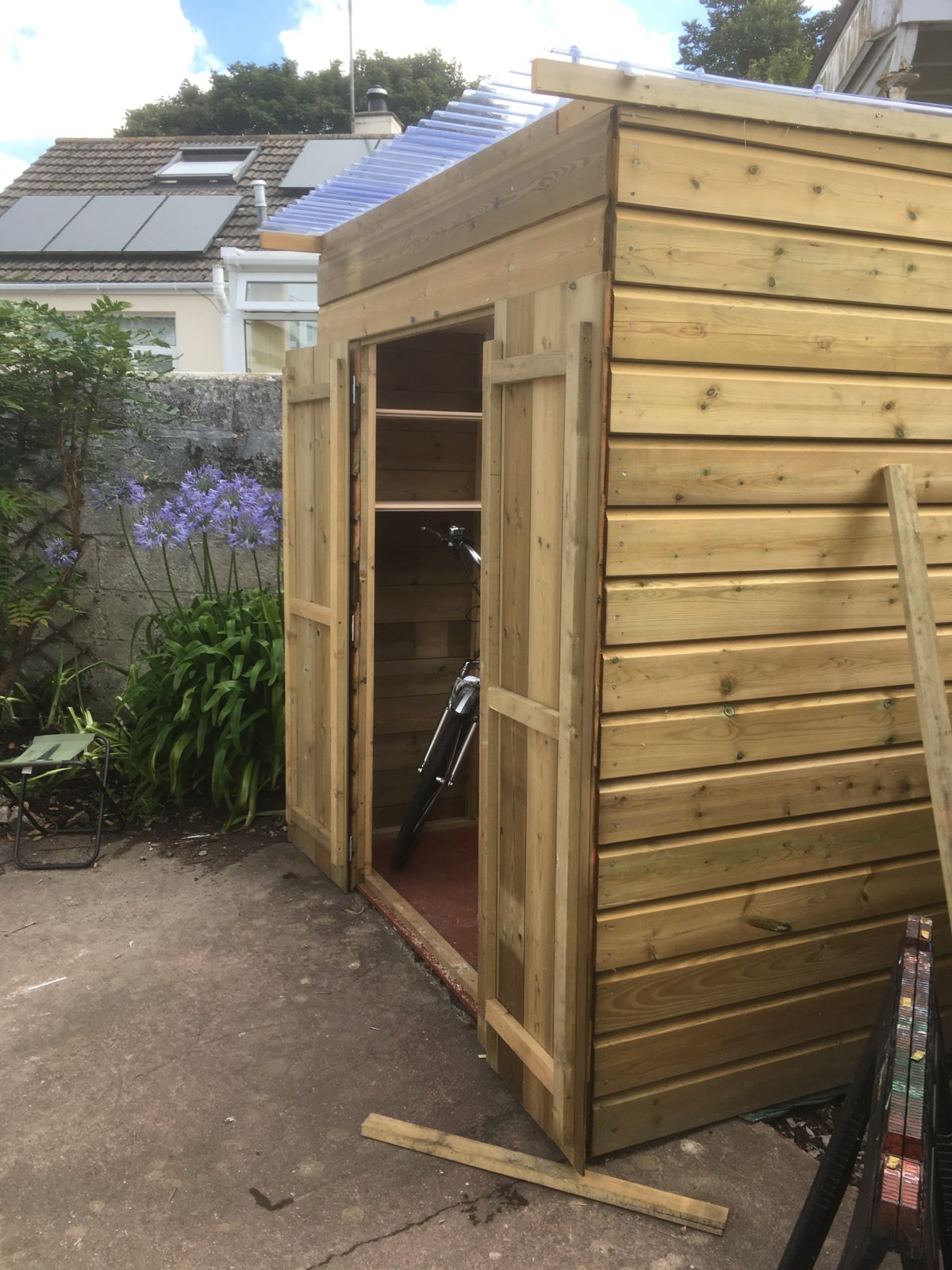

Building a shiplap shed with a Perspex sheet roof. It's 3 m. wide. What should I use to support the roof in one span?
3x2 should do it at 400mm centres . Any less and it may curl in heat from sun.
Perspex is 3 mm as far as I remember. I have already built it at 1,8m x 1.8m but now realise it's too small so removing Right side and extending it, so total should be 2.5m.(N0 more room. See pic
So it's corrugated plastic?
You'll need rafters where the sheets meet, and purlins plus a fall on the roof.
Yes, corrugated and I have 2 x 2 at about 50cm. spaces going from left to right in the picture, so at right angle to the sheets. Holds it up fine but worried about extra length.
