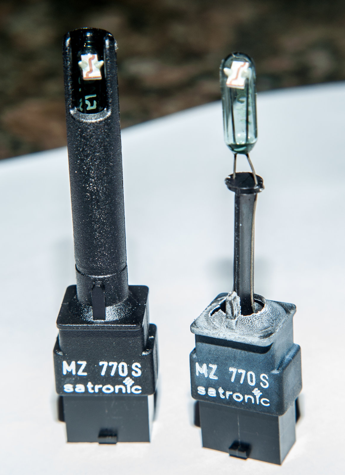

The photocell was all but disintegrated, still electrically working but unable to hold in the correct alignment or make a lightproof seal. Yes the cell is a service check / clean and was obviously not done during the service.

Here are the old and new cells, the old one was smutty before I cleaned it.
