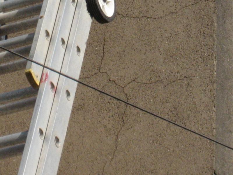

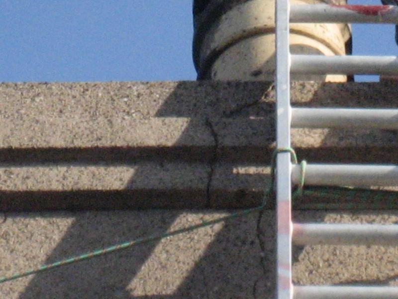

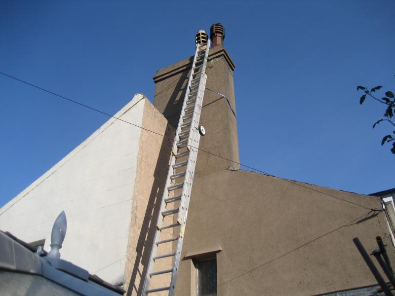

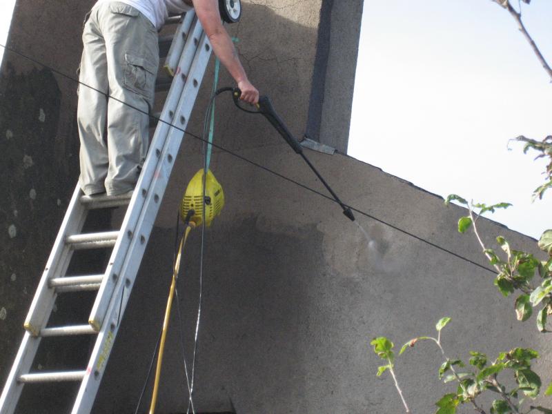

Hello group, been in new house for 6 months now, previous owner forgot to mention that when its rains heavily, the water runs down the inside of the chimney stack and drips through the extractor fan onto the cooker (fire removed by previous owner and cooker fitted in), which really ruins the spag boll you've just made. I've checked the stack and the render is cracked in many places, however it doesn't look that bad close up, after pressure washing it yesterday there were no signs of water penetration in the kitchen downstairs. The haunching around the old pots has deteriorated badly and I presume this is where the water is getting in, I'm getting the old Edwardian pots removed this week and gas cowels put on instead, but I'd like renovate the stack and try to patch it up then paint it. My question is this, what is the cheapest way of patching up the cracks in the existing render, there are upteen products stating they all do this, but they cost a small fortune, can I use a cement mix and brush it on, or do I need to use the likes of Ronseals weatherseal, a colleague of mine suggested water mixed with PVA 3 parts to 1. My ultimate goal is to make it good and paint it, any suggestions welcome.

very little water falls down a chimneypot or cracked flaunching. Look also for water running down a roof or gutter and getting through a crack.
you may see something from the loft

Thanks for the response, it's not a torrent of water, more of sustained dripping. I've ran some silicon around the pots this morning, just to put me on until the cowels are replaced.
