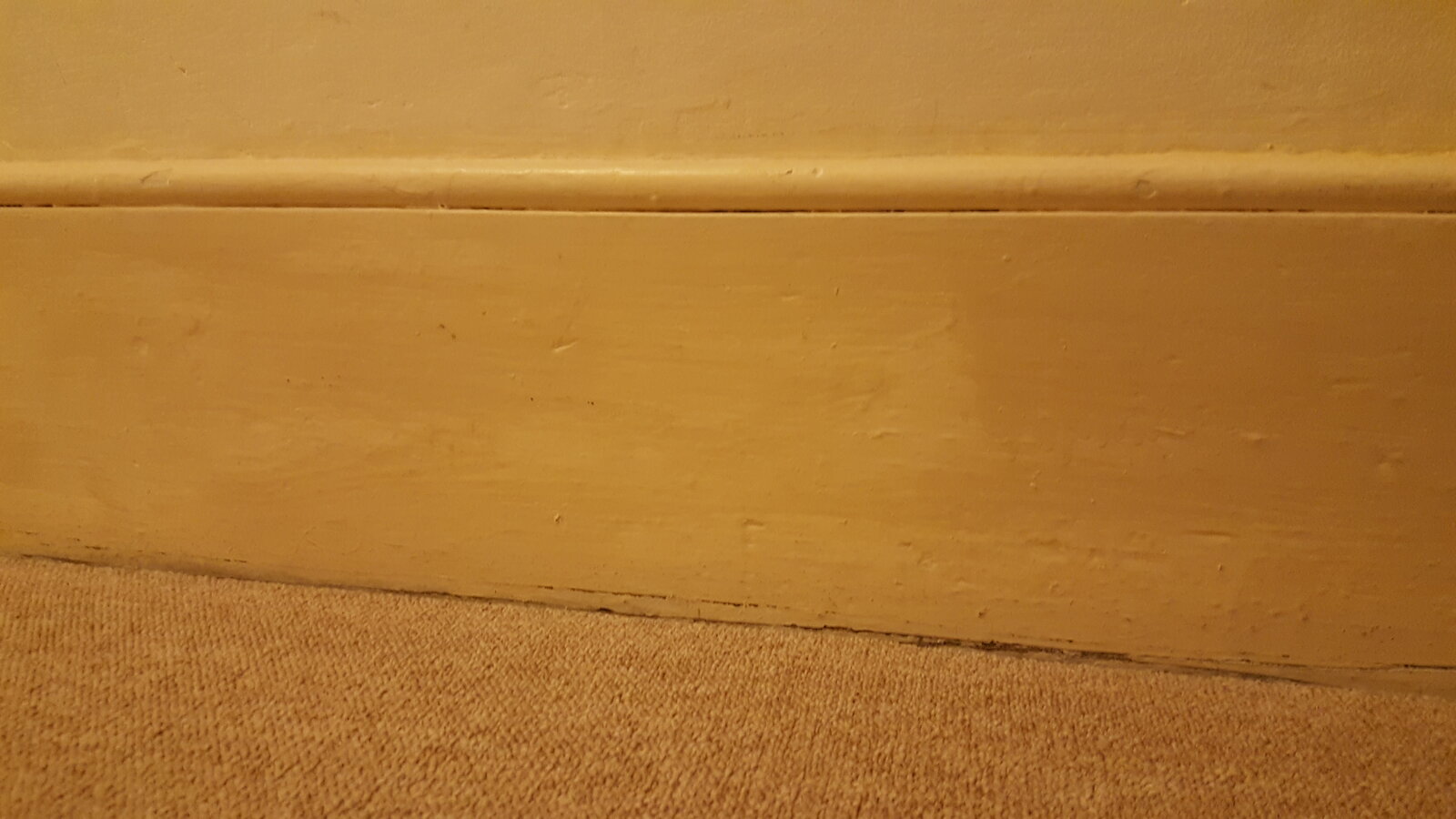

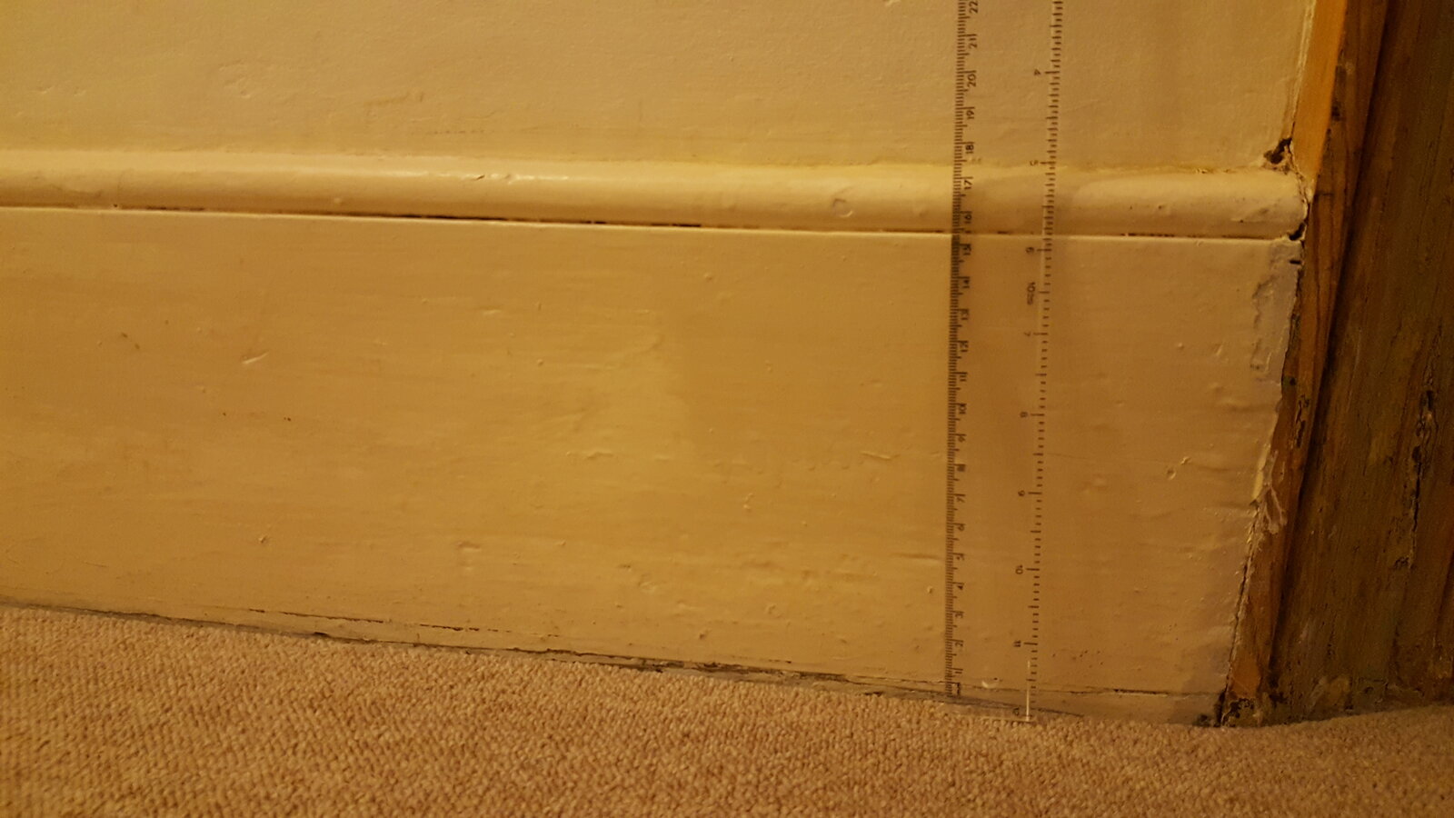

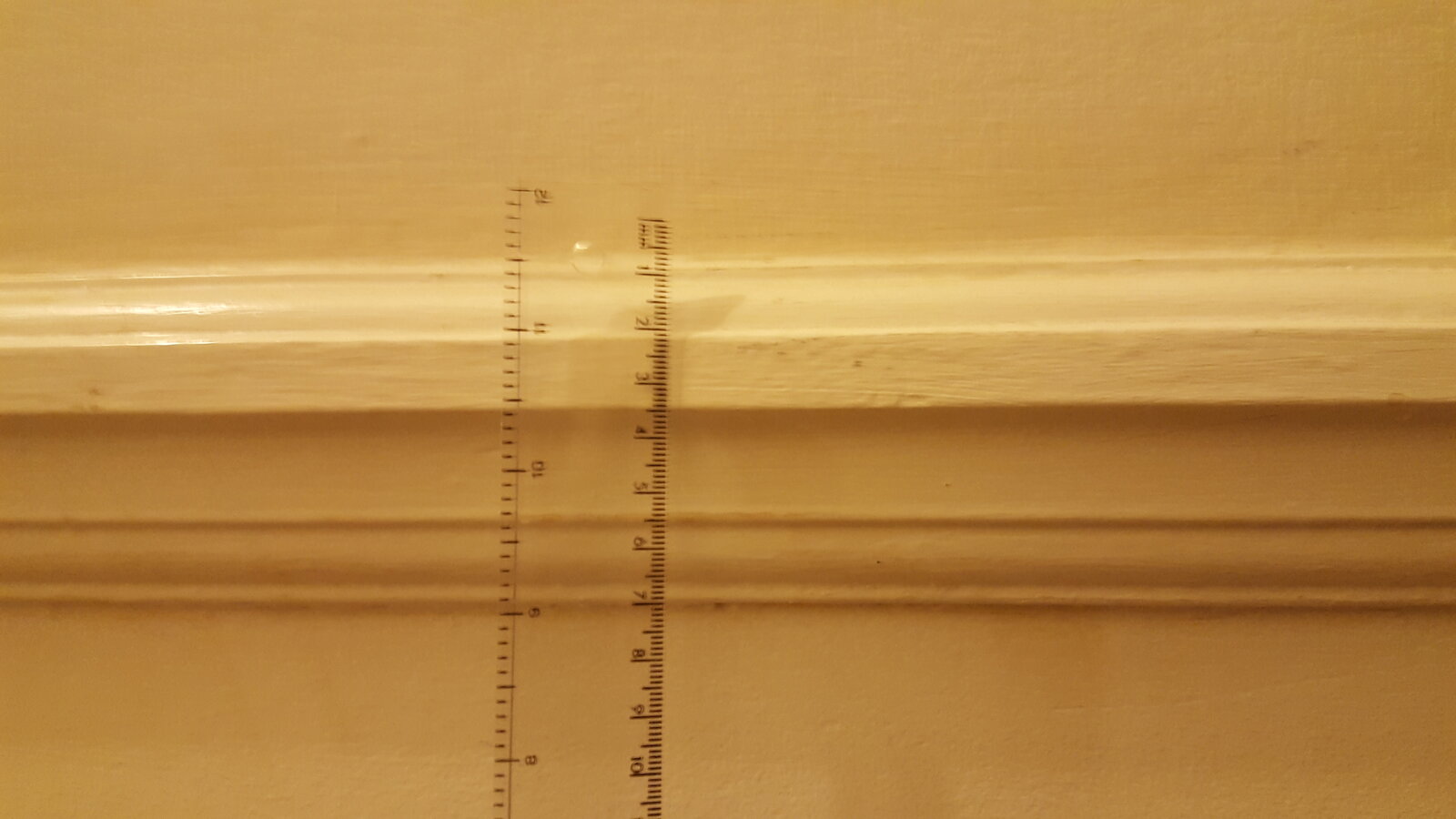

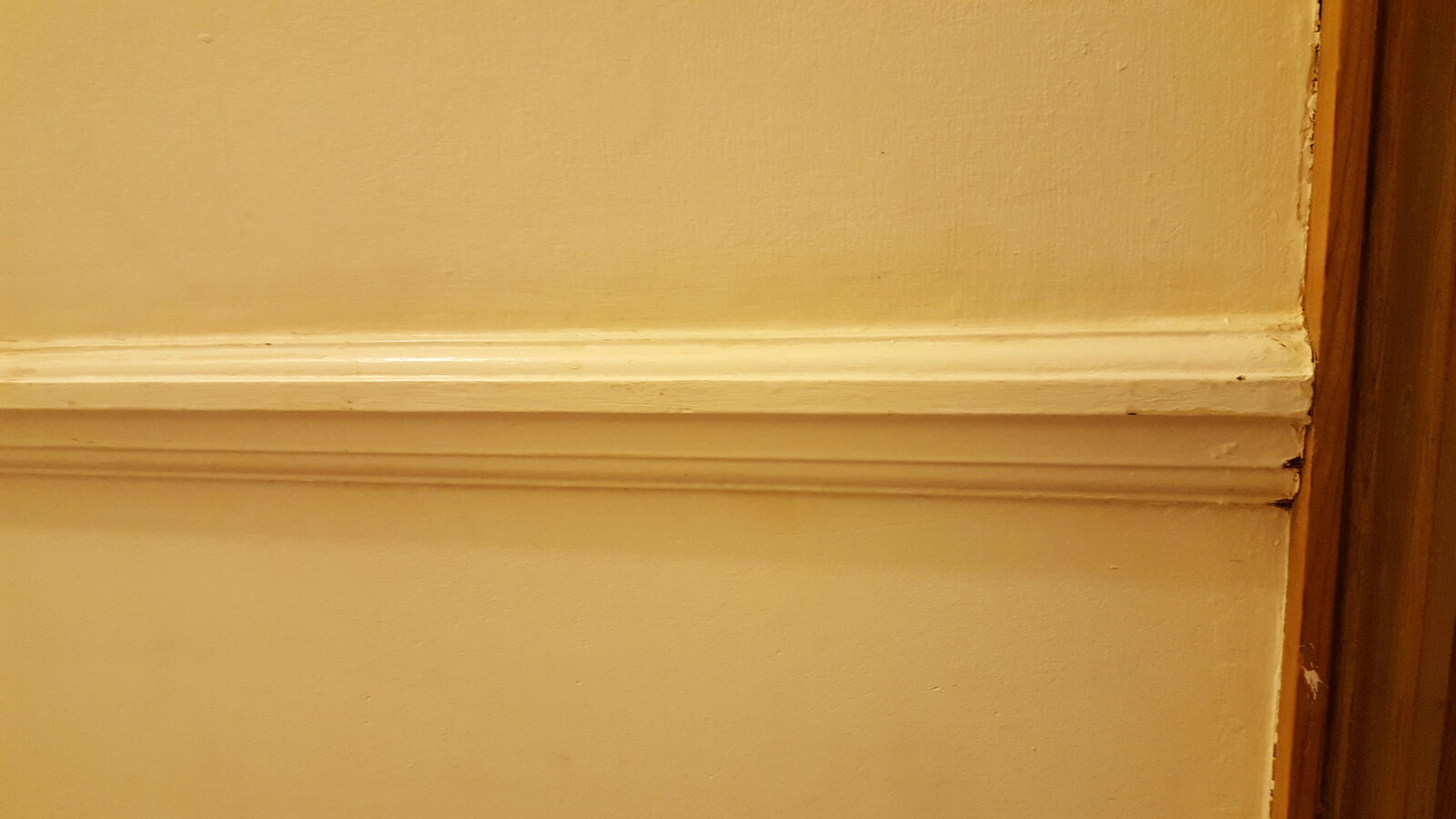

I need a section of dado rail.and skirting replaced in my house. Does anyone know the profile name of the dado rail and skirting and where I can buy a short length of 1m each?
It's a Victorian house. Dado rail is 3.5cm and skirting 17.5cm. Surely they must be common but I can't find for the life of me what the profile name is!
Photos hopefully attached and any help much appreciated.

Well the skirting is torus, various sizes available. Don't know what the dado is called
nothing ive ever seen.
dont think its torus personally.
skirting looks like a plain timber with a victorian wooden corner bead pinned to the top of it.
That or some PAR softwood and pre-made beadings - after all it's basically only two pieces of cavetto on PAR stuck together
