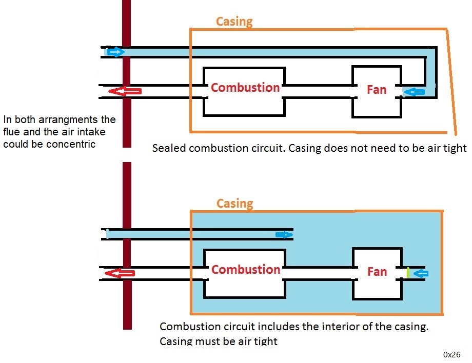

I might get a roasting for posting this. My defence is that many years ago a gas engineer pointed this out to me.

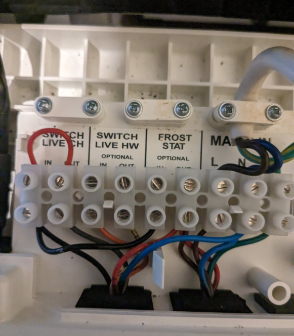

I asked mainly because yesterday a poster included a photo of the internal wiring on their Ideal Vogue. It seems clear now, that in order to do that, the combustion seal was broken. But that thread wasn't locked, and no comment was made saying it shouldn't have been done, so I'm guessing the poster is oblivious.

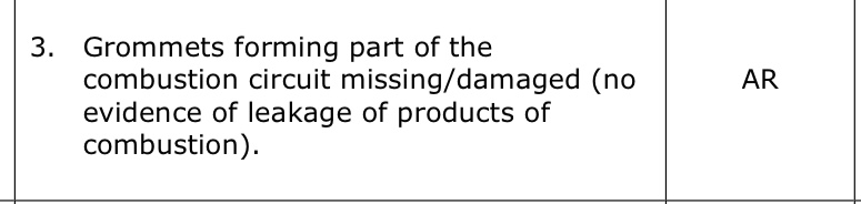

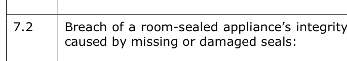

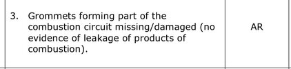

That’s good Bernard, and probably demonstrates what I have just posted, but the “competent“ engineer you refer to would not be wrong if the holes were part of the combustion circuit, see attached. AR means at risk.

Thanks, that diagram was extremely helpful in understanding the regulation. A picture paints a thousand words!
