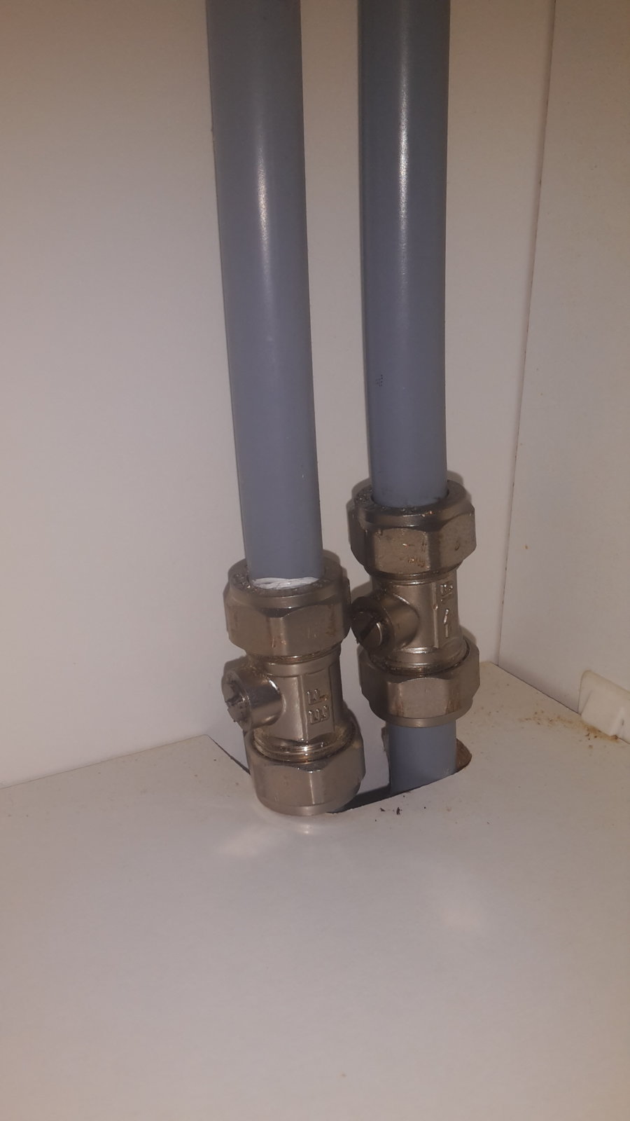

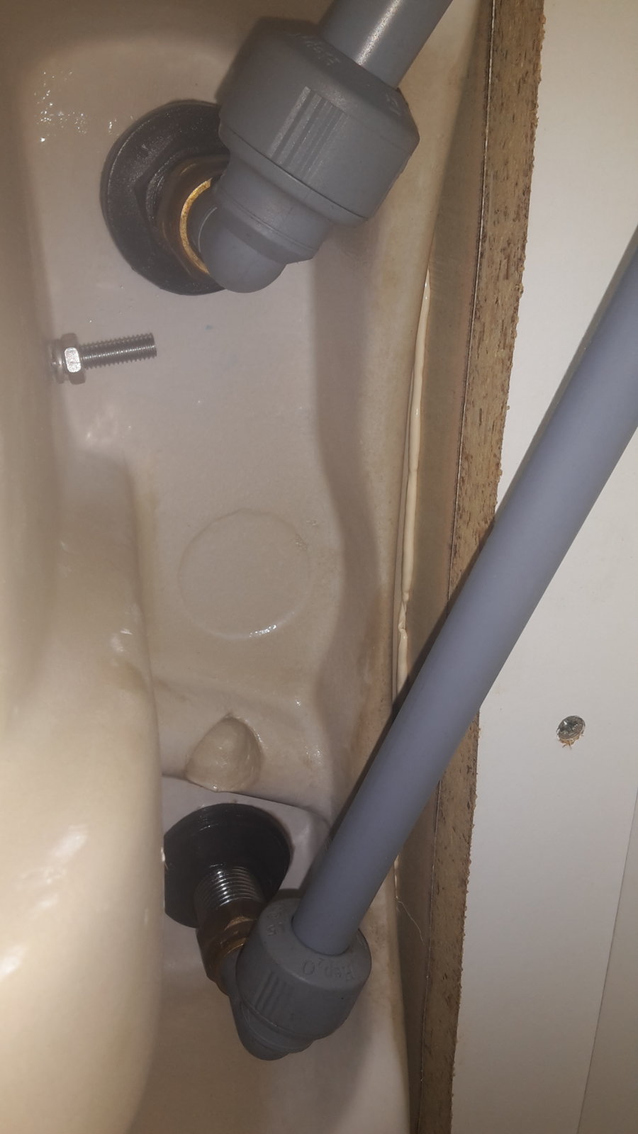

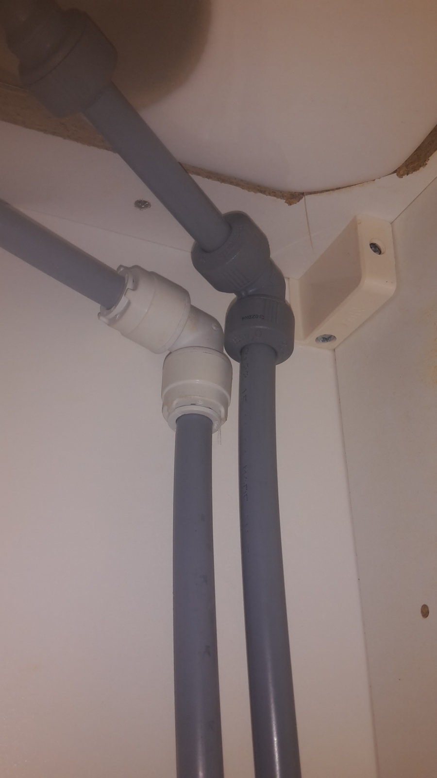

Here are a few photos of the tap plumbing. There are isolation valves which is a good start. To remove the tap, is it simply a case of undoing the brass/bronze nut on the threaded boss coming out of the bottom of the tap? Does this nut rotate independent of the rest of the pipework, i.e. can I isolate the supply, undo the brass/bronze nut on the threaded part of the tap, remove the black plastic nut, and remove the tap? Is it that simple? No messing with the plastic pipework?
Yes , you have pretty much got it !! But you will need a special basin spanner to reach those awkward nuts
