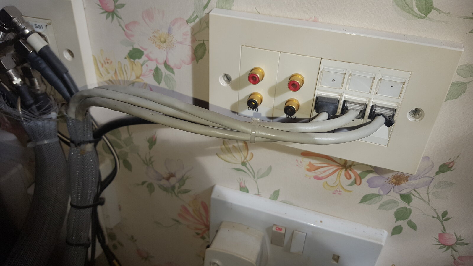

three in use behind the tv etc and two for an access point and a roku internet radio device
these are the three behind the tv alone for sky box. tv and freesat box.
so you may want to rethink your plans. I know you could put seperate switches in areas requiring more than one connection but as you will be pulling in one cable it is no real extra work to do more at the same time
