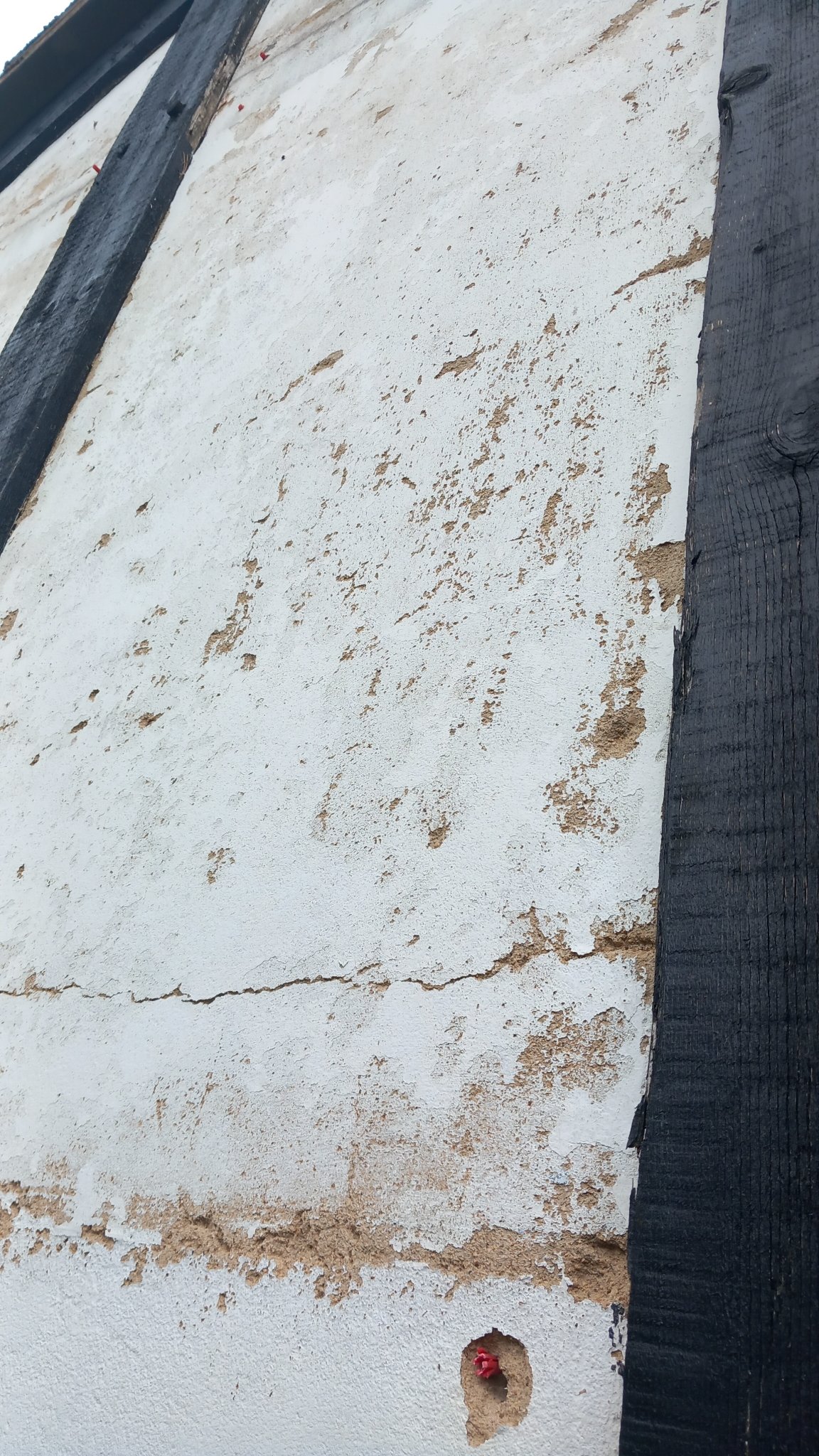

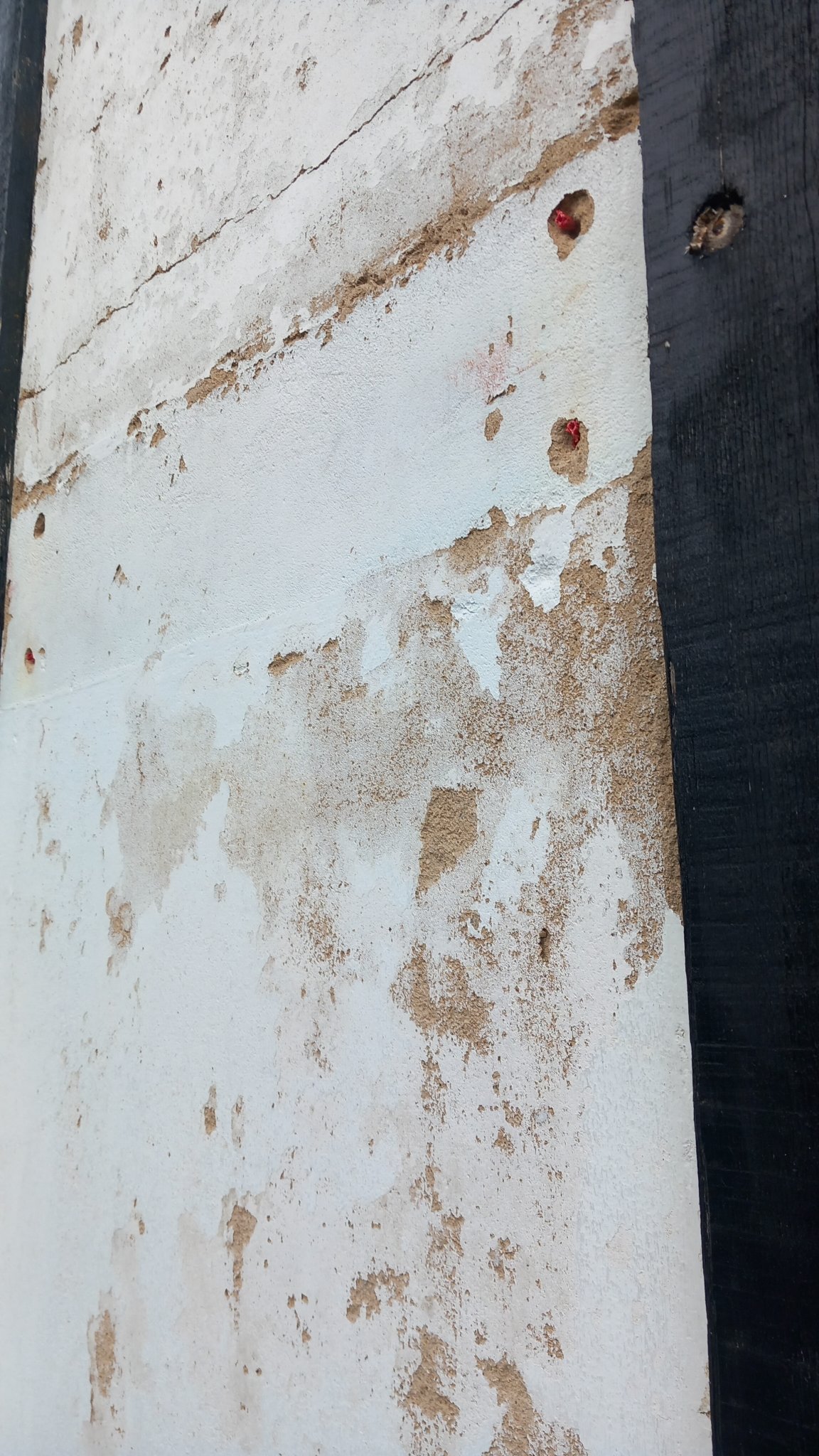

I'm looking for a bag of pre-mix external finishing render (smooth). Any ideas where I can buy it from any of the usual building suppliers? I've looked online at the usual suspects; Wickes, Travis Perkins, B&Q, Selco etc but cannot seem to find the right thing. They appear to have base coat but not finishing (smooth) coat.
I have a 1980s mock-tutor (white render, black boards) property. I'm removing the horizontal boards but what remains is quite rough, needs smoothing before painting.

Will stick fine as is.
About 12 mind in it's used for cracks so you can have a look at it being used.
Just for filling it would work well as you aren't skimming over everything

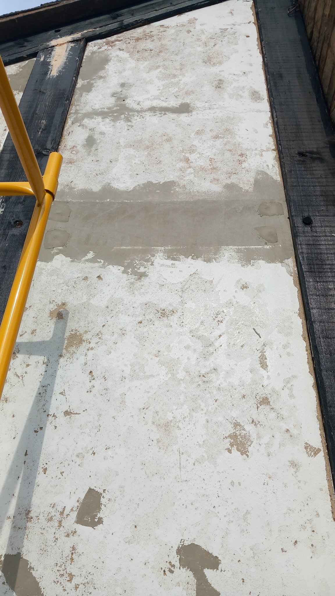

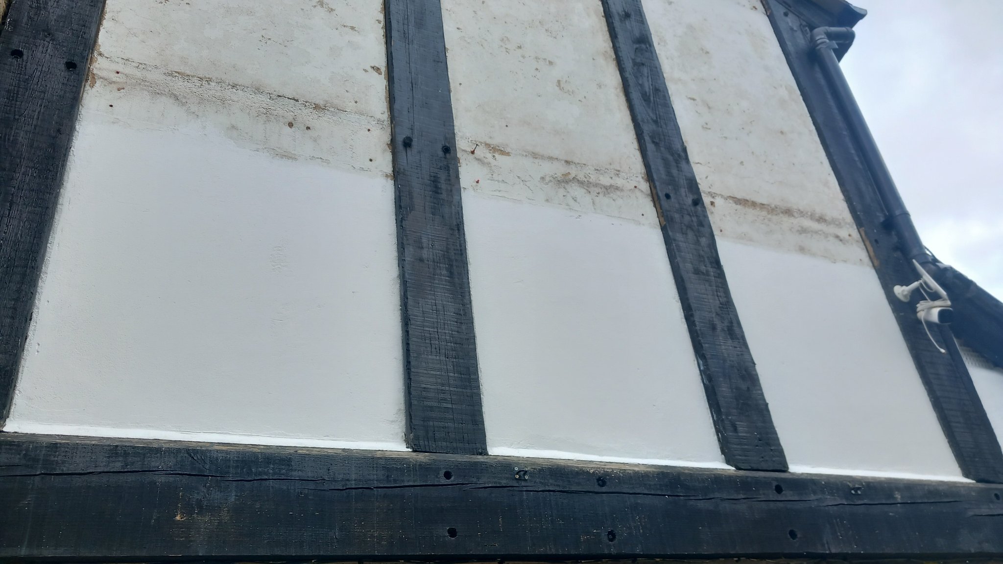

I've bought and used the Toupret stuff now. It seems to be working ok (work in progress).

Damp sponge edges to bend in.
You can mix up some and roll over if you want to rough up surface a little.
Get artistic and creative.

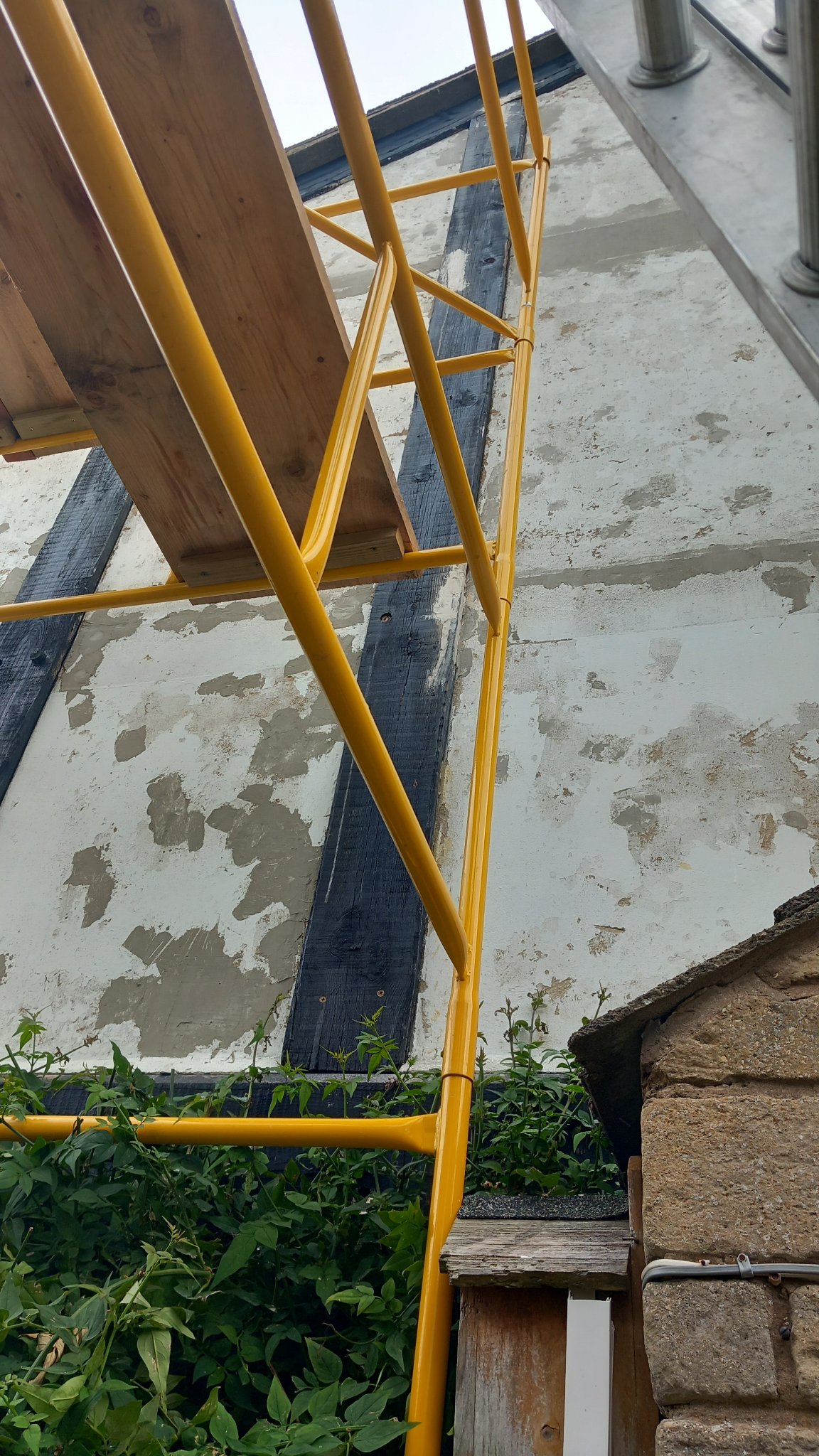

What's beneath it? Concrete block? I'm guessing if it's modern then it's not actually panels and the timber isn't actually structural, more likely just nailed on planks.
You may be wasting your time, it's moved before so will move again and crack your patches. You'll probably see the joins and over-skim marks once it's painted.
Probably best to re-do it all, with a modern product in embedded mesh. While you're at it you could consider losing the mock tudor look if you fancy a less fussy finish with less maintenance.
Or just finish one panel, all done your way and painted, see how it looks after a winter.
