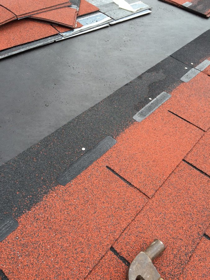

I've just finished building a summerhouse and I started putting the "shingles" on the roof.
Before the shingles I fixed this waterproof underlay to the roof (http://www.screwfix.com/p/protect-a1-roofing-underlay-1-x-45m/31795)
I started adding the shingles but suddenly had a thought that the black rectangles on the shingles are maybe supposed to be above the felt tacks to stop water getting to them??
Or then I wondered if the felt tacks are actually meant to be nailed through the black rectangles so that the gluey stuff waterproofs them?

Here's how I *was* doing it....

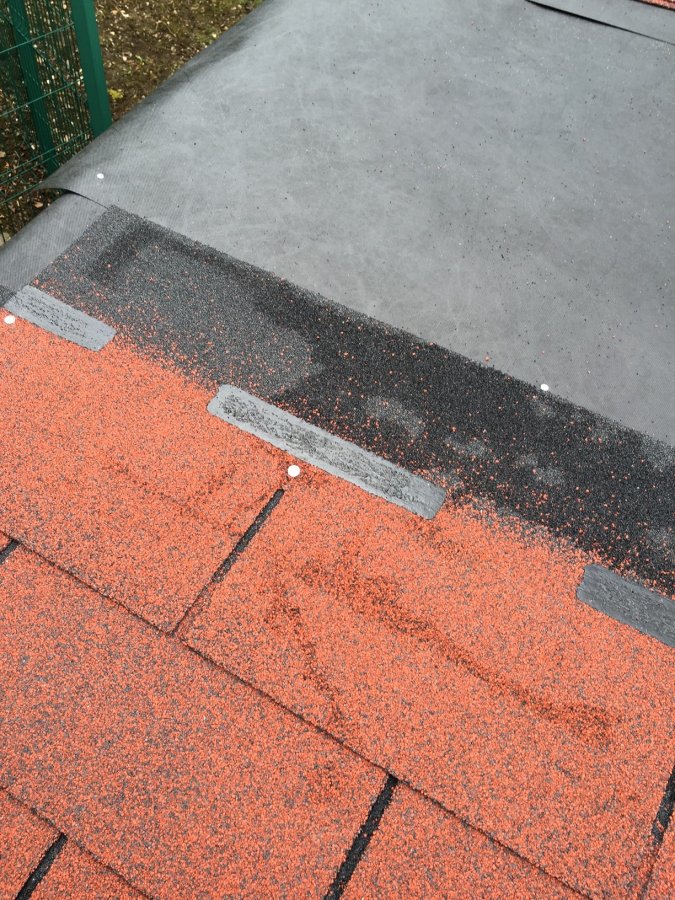

And this is how I changed it.....?

Never done it, but for what it's worth I think you were right first time, perhaps the oblongs are to lift the shingle very slightly in the middle to encourage water to run off better.
Think about it though, when you fit a basic felt roof you nail through and leave the heads exposed and they don't leak through every nail.:)

HI
The rectangle gluey stuff you talk about, is an area of bitumen, the ideal is on a warm day this will melt onto the tile which is over lapping it.You are, in the first picture nailing them correctly.

Sorry, but I'm sure it's the second method. Each shingle is meant to be secured twice, ie the nails go through two at a time. That won't happen if the nail is above the top edge of the shingle underneath.
Thanks for all the help on this.

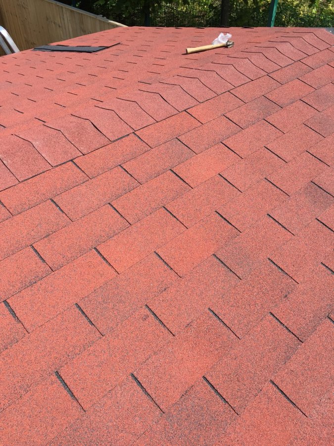

I ended up using the second method for the rest of the roof (as mfarrow says - it means the nail goes through both shingles so I thought it would help make it more secure). I didn't bother 're-doing' the ones that I had done as I'm sure that they'll be fine. These shingles are quite heavy duty so I don't think they'll be going anywhere (touch wood) but will keep an eye on it when winter kicks in and it gets windier.
Thanks for everyone's help and advice on this.

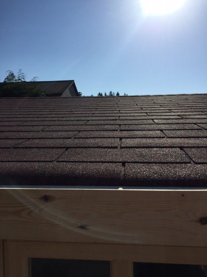

Here's a pic of the roof just after I completed it.
Thanks, as always, for all the help.... now on to the next job..... :-)
