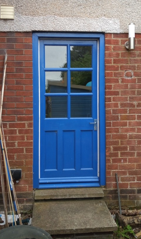

The old door

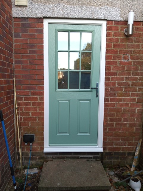

And the new door
Took a bit longer than I planned, but I had to replace the concrete sill with discontinued imperial bricks. Quite by chance a neighbour was having an extension built and were happy to swap some for a tub of Heros.
Other "fun" was the absolute knuckle dragger of a builder who couldn't cut brickwork. Originally that doorway was a window so the top half of the opening is nice but when he cut downwards, couldn't cut straight, square or vertical. Bottom left needed my skills with the angle grinder to take up to 10mm off and bottom left bows outwards an extra 20mm at it's worst before wandering back in.
Original frame was 120mm, new is 50mm, so there was a gap to fill in the floor and replaster the rebate. Before anyone says something, I couldn't set the door back as it would have exposed the cut bricks and with the lack of a straight edge, hiding it with UPVC wasn't an option.
Still, job done. Kinda fun, not particularly difficult.
