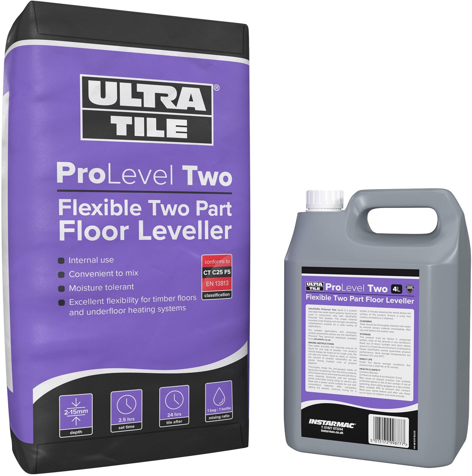

I have currently managed to get an offer which works out around £13 per unit if i take a pallet of this :
I roughly need around a pallet anyways so this works out great.
The only problem is that on the bag/sack it says 2-15mm depth, but i need something that can go upto around 20mm depth. I know it is only 5mm difference but i would rather stick to the manufacturers adherence of what they suggest.
But then on a seperate image which is still on the same product listing it shows something saying:
30mm - consumption per 10m (squared) area = 19.2 bags + 8.1 x 10kg Units aggregate.
Does this mean that i can use this product at upto a 30mm depth as long as i add the right amount and specification of aggregate to it?
and by aggregate i am assuming that it is roughly a 1:1 ratio of clean sharp silica sand? just trying to figure out if it is any different from the water-mix SLC to this Latex Bag-and-bottle SLC, in regards to adding the aggregate. Any advice at all is much appreciated. Thank you
