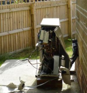

Removed an Altherma a few weeks ago, the guy had one Winter with it & wanted rid, it was costing a fortune to run!!!
What did you do with it Delta. Install it in another gaffe? South of the border perhaps.
Seriously though where is it.... On E bay or off to China as scrap?
