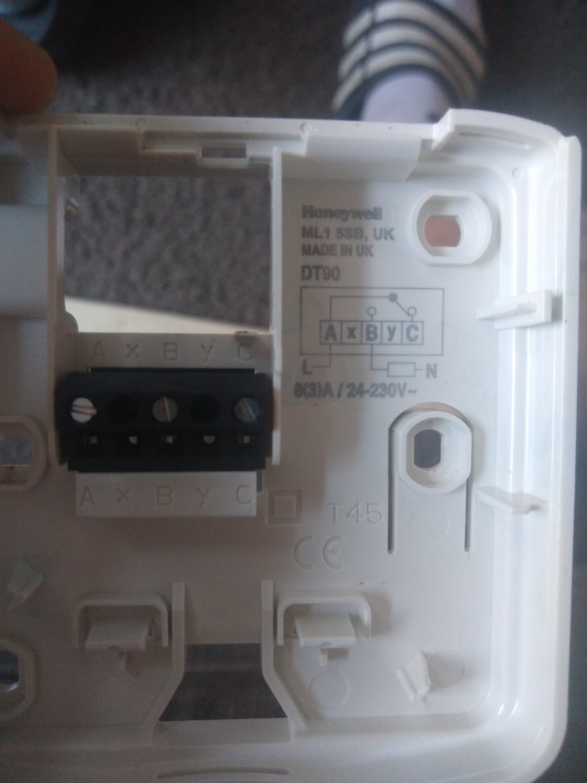

I am replacing an old analog style satchwell Tsx 2356.
Just taken the unit off the wall and the cables behind are as follows:
Red
Yellow
Yellow / green
Blue
I'm assuming blue is neutral, yellow/green is earth , red is live? What is the yellow for?
Is this a switch live or something?
On the Honeywell DT90E I am installing, where does the red cable go and where does yellow go? I have put terminal block on neutral (blue) and just snipped and folded over earth.
Pic of the back unit of Honeywell one
Cheers
I’d say so, and generally yes (however colours mean diddly squat in a heating system). Can you test it/them?
Could you show us the picture of the original unit's connections before removal.
Looks like blue is N, red is L and yellow is calling for heat.
Red to A (Live in)
Yellow to B (Switched Live/Live out to heating)
Blue not required for new stat
G/Y not required for new stat
Put blue in a terminal block
Put G/Y in a terminal block
