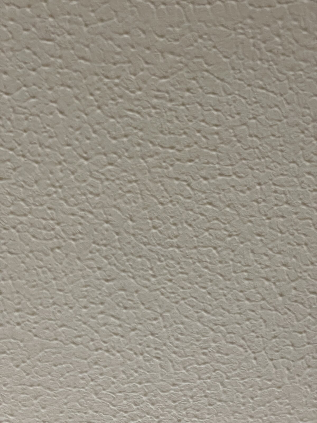

I need to match this ceiling texture. What is it called, and what tools can I use? It's quite regular! Thank you

Looks like it could be artex. Be careful though as some artex especially before the year 2000 could have Asbestos contained inside.
Edit: if you're only matching then you'd need to apply artex. Carry out an internet search if no help on here.

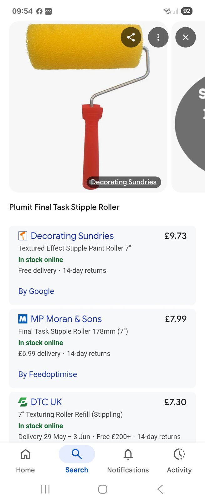

Stipple!
You won't get that pattern with a roller, you need a stipple pad.
You also need to get the mix spot on or it will be too spiky and that's a thinner than normal mix.
Like custered.
Worst pattern to match is stipple. You need to flatten in the damaged area with a sponge as any background imperfections will show through the pattern.
Just do the best you can and get ceiling skimmed later
