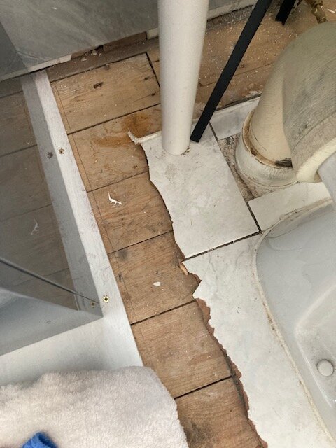

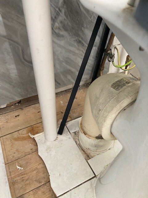

On the final stage of my bathroom renovation. Shower is in, sink is in, most of the shower panels are in place. Now its the turn of the WC.

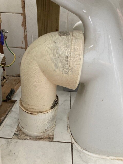

I've bought one of those "back to the wall" WCs, intending to fit it without relocating any pipework. The photo below shows the current connection to the soil pipe, which is routed downwards under the floor where it disappears into what I can only describe as a hill of concrete, then exits underground to the outside. My question is what sort of pan connector should I used to connect the new BTW? Would a flexible connector be best? Looking at the picture it seems to me that removing the pan connector as I take the old WC away will leave a nice open pipe for me to connect to, though I'm unsure as to the condition of that pipe and I'll probably take up floorboards to inspect before making the connection.

The key with this one is the space there is from the back line of the toilet and what distance there is to the projection of the spigot.
In other words, how much of a gap is there to fit the pan connector before it sticks too far out the back, you may have to leave a section of the wall out to allow some clearance. McAlpine's 'swan neck' connector has a projection of ~85mm

You'll get another 2 inches from a swan neck.

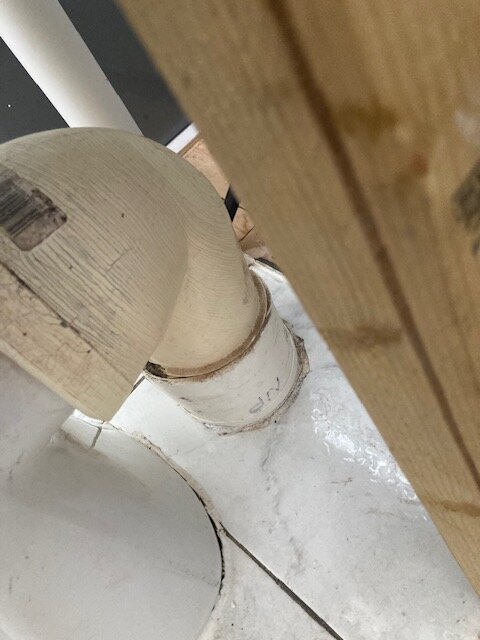

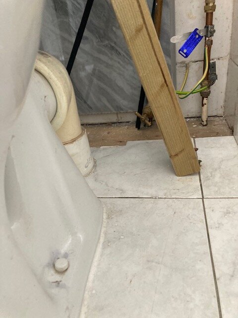

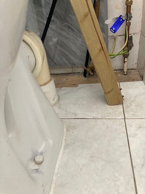

Pics below ( with some repetition, unfortunately) and thanks in advance. Its a dreadfully messy area, but I'll be throwing the WC out early next week so cleaning seems pointless. The distance from the last visible part of the WC spigot to the back wall is roughly 35cm. The white plastic pipe on the left and the piece of timber on the right are temporarily supporting the cistern, which is no longer attached to the wall.

Can you not remove the toilet, take up the floor and adjust 4 inch pipe under floor, so that the toilet can go fully back to the wall?
I can't be 100 per cent sure what's going on down there till I take up the boards. As I mentioned the other day, I had a look underneath an adjacent floorboard and there's a ruddy great mountain of concrete under the floor with the soil pipe sticking out of it. I'm sure I could break into that concrete eventually, with blood, sweat and the right tools, but meantime we'd have no toilet, possibly for days. But I appreciate the logic of your suggestion. .
How much clearance under the floor before the vertical soil pipe disappears into the concrete? Is there enough to cut it below floor level and get an elbow on it to head backwards and still have the top of the soil pipe under floor level? If so then it's just a case of directing the soil pipe backwards, a piece of straight then back up above the floor.
Not ideal having that many bends but may be the only option if you can't get into that concrete.
