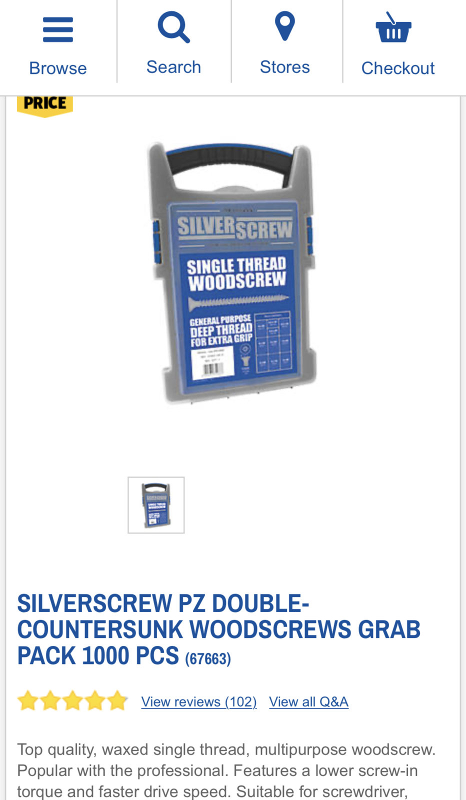

Hi all
I’d like to buy an assorted screw set, I have a wood screw set already with about 200 screws in it but the screws I’m after are the silver looking type ‘photo attached’
The wood screws I have are gold in colour and have a strange cut through the threads ? To help them cut into wood? I don’t know ...
Excuse my lack of knowledge
i want to use them in wall plugs to mount shelves etc ....
i have looked online and there are so many types ?

Ok thanks, so as per the photo I attached what screw type is that? Dry wall, wood, masonry, stainless steel etc...
i want an assortment of that screw type so how would I go about finding them ?
whenever I buy light fittings etc they come with silver screws, never wood screws, so if I want a set of screws to use for light fittings, shelves, clocks or general purpose indoor use what screw type should I buy ?

ok so what screw type are they? Dry wall, masonry, wood?
The type in the picture is a bugle head, for attaching plasterboard to wood/metal.
You just want 'normal' BZP screws, countersunk, twinthread, pozidriv screws.

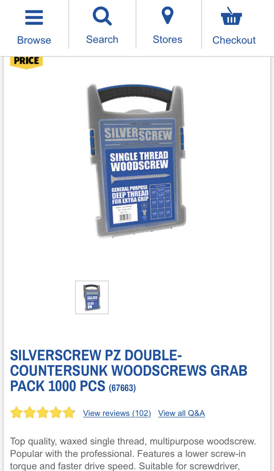

Photo attached
