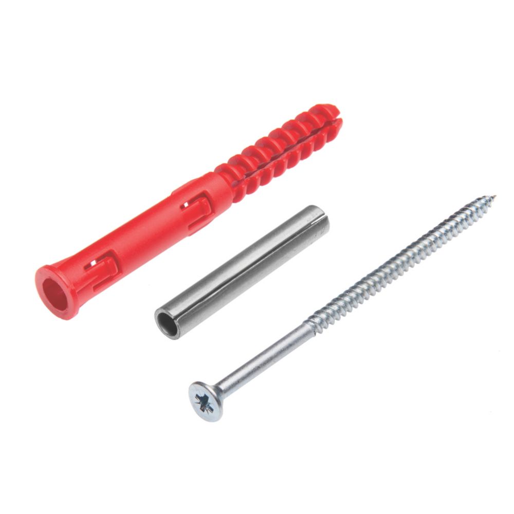

I want to attach a length of 4x2 along an inside brick wall which has been dot and dabbed plasterboarded too. Which length and size fixing would be best to use. The 4x2 will be having joists attached to it for a small ceiling. Thanks
Order online at Screwfix.com. Corefix 120 heavy duty steel-reinforced fixing for dot and dab (plasterboard over blockwork) walls. Suitable for all brick and block types, including lightweight blockwork. Ideal for securing deeper fixtures of between 10mm and 30mm thick such as timber battens...
www.screwfix.com
They have a metal collar that distributes the load from the blockwork through the plasterboard. Not cheap though.
I have only used them on one job. I had to put up shelving racks on a dot an dab wall. Regardless of the cost, I was happy with their performance in thermolite blocks with 9.5mm plasterboard.
