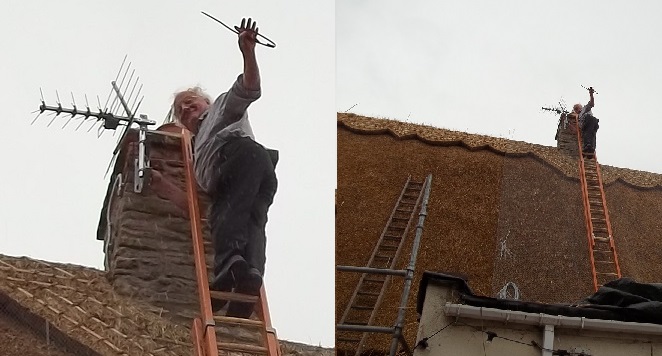

I wouldn't go near the chimney to fit a normal one.
Nothing to it ( if one is a bit mad and the ladder is already there )
I do NOT reccommend this as a DIY project
Next time your in Rochdale you can go up on my roof while I put the kettle on!! (y)
