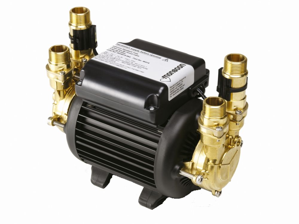

I've no experience of shower pumps, and need to install one to enable a downstairs bathroom to be used while we renovate upstairs...
The hot water cylinder is vented, and very svlixated on a first floor bedroom cupboard. The pressure at downstairs bathroom taps is insufficient for a shower...
Any recommendations gratefully received!
You need one of these:
or one of these for the whole house:

While I agree with Herts P&D re. getting a Stuart Turner pump, if:
a. the renovations are not going to take long (< 1 year)
AND
b. the pump will be redundant when renovation completed
then a cheaper pump like the Stuart Turner "Showermate" range would probably suffice.
Thanks. All being well well need to use the pump for about 6 months.
Is a 'twin pump' "one that pumps both hot and cold? The cold is mains pressure so I assume this doesn't need pumping? Does this mean I just need a single pump?

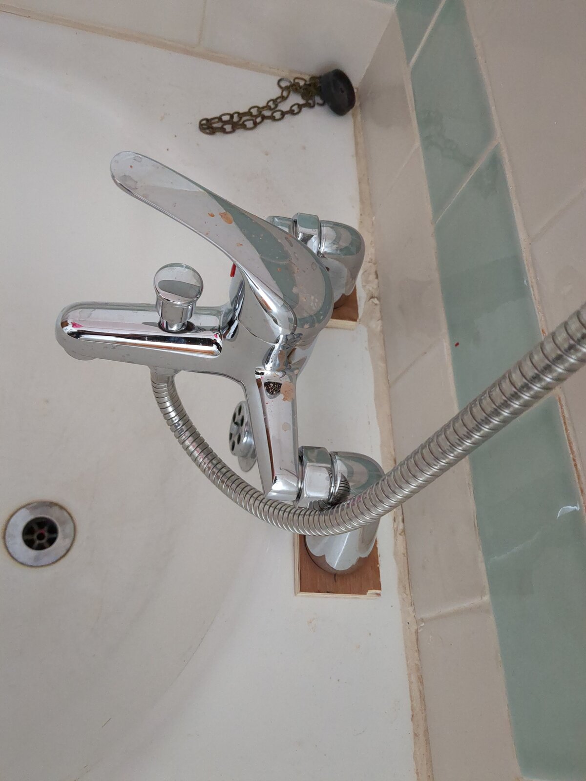

Just mains downstairs. I think I'll start by putting some mixer taps on the old bath downstairs and see what happens....
I don't think it's acceptable for a shower to have cold from mains, hot from pump or gravity, but perhaps pros on here can confirm, or otherwise.
Fitted a mixer... The steel bath is so old it's got square tap holes so had to knock up some washers...
