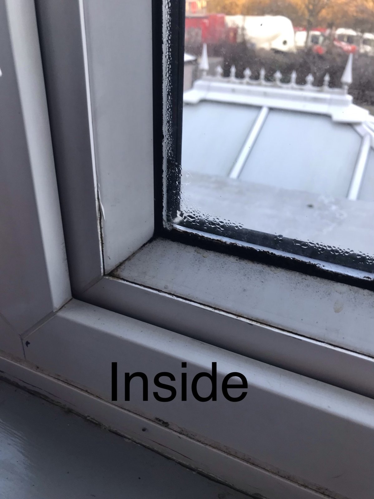

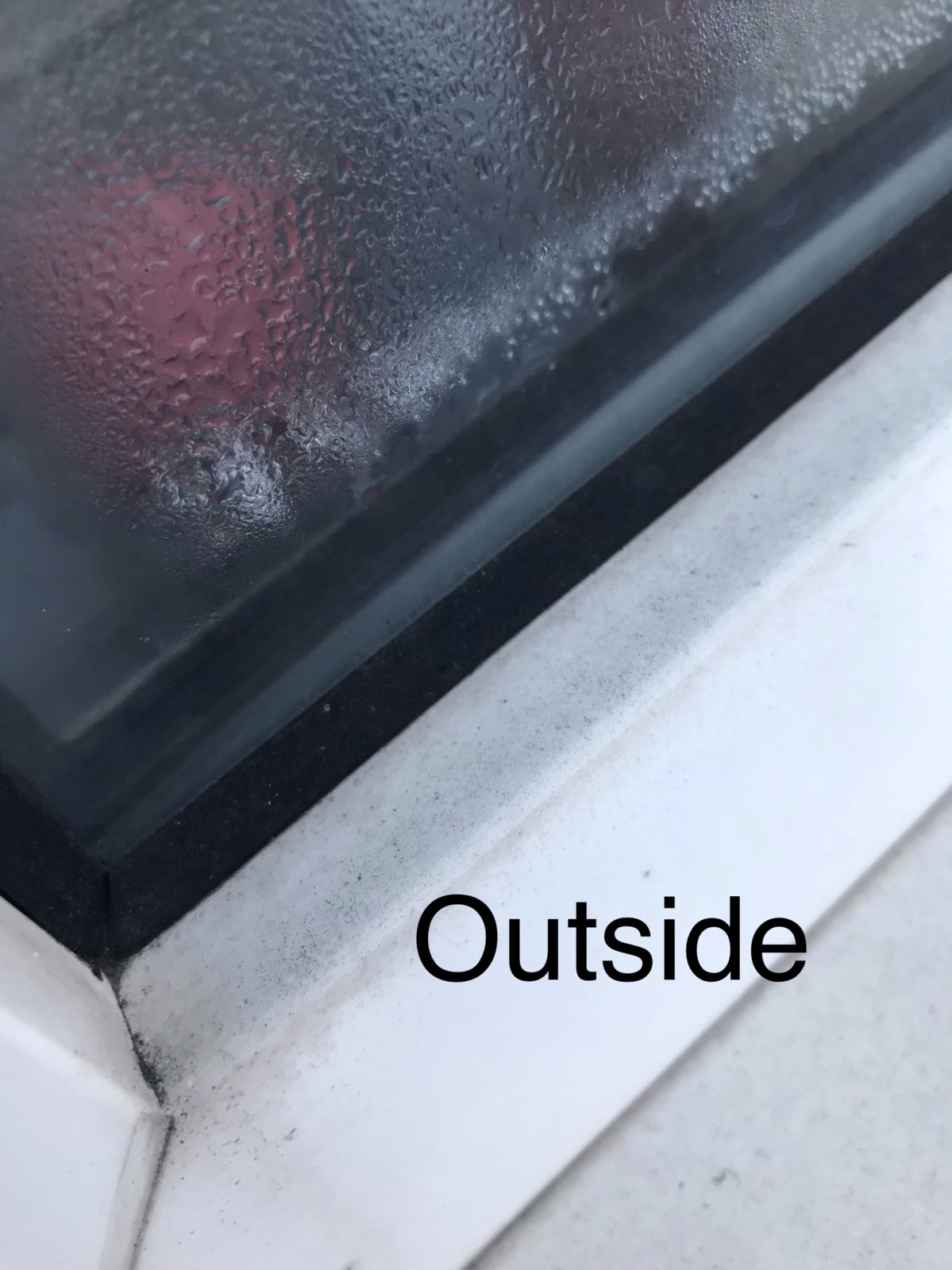

Which type of unit is this??
13 Dec 2018
3
hi please see attached pictures regarding by back bedroom window. This must be 20+ years old. As you can see its INTERNAL beading. NO glazing tape. I need to change the small top opener pane.
Ive remoed the rubber gasket on the outside but unable to get the inner beading out at all. Can anyone advise?
I thought internal beading was used only on more newer windows??
You have the right approach, Some beads are just a are just a tw*t to get out.
Try using 2 scrapers.. One you get the end of the bead out a bit get the 2nd scraper in deeper behind the bead
Looks like you tried to move one end which is tightest spot, start centre of bead bowing it and work to corner.
Looks like a security bead but they are generally glazed from outside.
