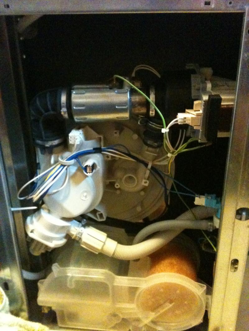

My Dishwasher has stopped spraying water out of the sprayers. When I turn it on it seems to be starting up and the bottom fills with water.
But then that is as far as it goes, it still sounds like it is trying to run but the water does not spray out.
If I end the circle the water drains out normally.
There are no flashing lights for errors.
Any idea?
I thought it might be the pump but then would it drain the water out after? Are there two pumps?
Or the inlet valve? Would it let water into the bottom if this was faulty?

Some of the other suggestions say that there could be something trapped in the fan of the pump on our threads. Which part do I check for this.
This is a picture of the bottom of the dishwasher
Looks like there might be two pumps there, one for waste, one for spraying water through the arms... might be wrong, but I think that pump might be knackered

Although the photo doesn't show the complete circulation pump (top RH side) it looks like an Askoll type (this machine can be fitted with 2 different circulation pumps). Unfortunately the Askoll types are prone to problems (the impellor has a habit of falling off or into bits). Before removing the pump to see if it is just jammed or damaged check that the dual bore feed pipe to the spray arms hasn't popped out of its receptacle in the base. This is also a very common issue on these machines. With the pipe out of its socket the pump will run but loose all water pressure to the spray arms. The drain pump (lower LH side in the photo) is ok, you don't need to look at that.

Ok Thanks I will give that a try. I the mystery of the changing model number was that I posted at work as I was on nights and I had to go by a picture for the number. So I edited it when I got your information.
