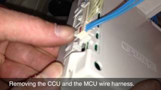

The F11 error on a Whirlpool washer indicates a communication failure between the central control unit (CCU) and the motor control unit (MCU). The most common causes are loose or corroded wire connections, but a failed control board can also be the culprit. To troubleshoot, first try unplugging the machine and then reseating all wire connectors at both the CCU (under the top panel) and the MCU (under the machine). If the error persists, the problem could be a failed MCU or CCU.
This video demonstrates how to access and inspect the motor control unit:
57s
Scott The Fix-It Guy - Appliance Repair Videos
YouTube · 26 May 2017
1. Inspect and reset connections
  • Unplug the washer: for safety before starting any work.
  • Remove the top panel: by unscrewing the three screws at the back, then sliding the panel back.
  • Locate the CCU: (the main control board) and unplug all connectors, then firmly re-insert them.
  • Remove the back panel: or lower access panel to find the MCU (motor control unit).
  • Check all wires: connected to the MCU, especially the blue communication wires, and firmly reseat each one.
  • Clean any signs of corrosion from the pins and connectors using an electrical contact cleaner if possible.
This video shows how to access the control units and their connections:
56s
SamuraiRepairman
YouTube · 23 Oct 2013
2. Test for issues and replace parts
  • If reseating the connections doesn't fix the problem, the error could be due to a faulty board.
  • The MCU is the most common part to fail, but the CCU can also be the issue.
  • To further diagnose, you can test the motor windings with a multimeter, but this is a more advanced step.
  • If you are not comfortable with this, consider calling a professional. Replacement parts are available if the boards are confirmed to be faulty

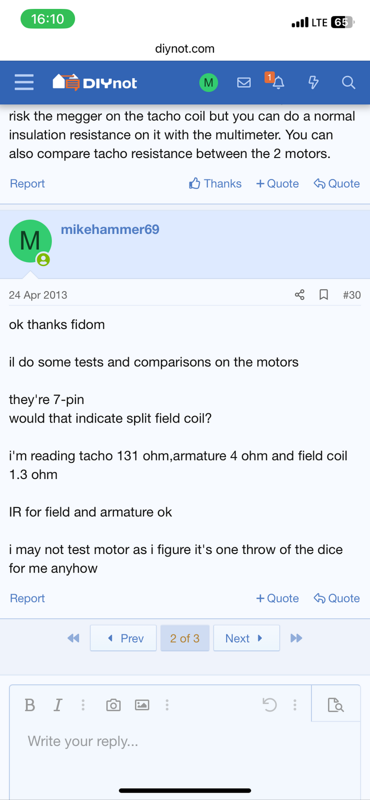

I had all the motor readings noted previously , don’t know if I still have , but I’ll check it anyway
I’ve inspected the CCU , next I’ll take a look at MCU
Good video above btw
Black patch in the timer/ motor controller
I ain’t gonna get it fixed this time
