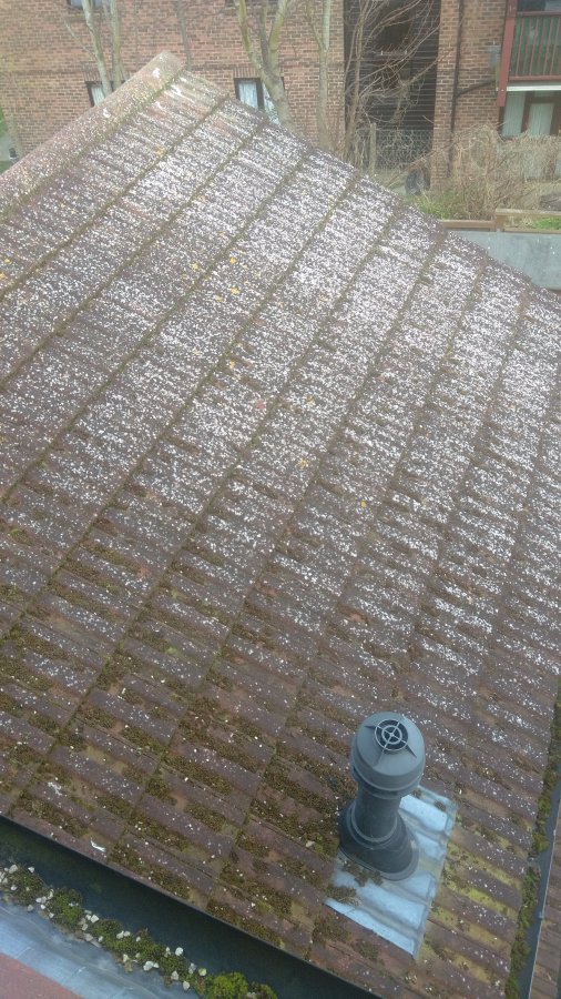

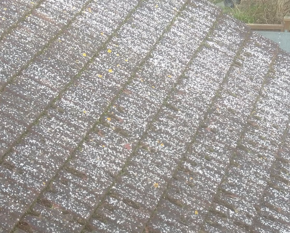

Hi, could anyone identify what these white marks are on my roof and how I can remove them? thanks

Looks like just general weathering to me. Why do you want to remove them?

OP,
You seem to have a lot of moss on the roof esp at the near gable. Your gutter is getting full with moss, & the lower roof flashing at the gable is showing a significant build-up of moss debris?
Perhaps clear all the moss esp at the lead flashing & gutter where the moss might cause leaks.
A good, painstaking method of removing moss from concrete tiles is to lift and clean each tile, one by one. But is it worth it?
Or a long handled stiff broom might shift the majority.
Lichen, if it's all white then it's probably all dead and can be jet washed off [working down only] , Jeyes fluid will kill anything that's still living.
Thanks all.
We're planning to sell the house in the next 6 months, so just wanted to remove the marks before the house sale. I wasn't sure if it was something that would put potential buyers off.
Vinn - yes, I do need to remove as much of the moss as I can. It seems to build up fairly quickly.
Foxhole, ok great - will try jet washing and see what comes off.

Use a fungicidal wash.
Never a good idea to use a pressure washer on your roof tiles.
Thanks Pete, I'll swerve the Jeyes fluid then!
Ok alastair, I did wonder about that. I'll try the fungicidal wash.
I presume the lichen will just keep coming back...with regards to flogging a dead horse. I wouldn't be bothered about it if we were staying here but didn't want anyone to be put off by it when we sell.
