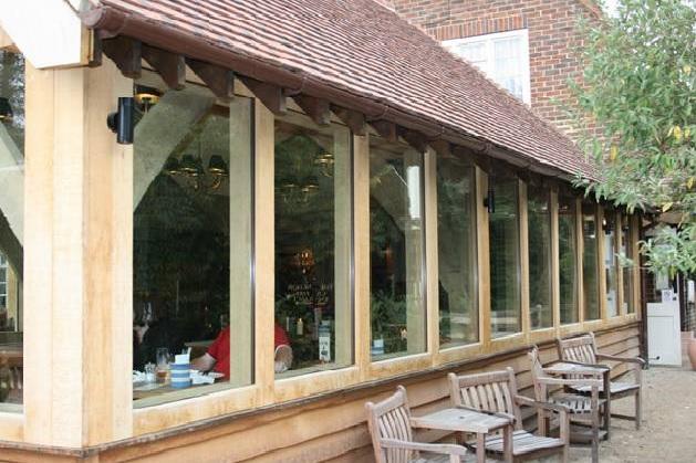

Width and length is 8348 x 3997 max.
Width and length of flat roof area is 5375 x 2350 ish.
Width and length of roof light is 4375 x 1350 ish.
Glass cladding will be done by oak cladding the steel posts/beams in 38mm kiln dried oak to 3 sides, softwood packer same depth of glass unit and an air dried oak cover board to sandwich glass, EPDM glassing tape inside and out. Much the same as most green oak structures to allow for movement without loss of glassing seal.
Thanks very much for the info.
Sorry to be a pain, but have you got elevation drawing of the glass panels etc?
The critical question you did not answer was where do you propose to fit down pipes?
Regards oldun
Sorry I should have read your post thoroughly. The down pipe will be on the left hand corner of the orangery/original house as you look down from the top of the orangery. I don't have any elevation drawing as in the original drawing I had planned to fit oak framed windows within the steel frame. I have added a photo of the intended look though apart from it will go down to ground level in my case.

Many thanks Mr O, at this rate I'll have to etch your name on one of our steels for future generations. By the way mentioning steels, it's all up as of yesterday and it's looking bigger by the day :shock:
