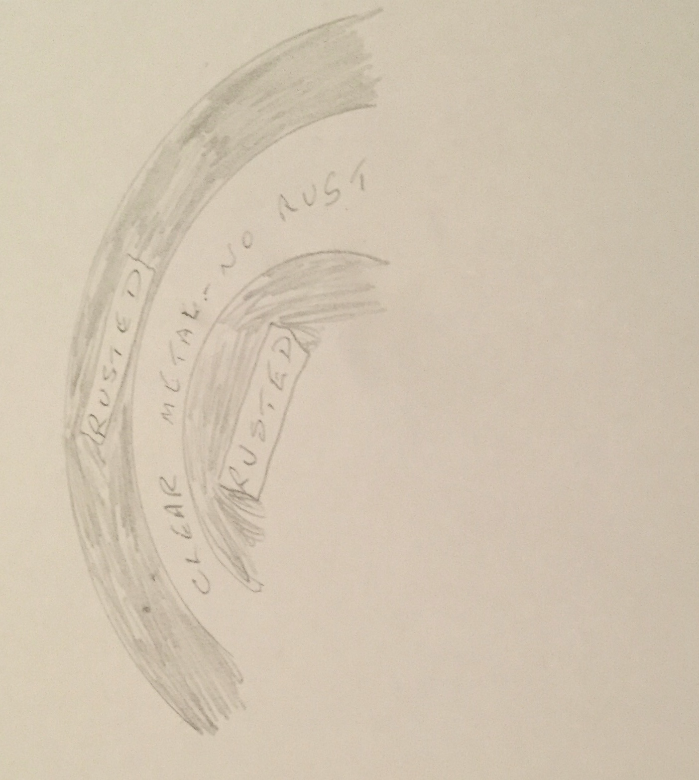

Don’t know it helps but given that I could only see part of the disc that the AA guy pointed out, the image below gives a rough idea of what that disc looked like to me. The clear metal strip between the 2 rusted ones, was roughly 30-40mm wide.

Referring to your diagram, this is what happens when the discs / pads are getting on a bit - maybe towards a year or so?
The disc naturally rusts, that we know about.....right from new. When the brake pedal forces the pad against the disc, theoretically the rust is scraped off. However.....if the rust isn't scraped away, the corrosion continues as you have shown. Rust is much harder than the disc material (a sintered iron mix) and just gets polished rather than scraped and gives the wear lip on both the disc and the pads.
With new discs and pads, this rusting syndrome is removed to a large degree as both the disc surface and pad surface are completely flat, but as the mileage builds you do get this discrepancy.
Sticking my neck out, this is why its best to replace both the pads and the discs at the same time - unless the car does a high mileage when the rusting doesn't occur. On your first post, you said you had two discs but only one pad - which I presume means pads only on one side? Bit of an error there, I'm afraid!
The question remains.....why did only the offside system wear?
