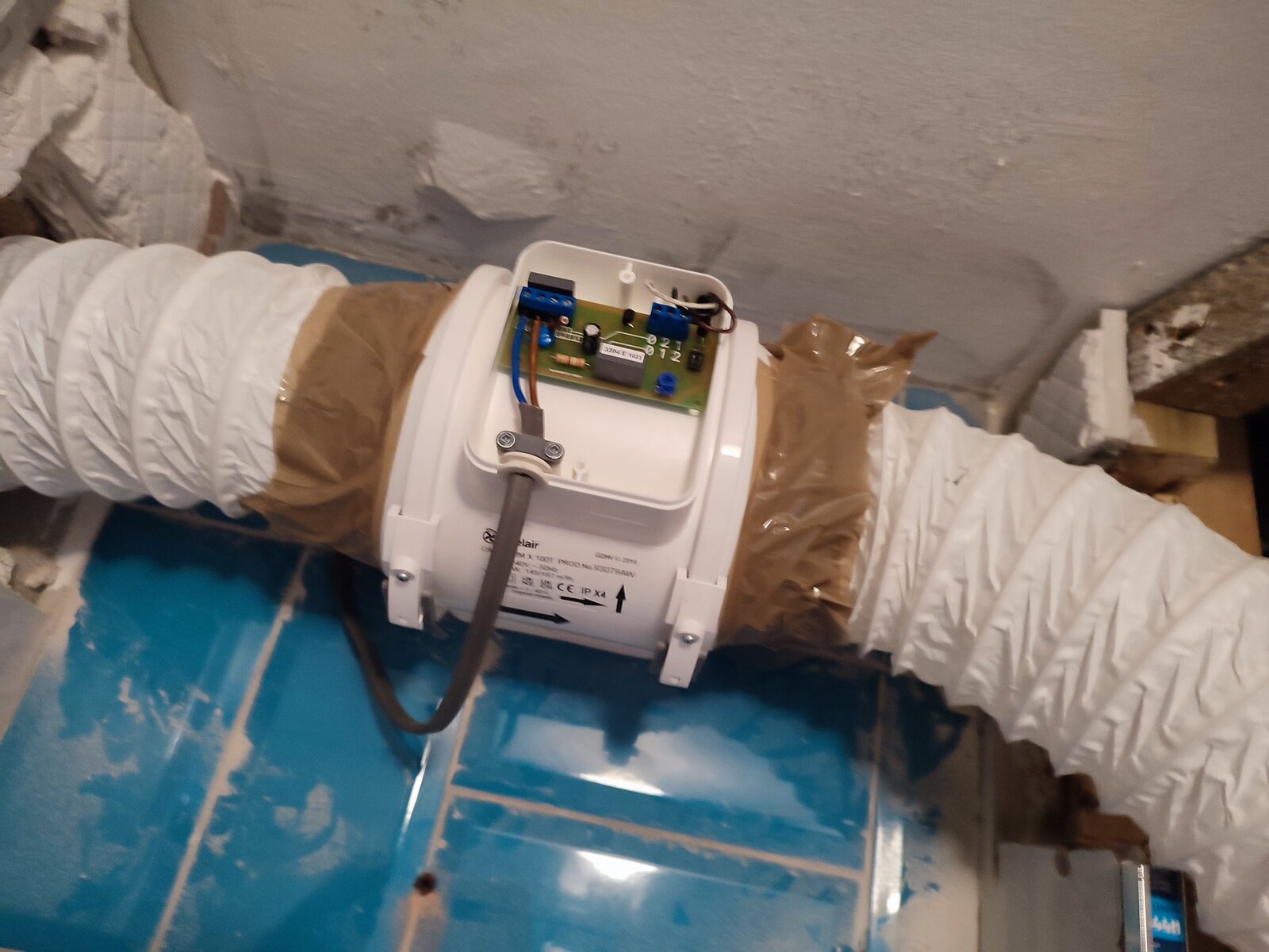

I haven't actually seen it run because like you say with L and N connected and the light on it should operate until the light is switched off.With a timer fan, if the timed and permanent live feeds are both supplied with power, the fan should operate.
Linking the two terminals simply makes the fan an on/off fan, with no overrun.
If you've proved the fans work (it still may be worth trying with a flex), use a short link wire to join the timed and permanent live connections together.
Then try and connect up the live and switched live in turn (safely isolating power and the other wire when connecting).
If the permanent live is working, the fan should turn constantly.
If the switched live is working, the fan should turn on and off with the switch.
If the fan doesn't work with either - look elsewhere!
The cable to a timer fan would usually be a 3 core + earth; are you sure you've got the grey, brown and black cores marked up correctly?

They areThe cables on the right hand side have not been fitted ?
They are

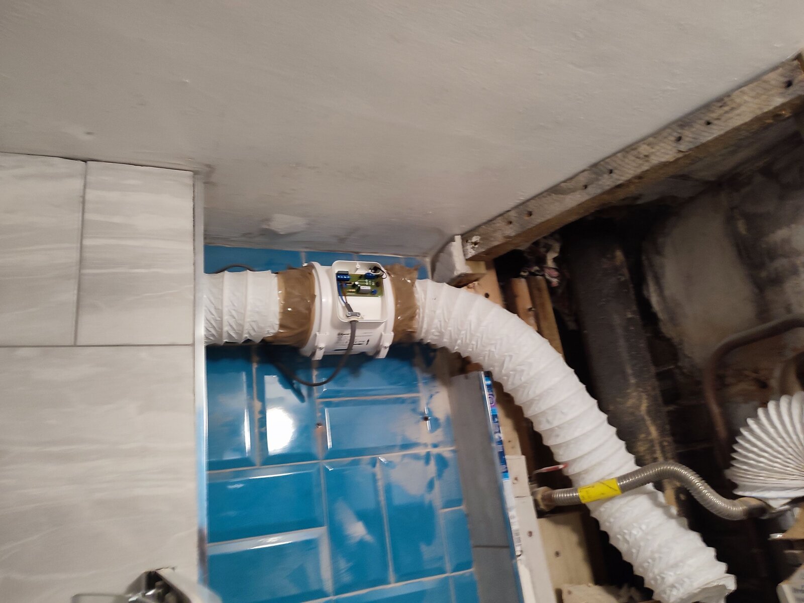

Thanks. Parcel tape is temporary until I get the duct (I have to run around the getting the 1st fix materials for him)Why is he using parcel tape rather than jubilee clamps?
My bad, sorry.
Looks like it needs a switched live-page 13
And no, it is not acceptable to use the earth as a switched live. Get him to pick up some 3 core and earth cable. As a test, bridge the perm/switched live with a small section of cable.
Directly from circuit to light fittingWhere is the extractor fan power supplied from?
