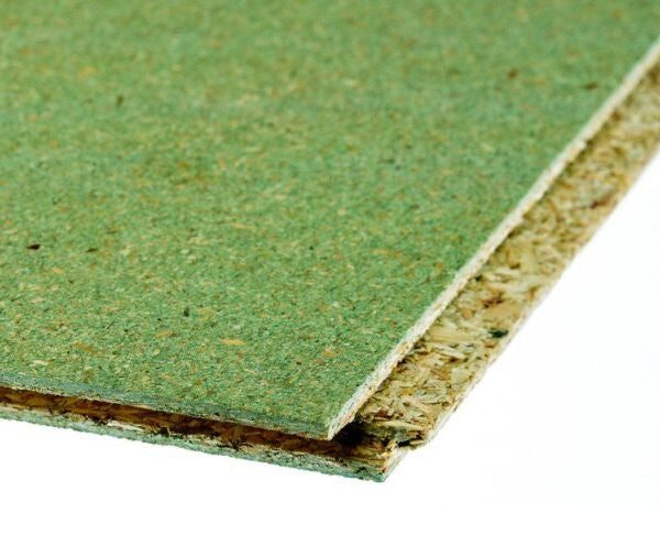

and insisting on the use of the appropriate adhesives and fixing techniques. This means that yes, installing sub-flooring isn't just wham, bam, thank you ma'am - it is an engineered product and needs to be installed appropriately unless you ewant the darned thing to creak and crack. Personally I'm somewhat less than impressed by the standards of some of the guys I've had working for me over the years, but slip-shod and slap-dash seem to be the modern approach for at least a percentage of the guys we get.

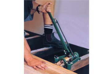

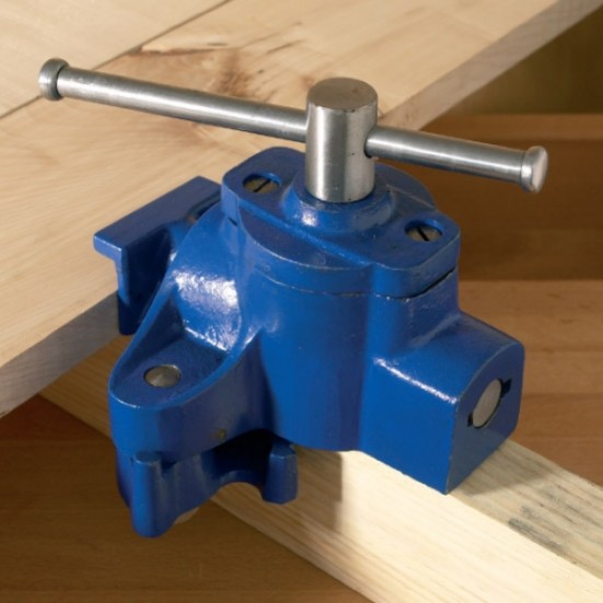

AFAIK they (or an equivalent) have been around from at least the 1870s and are still used. Even before the metal ones came into use wedges and bars were used to pull joints up. These days they are lessmcommon (as is T&G planking for that matter) and there are quite a few modern equivalents on the market which also get used for decking and the like:

Wow, thanks for the thorough reply. Very interesting - I never even heard about flooring clamps before.

Modern chipboard and OSB sub-flooring products tend to come in 600mm wide "planks" with tongue and groove edges all round. AFAIK wiith the exception of some specialised plywood sub-flooring (e.g. spruce - which comes as 2400 x 1200 mm T & G sheets) full size sheets come with square cut edges - so if you don't want them to creak you need to route out a groove in the edges and install a glued-in tongue. I've pullked up and replaced quite a bit of chipboard in recent years but verey rarely seen this done on non-commercial jobs.

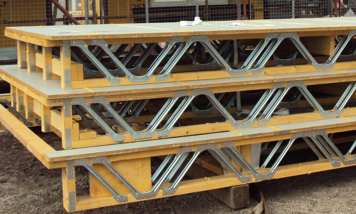

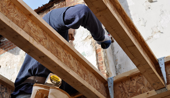

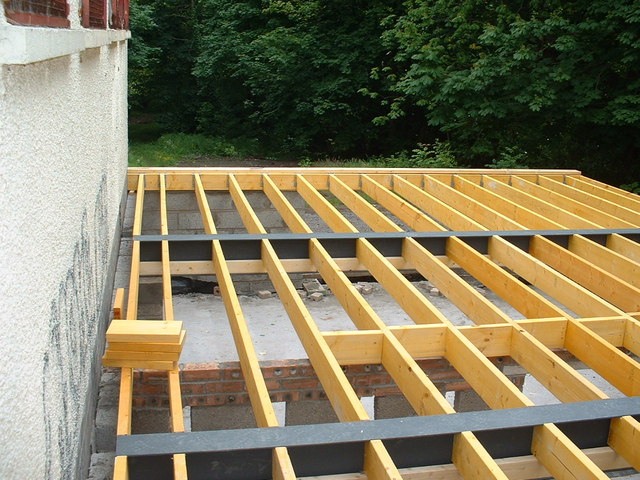

500 to 600mm centres is very wide and when you do see iy it tends to be for composite I-beam joists like these:
or space joists:
or the timber equivalent, the open web flooring truss:
The thing about those, they are generally specified for use with a stressed skin sub-floor (either plywood or chipboard) - which means the sub-floor must be glued and screwed (or nailed) T&G sheets where the boards are glued top the tops of the joists and also at the tongues on the edges. These days S/Es also tend to specify 22 or 25mm flooring on such wide centres. "Just screwing it down" onto these modern joists simply won't work

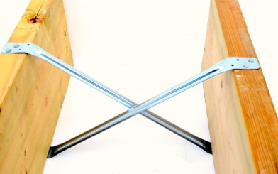

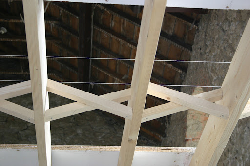

In a traditional solid timber joist floor structure the bounce is often caused by the joists being marginal for the applied load, assuming that there are no other structural defects such as over notching or over drilling of the joists or problems with their end supports. When you load a joist, if it is properly secured to the sub-floor (by being glued and screwed) the only thing the joist can do if it is heavily loaded is to bow a little and then twist sideways (note that the glue reduces any tendency to bow by supplying a far greater connection area). The way that twist is cured is by adding herringbone or solid strutting between the joists (BTW tyhese are NOT noggins). Solid strutting should be be the same thickness as the joists and between 80 and 100% of their depth and very tightly fitted to function correctly
Above: Modern metal herringbone strutting
Below: Traditional wooden herringbone strutting

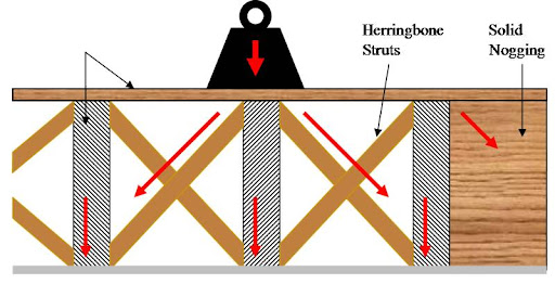

Above: Solid strutting
Below: How strutting transfers side load (twisting)
What the strutting does is to transfer the sideways twisting load into the adjoining joist, and the one adjoining that and so on. This results in a considerably stiffer floor with noticeably less bounce in it.
Whilst herringbone strutting (modern and traditional) is lighter and performs better than solid strutting, it is effectively only possible to install it before the floor is fitted, meaning that solid strutting is the choice for retrofits When installed in new builds it is cheaper and faster than herringbone because it is often possible to use joist end offcuts (where joists have been trimmed to length) to make up the strutting
