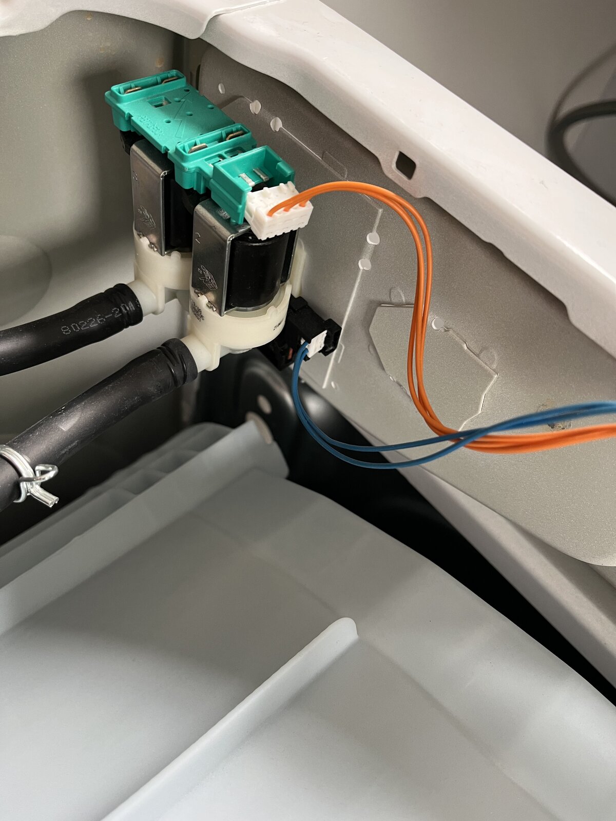

I’ve got a Series 6 Bosch washing machine with one water connection (cold feed only) so why are there 2 valves at the water inlet valve.? Is one for feeding the pre-wash container and one for feeding the main dispensing container?
The reason I ask is because I replaced this inlet valve a few weeks ago and have noticed that the filling water now comes in through the pre-wash container, rather than the main compartment. I’m sure I replumbed the pipes correctly and the plug connector only fits one way so I think the wiring in the valve must be faulty, but that seems unlikely.
One for the main wash for washing powder Second one for conditioner if used in rinse There will be 2 seperate compartments in the soap drawer
I’ve actually got 3 compartments! Main powder (left) , conditioner (middle, prewash powder (right). I suspect one valve is for the main, one for pre-wash and when both flow together, they go into the conditioner compartment?
Mine starts by sending water through the prewash compartment, then, after churning a bit, switches to sending it through the powder compartment. I've heard it does that using a diverter flap. Something to do with not wasting powder by letting it fall straight through to the sump.
Yes I had just started to remove the old valve and I thought it would be a good idea to take a photo so that I’d fit the new one correctly. Hence the loose connector!
