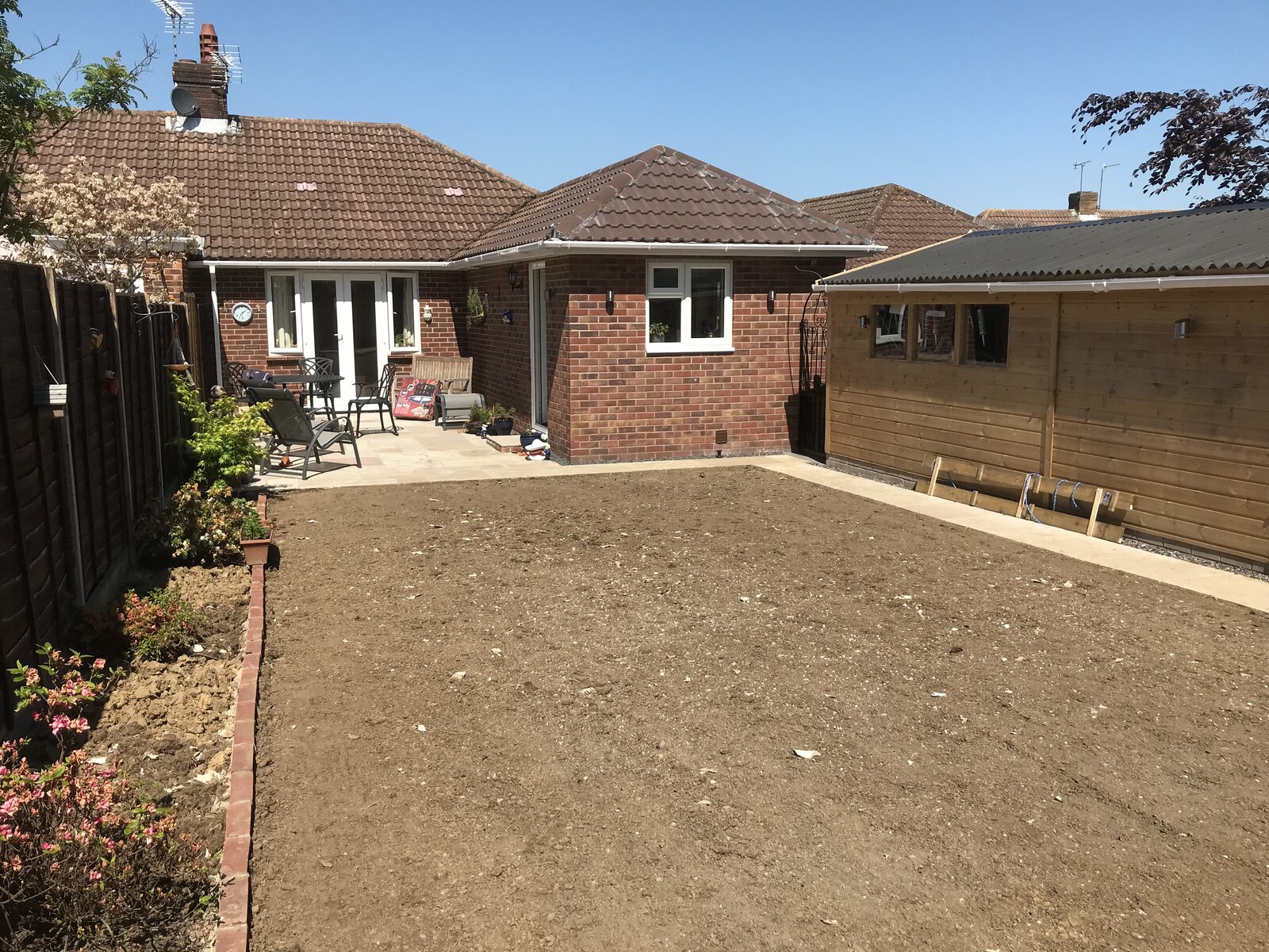

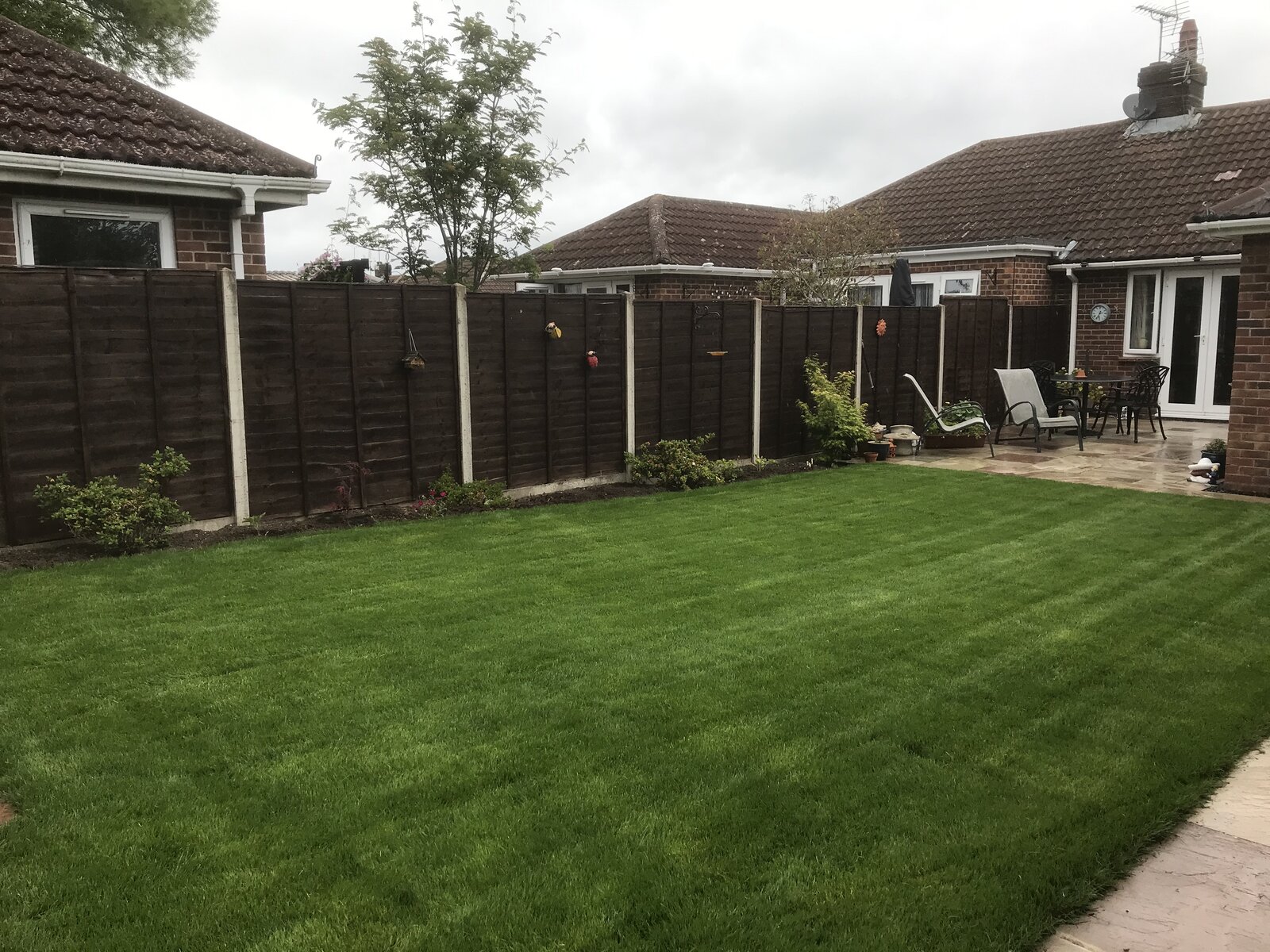

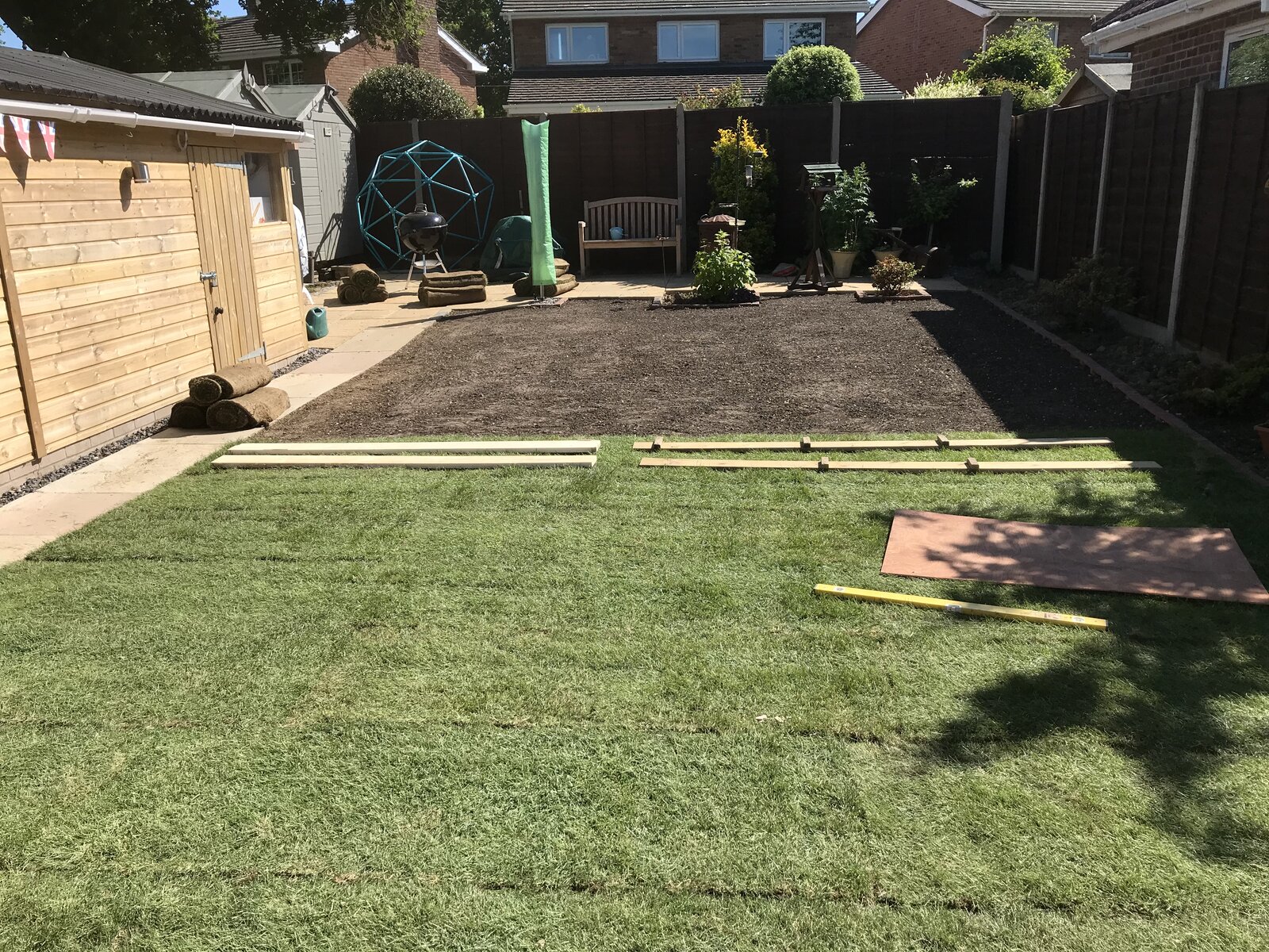

I agree with swills having done this last summer. I used turf and am happy with the results. Used a rotovator to prep and added well rotted horse manure compliments of my granddaughters stables and then 2 tonne of top soil. Level, use boards if laying turf then keep off it and water daily.
