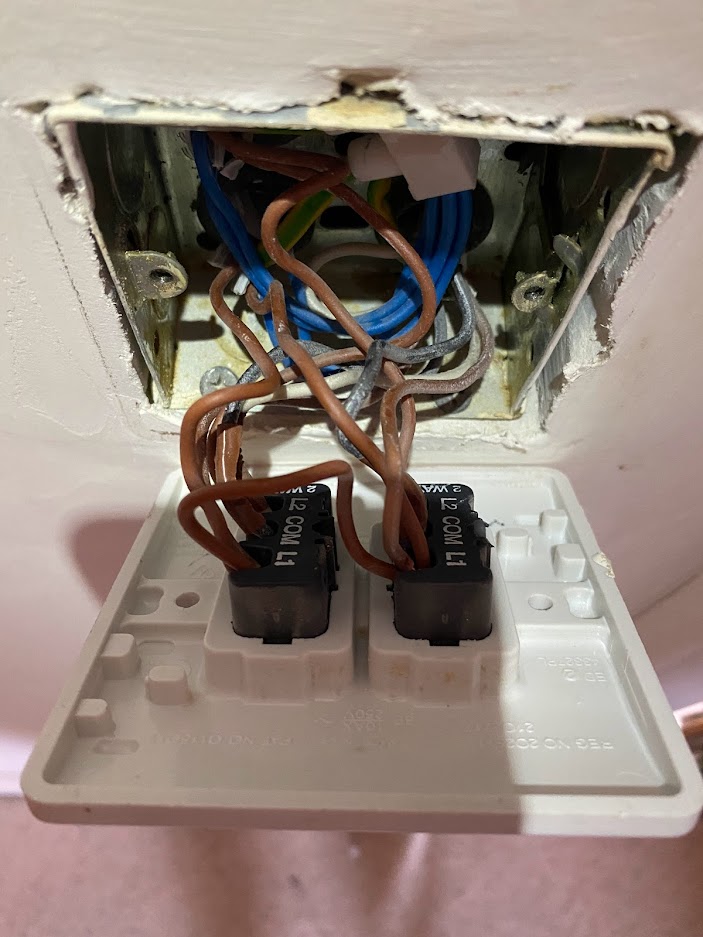

I have a 2 gang 2 way light switch with:
  • The left hand side part of a 2 way circuit with another switch
  • the right hand side a 1 way circuit (this the only switch) switching two lighting circuits in parallel (a bathroom light and mirror light)
What I didn't expect is for there to be a bridge between the L1 of each switch. Its like L1 is being used for the permanent live maybe?
What am I missing?
thanks
Brian

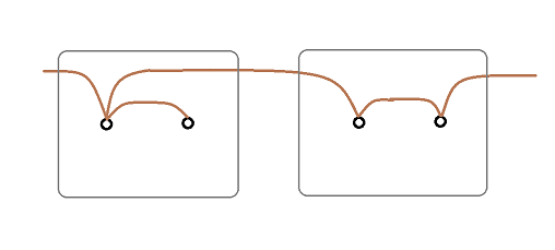

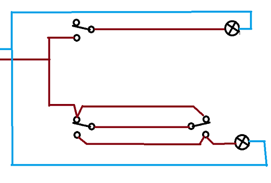

It's one way of wiring 2 way lighting circuits. If you sketch out the connections you'll see how it works (used to be some useful examples in the wiki but can't find them now)
@oldbutnotdead Im still confused if thats the case then, as I mentioned the switch on the right is NOT a 2 way switch (this is the only switch that turns the lights connected to it on), only the switch on the left is part of a two way (2 switches controlling the same circuit)?
Thanks @bernardgreen thats the diagram I'm expected so does that mean my assumption is correct and that in that photo the permanent live is actually wired into the L1 terminal on both switches? Its that point that is confusing me I think

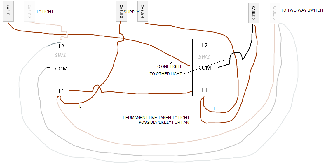

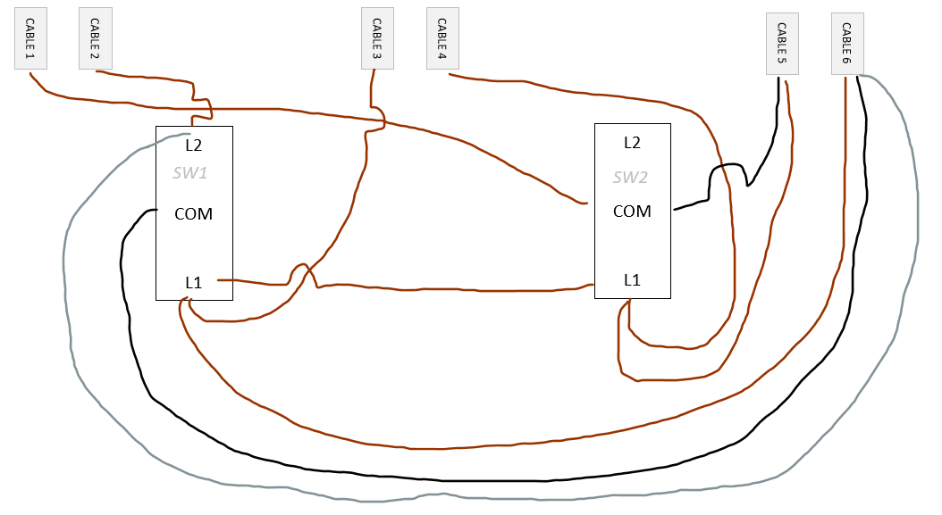

A photo is never going to make it clear so here is my attempt at sketching it, colours are to match my photo for my own sanity
Just a reminder Switch1 is the two way switch connect to a switch elsewhere, Switch2 is a single switch but controlling 2 lights
That's slightly unusual the way cable 5 is wired, is this for a bathroom with an automatic fan?
