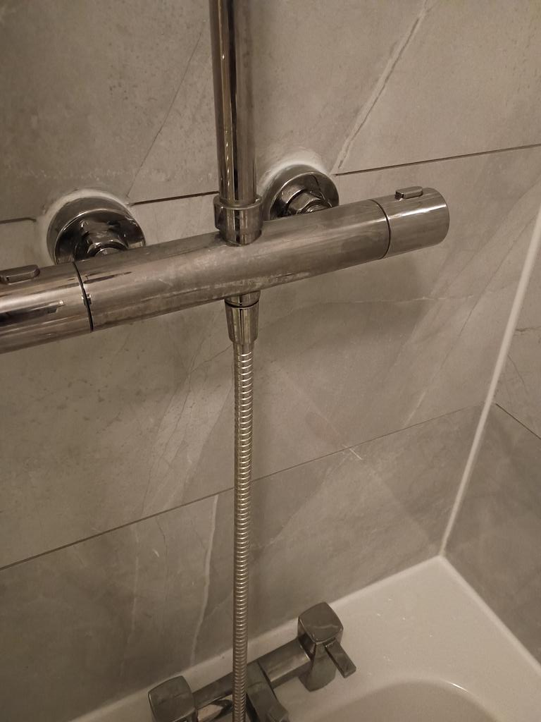

Had a new shower installed.
Wickes Alure Round Thermostatic Mixer Shower - item no. 299680.
There is no mixing: it's either cold or scolding hot!
When the shower is turned on in the neutral position, the water is cold.
Turning it away - it gets hot & stays hot even when turned towards as well!
Any ideas what the issue is?
Thanks,
Wezza
Thermostatic cartridge could have failed, debris in supply, unbalanced supplies to name some instances. Who fitted the shower? Maybe if not yourself, get them back to fix it or replace.
Thanks for the reply.
It was installed as part of a bathroom refit.
Typically, the guy's scarpered now.
Will investigate what you suggested.(y)
