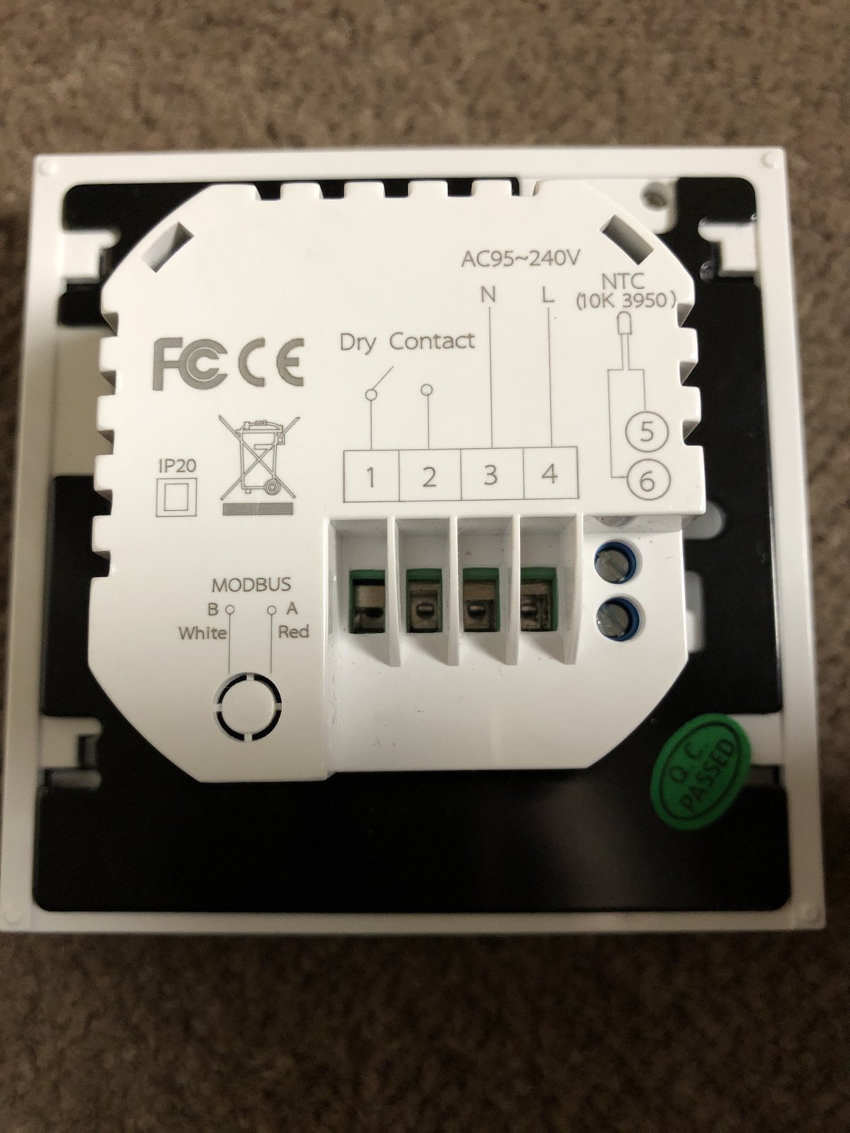

Hi there, I’m looking to replace my old analog thermostat with a new WiFi one I bought however I will need to do a little rewiring and some help would be very welcomed. I only have 2 wires for the old thermostat so I will need to relocate and rewire. Can anyone help as to what wires should go where.

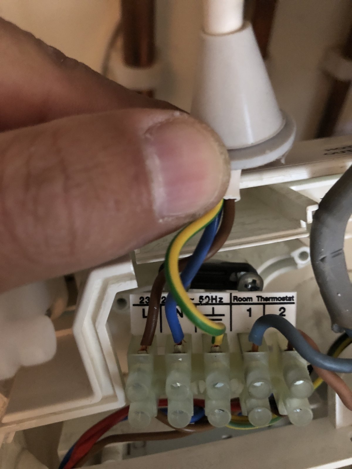

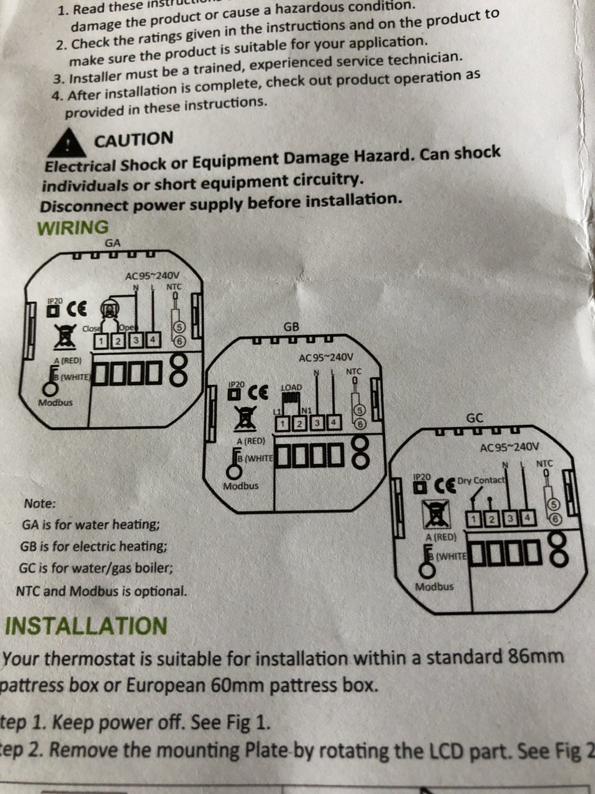

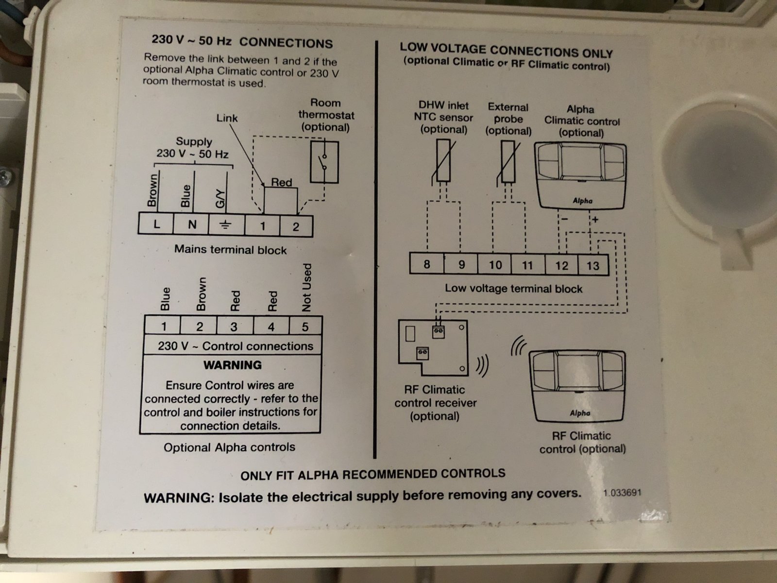

I did say I need to rewire. I have included pictures of the new thermostat wiring and the boilers wiring
The thermostat would appear to need a remote probe, as used for underfloor heating systems.
Are you sure it is suitable for your purposes, ie, does it have an internal room sense function?
Wiring is so simple, even my dog csn understand it. But here goes..
1 and 2 on the stat go to 1 and 2 on the boiler.
L and N go to `(guess where) yes to L and N on the boiler.
Dont forget that all cables must have an earth conductor.
Simples!
I was gonna try it that way but didn’t wanna just presume that would be ok. It says that it’s compatible. Thank you
Nevertheless, there has to be one in the cable connected at the boiler.
In any case there will be a green and yellow in the 4 core so use 5 core.
Thanks mate. Have done that for now and have ordered some 5 core off eBay. It’s working like a charm. Thanks to both of you
