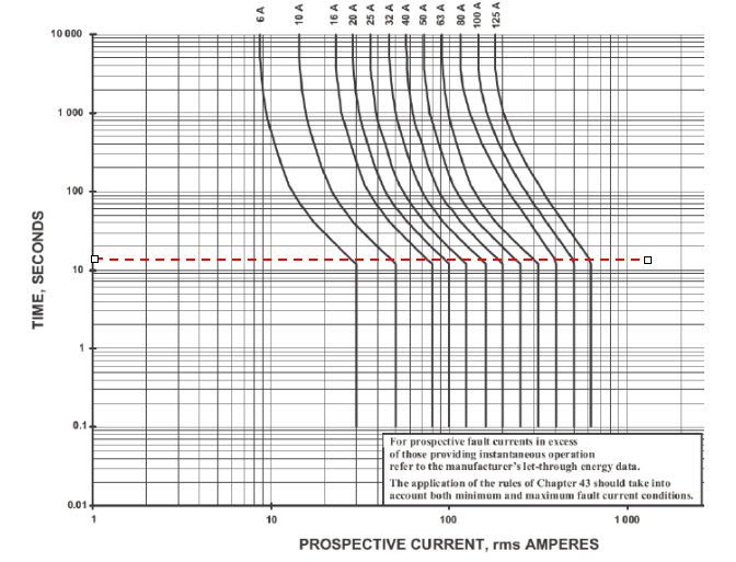

So a MCB is a duel device, both thermal and magnetic, the latter is much faster, but is set 5 x (B), 10 x (C) or 20 x (D) to the thermal device, so an immersion heater (3 kW) is likely supplied with a 16B MCB which will need 16 x 5 = 90 amps to trip, so 230/90 = 2.56 Ω with 5% for safety that's 2.44 Ω if using earth rods that would be hard to achieve to earth, so only option is a RCD. But still working with 2.44 Ω live to live or line to neutral.
In the days of fuses, if we got is slightly out, it was not so bad, it took a few mS longer to disconnect, but with a MCB the difference between magnetic disconnect time and thermal disconnect time is huge, so we need to use a loop impedance tester to ensure with a short circuit it will activate the magnetic part. But that's live to live, line to earth we can use the RCD so much less it required to trip it.
Again, I think this might all confuse people. For a start, your arithmetic, and basis of your calculations, could do with some improvement. Firstly, 16 x 5 is 80, not 90. Secondly, in calculating the maximum Zs which would be guaranteed to result in magnetic tripping (in the face of a zero impedance L-CPC fault) you should take Cmin (0.95, even though it should really be 0.94 :-) ) into account and calculate that figure using a voltage of 218.5 V (230 x 0.95), not 230 V. The correct calculations would therefore have led to a minimum current for guaranteed magnetic tripping (In x 5) of 80 A, hence a maximum Zs of 2.73 Ω (218.5 / 80).
Thirdly, and perhaps most importantly, although what you say about 'using earth rods' is correct, it would probably be desrable to point out that this is true of any circuit in a TT installation - so, adequate fault protection of every/any cuircuit in a TT installation would have to be provided by an RCD.
....But still working with 2.44 Ω live to live or line to neutral.
Even I am confused by that one, so good luck to those who know less than I do :-) What do you mean by "live to live" - do you mean "phase to phase" in a 3-phase installation, "Line/Phase to Neutral" or what? .. and what does the sentence as a whole mean?
In the days of fuses, if we got is slightly out, it was not so bad, it took a few mS longer to disconnect, but with a MCB the difference between magnetic disconnect time and thermal disconnect time is huge ....
I don't think that even "a few" (or even "a good few"!) seconds would make much difference (it's incredibly improbable that someone would be 'touching the wrong things' at the very moment an L-E fault arose), and currents approaching the magnetic trip threshold will thermally trip an MCB in well under 15 seconds (these curves being for B-curve MCBs) ...

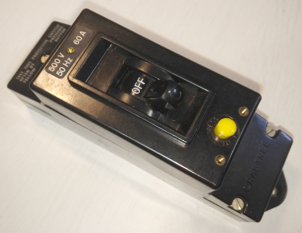

But I remember using the RCD tester and it failing to operate, but the test button worked OK, on invesigation found an ELCB-v ELCB-v.jpg still in circuit, before the RCD, can't off hand remember the resistance of the coil, but not that high, was supprised the RCD did not work.
