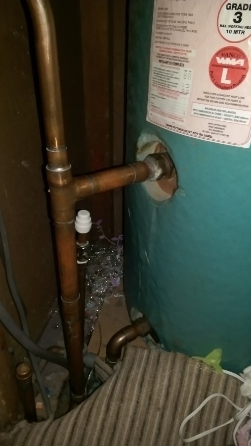

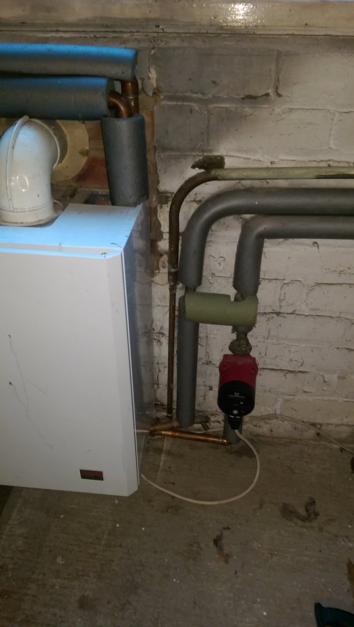

post some photos of the pipe layout round the boiler and the cylinder.
Looking at the photo of the cylinder, I guess another easy option once the X400 has had some time will be to drain the system and disconnect the top connection into the cylinder, and then just stick a hose into both sides of the connection in turn. At the very least it would identify if there was a proper blockage if it doesn't drain out the drain cock.
Is it me or has that upper nut been soldered?
Looks like silicone to me.
The coil will be blocked @ the top around the union , undo the union nut and clear the blockage.
Gravity hot water cylinders used an annulus as opposed to a coil.
If the pump is causing suction in the hw circuit, one way to dislodge things would be to close any isolator between the boiler and where it tees off between dhw and ch,turn off the boiler heat/electric, then run the pump on max (without the boiler) to circulate round the hw circuit. Then do your hammer tapping and cleaning out the filter etc.
Does it have a combined or separate feed/expansion pint on the hw pipework? If separate, The thing you have to watch is pulling in air through the expansion pipe or pumping over, you could always cap it *temporarily* while you're doing that pumping process.
However your cold water probably has more pressure and flow then your pump, so may be more effective if you can cobble that up.
