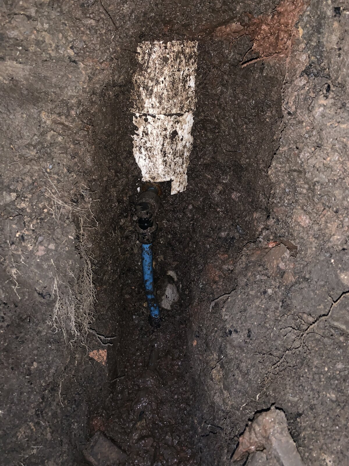

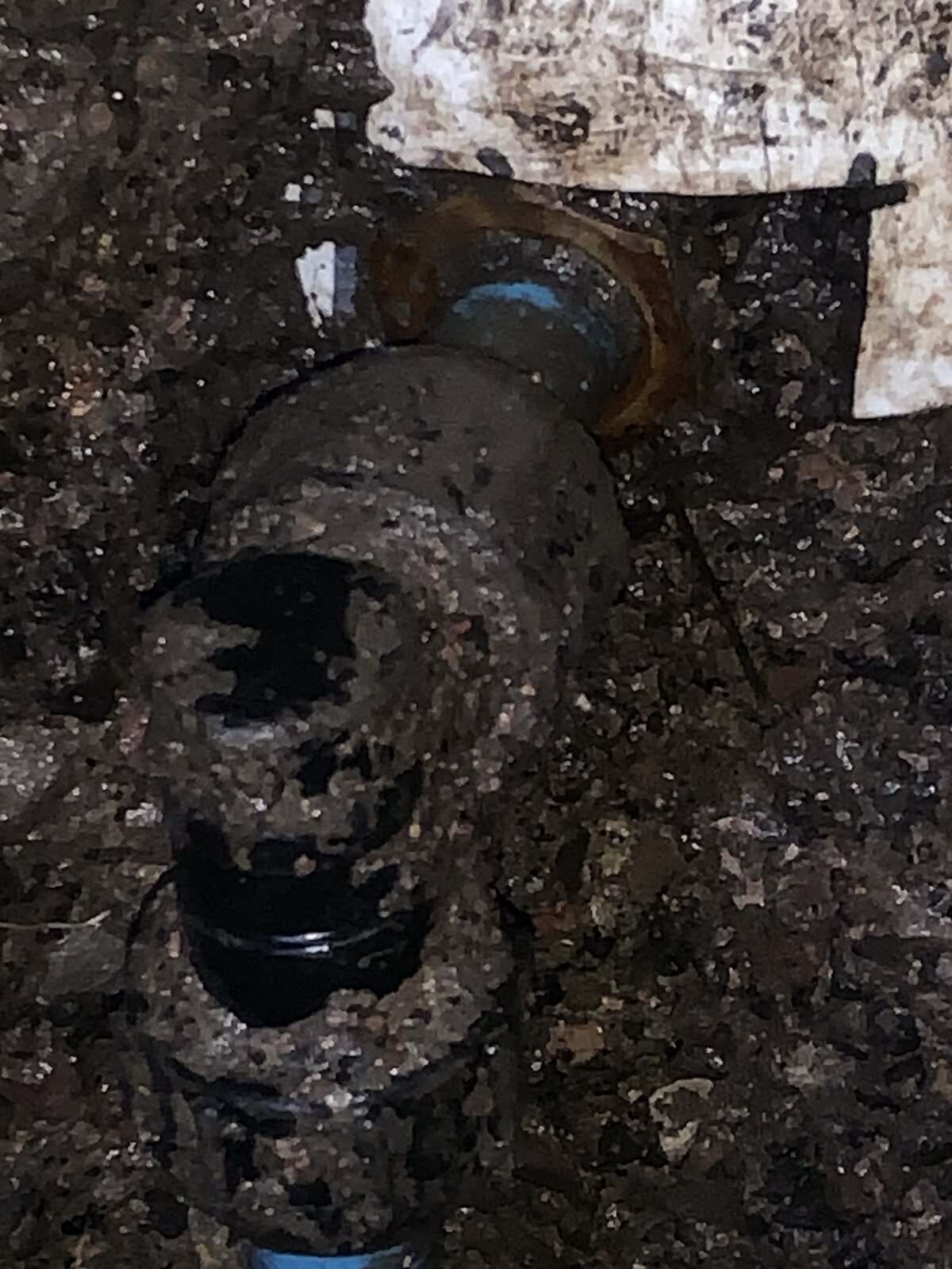

I am replacing a galv water pipe 40 meters up to the main in the road. 25mm egeplast barrier pipe laid and pulled into house, all done to regs I think, but to find something to connect to I started digging through the old stone wall by the road, and all the loose earth Severn Trent had filled their exploratory hole with my side of the meter just fell out. So now it looks like this with about 6 inches of grade in the top:
So I could maybe connect onto that short 25mm tail or I could put a longer piece of blue on the bottom elbow. My puzzle is that the water meter is about 12 inches out from the tarmac edging.
So if I connect onto the meter tail I will need to leave it for them to inspect. Are they going to get grumpy about me digging beyond my boundary? The road is a narrow country lane dead end so nothing goes through here faster than 15mph to the 5 houses after mine, and nothing drives between the meter and my boundary due to a nearby wall. There is tarmac between the wall and the edging but grassed over.
So do I go onto that little tail, which leaves one fitting underground instead of 3, and a better flow line?
Or do I replace the six inches of blue that went to the galv coupling from the bottom fitting, using a longer piece that comes to my side of the wall, put the wall back and fill in hole behind the wall, and just show them a coupling onto the MDPE on my side of the boundary? The pressure on the main is high, about 7 bar, and we are just two older folks in a bungalow, so the extra fittings probably don’t really matter flow wise. We were used to the 10 mm sq left in the middle of the 3/8 ! galv pipe anyway.
Any advice on Severn Trents flexibility appreciated. I don’t really want them to decide they want hundreds? of pounds off me just to satisfy themselves that the road edge is put back how they think it should be.

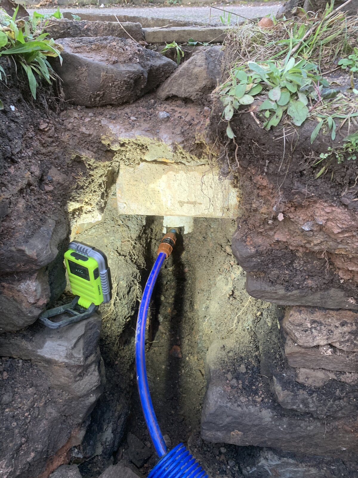

So it seems that Severn Trent are really not very interested in leak repair work that you do yourself. I guess it’s such a small number of people that they don’t have a process to notice that I have done an entire pipe replacement. I phoned to ask for an inspection and was told I don’t get one. Someone comes and checks that the meter is stationary, listens for any sounds of leak at the meter, and that’s it. My neighbour say a man turned up Friday, poked at the meter, peered over the fence at my trench and left. Is that it? Where is my day in court, well of inspection anyway, that I have been working towards for weeks? After all the fuss they make with any reconnections, you would have thought they would want to see that a pipe replacement was done right. Well that seems to settle the question of whether they will mind, they don’t know…. I decided anyway that I couldn’t bear to reuse two old elbows and leave them in the supply, and would live dangerously and see what happened ;) so I shored the verge up with a bit of scaff plank packed on top with base, and got a new Plasson barrier coupler onto the blue meter tail. Just waiting for a message from Severn Trent to tell what the outcome of the visit is Now.

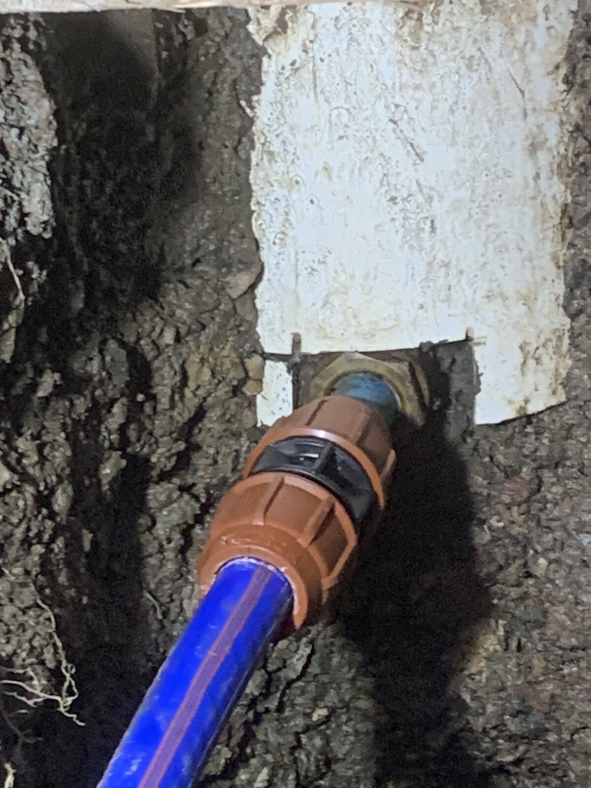

No I wasn’t in the trade. I’m an engineer who likes to do his own trades work when practical, and the internet is an amazing place for picking up info quickly now. Also I do have a 20mm MDPE irrigation system in my garden so I have met PE and PE fittings. I settled on barrier pipe both because the ground my side of that wall was built up with builders waste, plaster, smell of solvents, petrol smells that run in the stream at the edge of the tarmac, and also when I started looking at lifetime of PE I didnt like what I read about its limited tolerance of scratching. Since I have pulled under several terrace walls and around curves down my garden I didnt want to be worrying about scratching. Barrier pipe is genius because you have a tough outer layer not bonded to the internal PE, so you can scratch the outside up as much as you like without having any impact on lifetime. Also this means they can make the internal pipe out of good grade HDPE since you aren’t trying to sell a low cost pipe into the market. That all satisfies my engineers need for good spec materials. Barrier pipe needs special couplings so I read up about Plasson and Philmac. The barrier is Egeplast SLA and only the Plasson is listed as compatible, and the Egeplast guy I spoke to advised Plasson. The elbow couplings that came off the old connection were marked Philmac Polygrip, which looks identical to what is now sold as Protectaline barrier pipe fittings. Since they used that on the meter tail connection I concluded fitting barrier fitting onto 25mm blue works ok. The part of the Philmac that inserts into the pipe is a smidgin larger than the Plasson so decided to go with the Plasson coupling which I know to be right for the SLA. The only drawback here is that where I have put Plasson in where the Philmac was before its not very tight in the 25mm blue as the old insert was that bit bigger. But I figured the clamp ring will tighten down and ensure it grips anyway just as does on a flat insert with normal 25mm fittings. It’s not leaking so its good enough. In a perfect world it would be nice to put a new bit of blue in the meter tail, but I draw the line at tinkering with the meter push fit. If I hadn’t been able to get watertight on the coupling to the tail then I would have called in an authorised plumber.

So the answer is no they wont get grumpy! (At least in my case). As the leaks helpline told me when I phoned them saying I was finished the inspector only checks that the leak has been fixed and does not inspect the work done at all! I received a letter confirming that I don’t leak any more and the section 75 is cancelled. Silly that they left it open since I closed the stopcock 3 months ago and they came and checked I had.
Disappointed not to have someone give me marks for my install, but happy that there is no contention over the meter connection.
