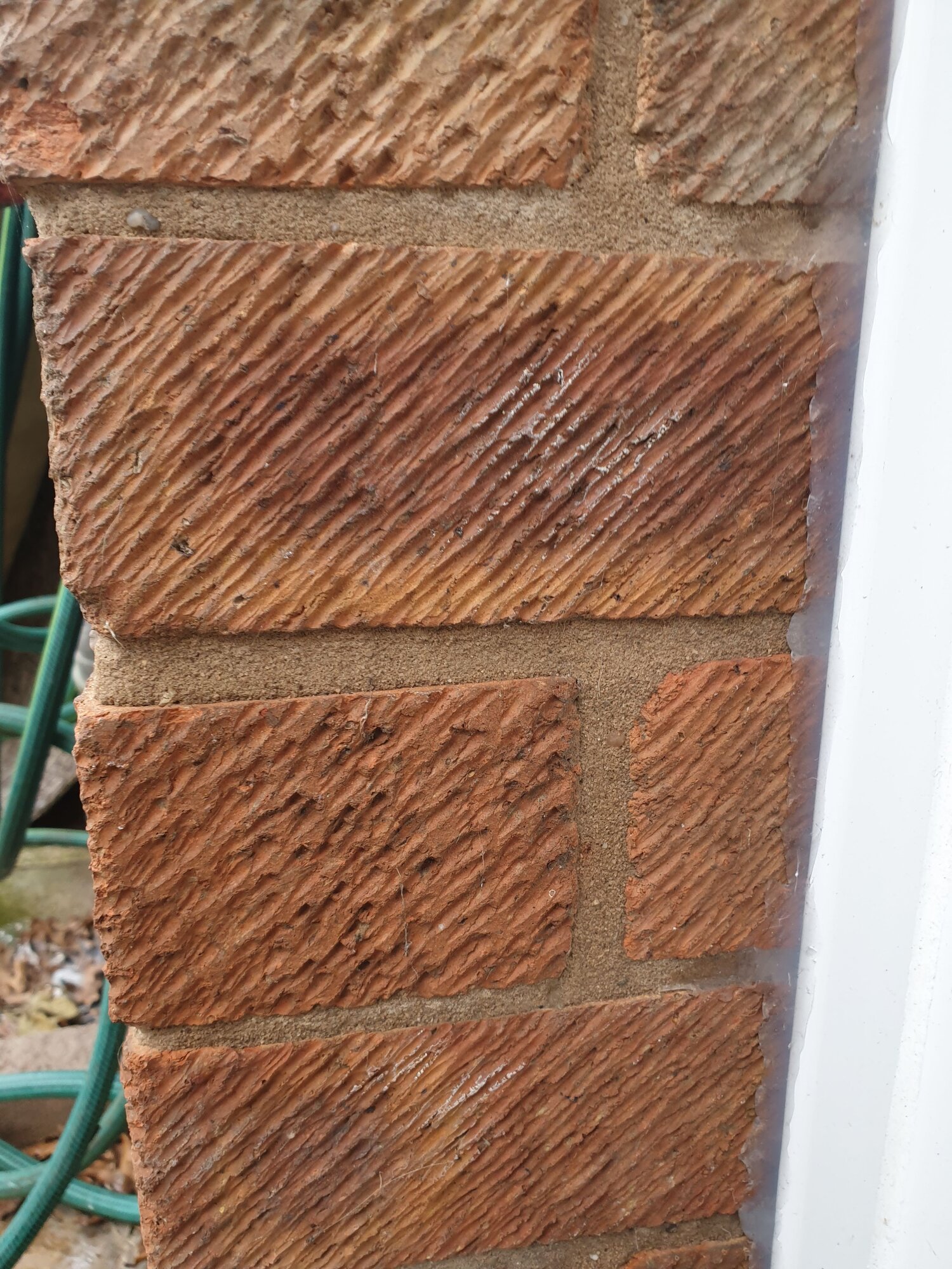

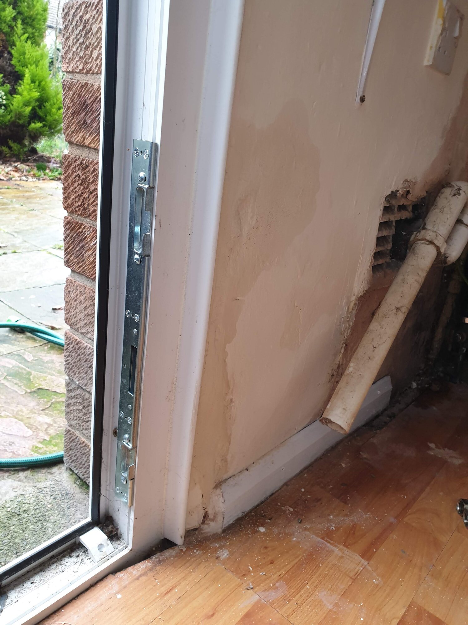

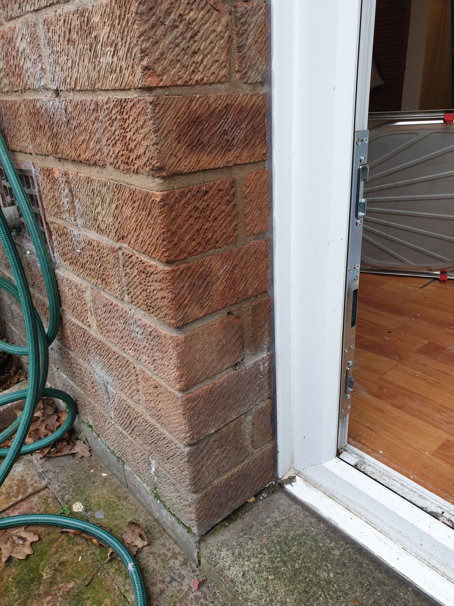

Will water sealant solve this damp issue?
Water sealant will make it worse trapping moisture in brickwork. Any pics of exterior showing above door , seal around door frame may be a weak point.
