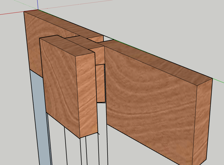

So I've had a bit of a play around with sketchup and come up with the below.
I'll use 3 x 10/20mm x 40/50mm packers to create an air gap behind a 20mm x 75mm overboard. The 75mm overboard will be drilled into the packer, the existing fence and then existing fence rails giving a ribbed effect but allowing airflow.
Has anyone seen anything like this? any thoughts.

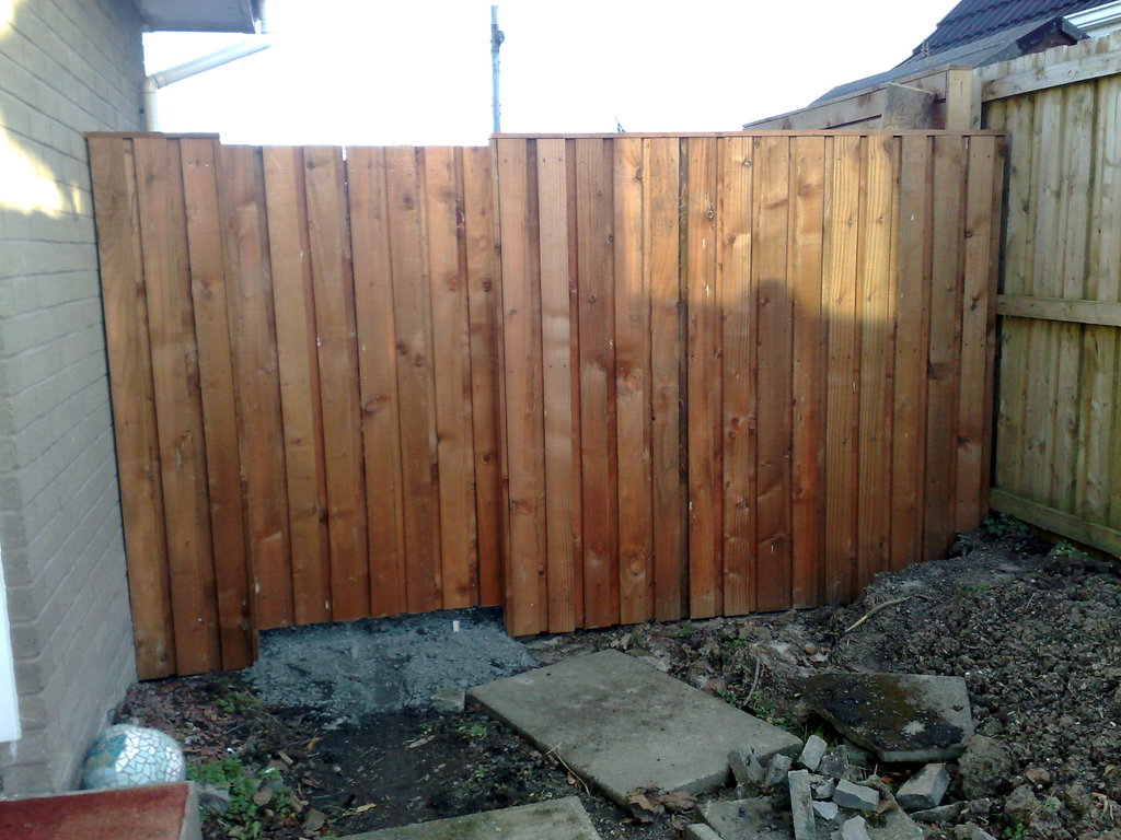

I found a photo online which gives an idea of the desired effect. The difference being the overboard will be raised 10/20mm off the original fence panel.

What you suggests looks good but I am not sure the gap is for the wind, fences are normally blown over when wooden posts rot, or panels are not fixed correctly. Back in the day when suburban back garden fences were 3 feet tall or less and neighbours talked to each other, there was ironically a greater sense of privacy than now!

Modern fences can be a blight on some gardens, restricting growth and casting far too much shade - i've seen gardens with about 15' width or less surrounded by 6' fences that practically block out the light, turning it into a prison yard.
A good way to ensure privacy without blocking a gap is with a climbing plant or a rambling rose.

It's a boundary fence. I've been involved with highly contentious party wall disputes through work and after the horrors I've seen I'd be very afraid of touching a boundary wall/ fence without OK ING it with the neighbour. Like I say we get on well so no issue. Though in this case there should be little concern.
I'll attempt a trial next week to see what it looks like.
I was fed up of my fences being blown down or partially down, by the wind and resolved this by screwing batons on the leeward side. It can't look great for my neighbours, but preferable to being constantly blown down. Wouldn't it be good if panel fencing could have some slats which are easy to take out, so you have the choice of taking them out permanently or just prior to a storm.
