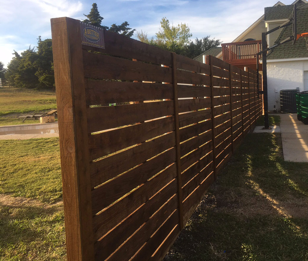

I want to board across 2 x 6ft fence panels, horizontally. Ideally covering the middle fence post to give horizontal boards 12ft long with small gaps in between. something like this (but with the old panel painted black behind it):
What wood should i use? going to need to be 4.2m long, ideally 6" wide (approx). I was thinking 12.5mm thick to give a bit of flex if needed? Will i need treated timber, even if I'm going to paint it with a fence paint anyway?
Any advice please guys, greatly appreciated

I was hoping for a smoother finish, something i can paint straight away. If I'm painting it with Cuprinol fence paint, will the wood need to be treated or tanalised, even if im giving it a couple of coats of waterproof paint?

Can I paint over a pressure treated board? Or would it be better (and last longer) to use a coloured stain?
Yes you can paint over pressure treated timber - make sure its dried. Sometimes pressure treated timber is still damp from the treatment when you buy it. I think a water based paint or stain is best.

Found some treated boards from buildbase 19mm x 150mm x 4.2m so will cover 2 panels in one run.
I’m after the red cedar colour treatment to stain them - any recommendation on the best brand to get?
Right, had a brainwave (I think) while sat in the garden. Instead of boarding over 2 x fence panels at a time, how would this look:
remove current panels and sell them (they are decorative fence panels)
paint concrete posts black
cut treated 6" x 2" timber to fit between the posts
Drop 11 x 6x2" timber between the posts horizontally
Stain timber with red cedar or similar
