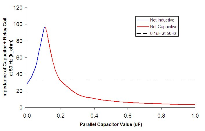

If I have done my sums right, this does not really explain how large a capacitor I had to use to stop my LED flashing ....
... in fact, as can be seen, the impedance of the relay coil itself (armature not closed) was very similar to that of the ‘standard’ 0.1μF ‘suppressor’ capacitor, so one might have expected the relay coil alone (with no ‘suppressor capacitor) to have suppressed the flashing (although it didn’t).
As shown in the above (and as expected), when one adds a parallel capacitor and starts increasing its value, the (initially primarily inductive) overall impedance (of relay+capacitor) first increases but once one has got to a value which ‘balances’ the inductive reactance, the overall impedance then progressively falls.
However, the above graph (if I’ve got it right) suggests that the overall impedance falls to the same level as that provided by a 0.1 μF capacitor alone when the capacitor value is about 0.2 μF. If, in the absence of an inductive component, a 0.1 μF capacitor usually suppresses the problem then one therefore might expect that a 0.2 μF one in parallel with my relay coil would also do the job - but, as I said before, it didn’t, and I had to go all the way up to 1 μF to stop the flashing (0.68 μF was not enough).
I am confident about my measurements, so the first thing I’ll do is recheck my calculations but, in the meantime, would be interested to hear any comments.
