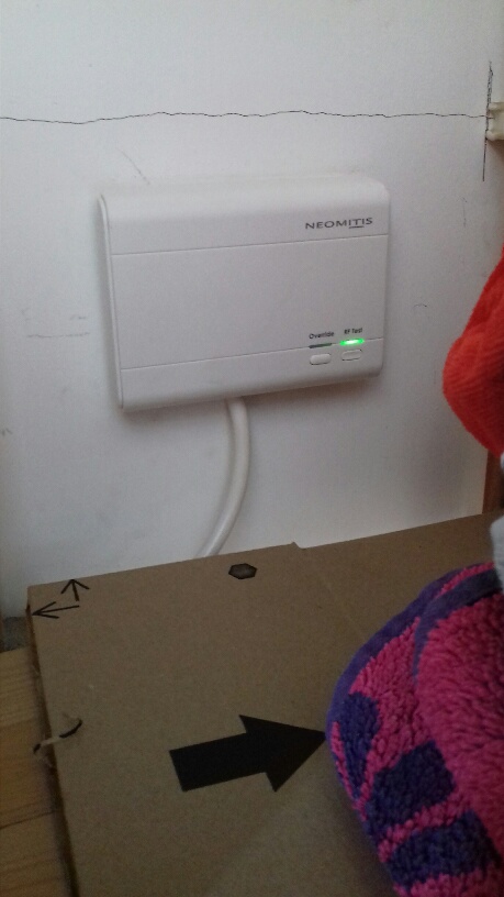

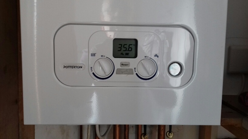

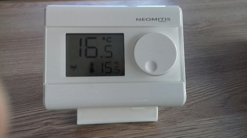

Hi All,
My daughter has a combi controlled by a Neomitis wireless thermostat (temp control only) and needs to change the thermostat to a day programmable thermostat. I am looking to purchase a Neomitis thermostat, but can it pair with the existing base receiver? Or do I need to change that as well?
Pse see pics

It seems like you may be able to. Reading the instructions they’re not paired at the factory, and shows how to pair the two products. Maybe check with neomitis to be 100%.
