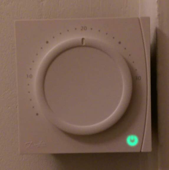

OK, bit of progress here. Think it was a different thread I explained this in, but here in N Ireland they have a scheme called Affordable Warmth for people on low income, whereby the Housing Executive pay for some improvements – so I’ve just had a foot of insulation in my attic, complete replacement of the old heating controls etc with modern dual type, 16 TRVs, 3 rads etc, all for free {embarrassed smiley}

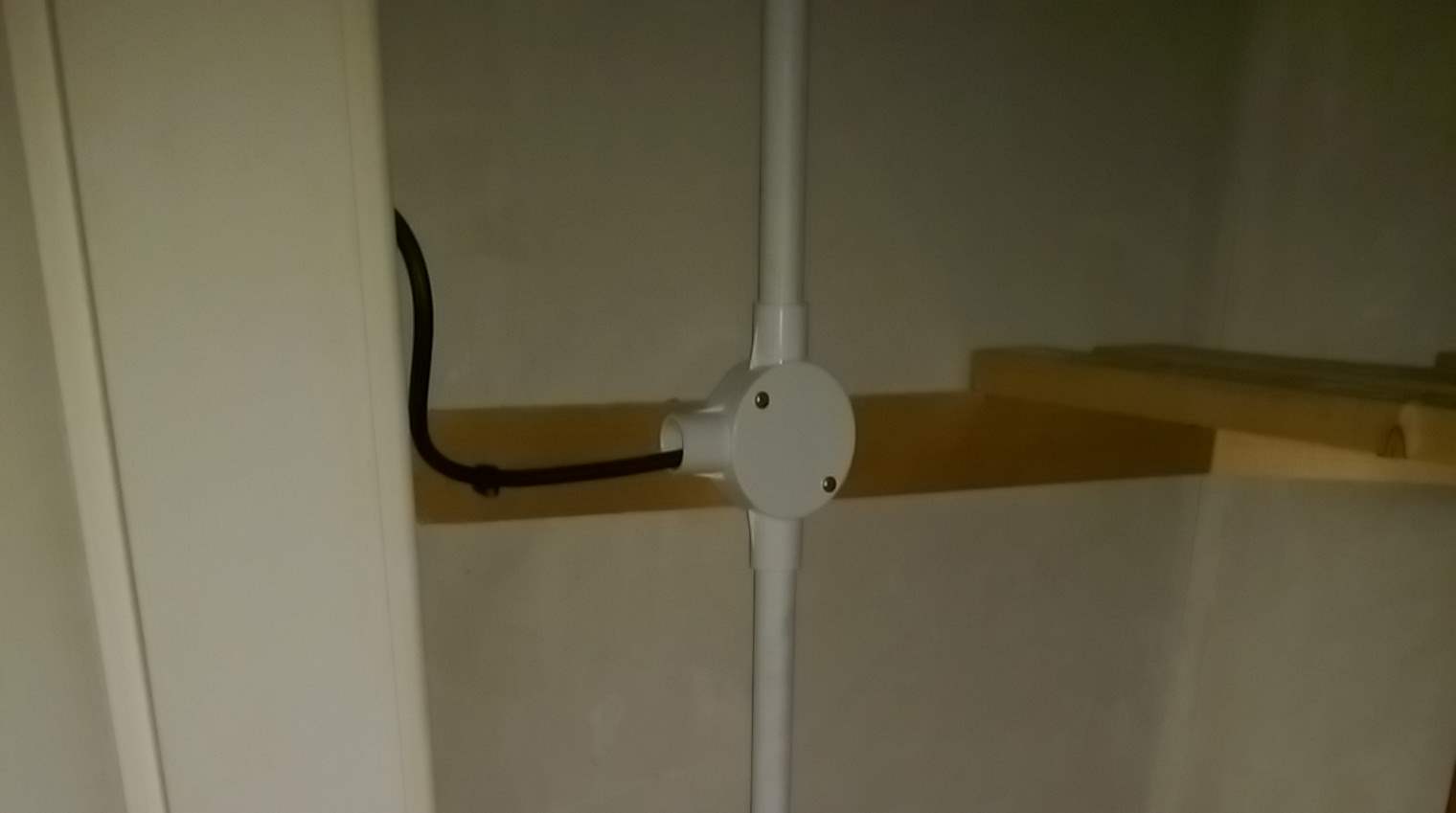

Anyway, the down side is they have to do it their way – and wireless ain’t included. So now I have a wall stat in my hall, where I didn’t want it, but at least it hasn’t damaged the wall (wire goes through diagonally to the airing cupboard, then up into the attic).
So once they’ve inspected and paid etc, I want to install a wireless unit here in the living room. One question… is the new stat they’ve fitted a simple switch that makes and breaks a single circuit? And would the receiver for the wireless kit be the same… in other words, a straight swap?
Thanks :mrgreen:
Maybe; post a photo or tell us the model number to be sure.
Thanks... can you suggest a (not too pricy) one please?
Reading reviews online, I get a bit confused... the ones mentioned seem to combine the thermostat functionality with that of the timer, and I don't want that - ie, I don't want this thing to be able to switch the heat on when it's programmed to be off, eg in the middle of the night...
